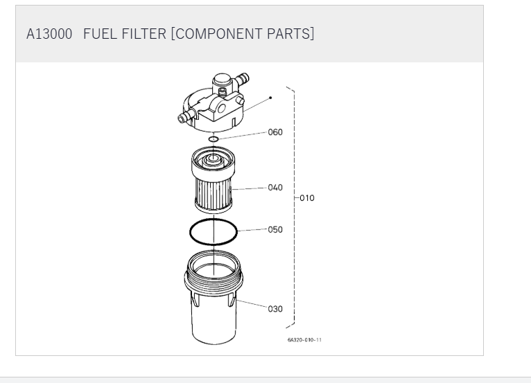

Pull the bowl off the filter, is it full of fuel?
If not then pull the input line off the filter housing, is there fuel coming out?
If there is fuel does there appear to be any water or ice in the bowl or filter?
If yes remove the filter and replace and put the bowl back on wait a min or so and pull the bowl back off Is there fuel?
If yes move on if no then go back up and read remove the line going into the filter housing.
So if you have fuel in the bowl and the bowl is nowe back on, move on down.

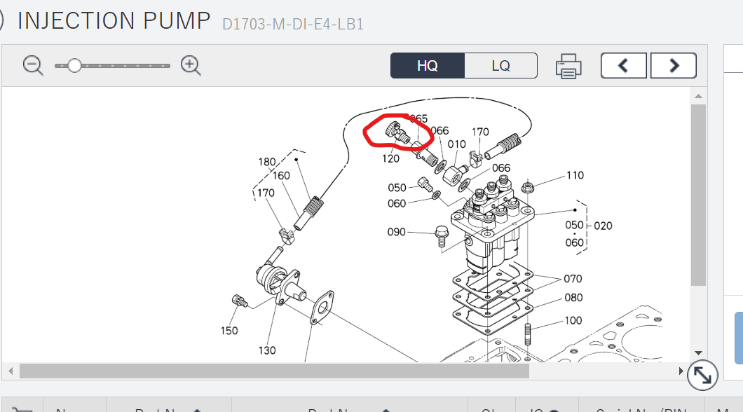

Go to the side of the injection pump and locate the jet start valve (red below)
Remove the small hose coming off of the valve, turn the valve to open it CCW, crank the tractor.
Are you getting fuel out of the valve?
If you are then close the valve and put the hose back on.
