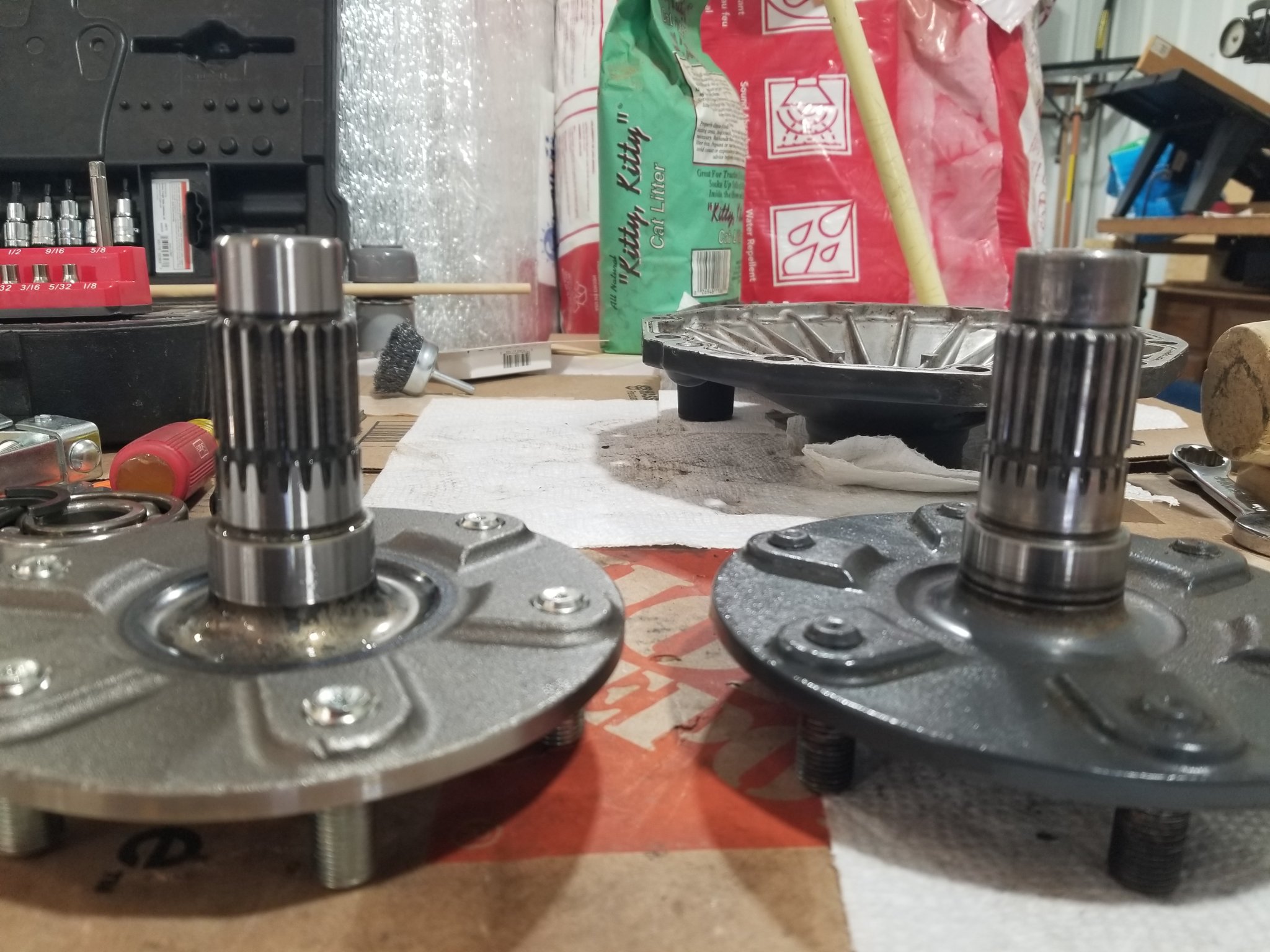

Parts came in last week but with company for a few days, I am just now getting back to this. I have included an image of the old and new axle for comparison. My question here is since the new axle isn't painted like the old one, should I paint the flat area where the studs are installed? Thanks again for the guidance here folks!

Yes, I'd paint it. Degrease it real good, cover the shiny shaft area, spray some primer, then x2 - x3 light colour coats. Be sure paint is dry, leave in sunny spot for at least a day.
Wondering why you didn't enlist the free help ( 'company' ) It was my sister. That wouldn't have worked out very well. Lol. Thanks for the reply. I will make a run down the mountain to get some supplies.
