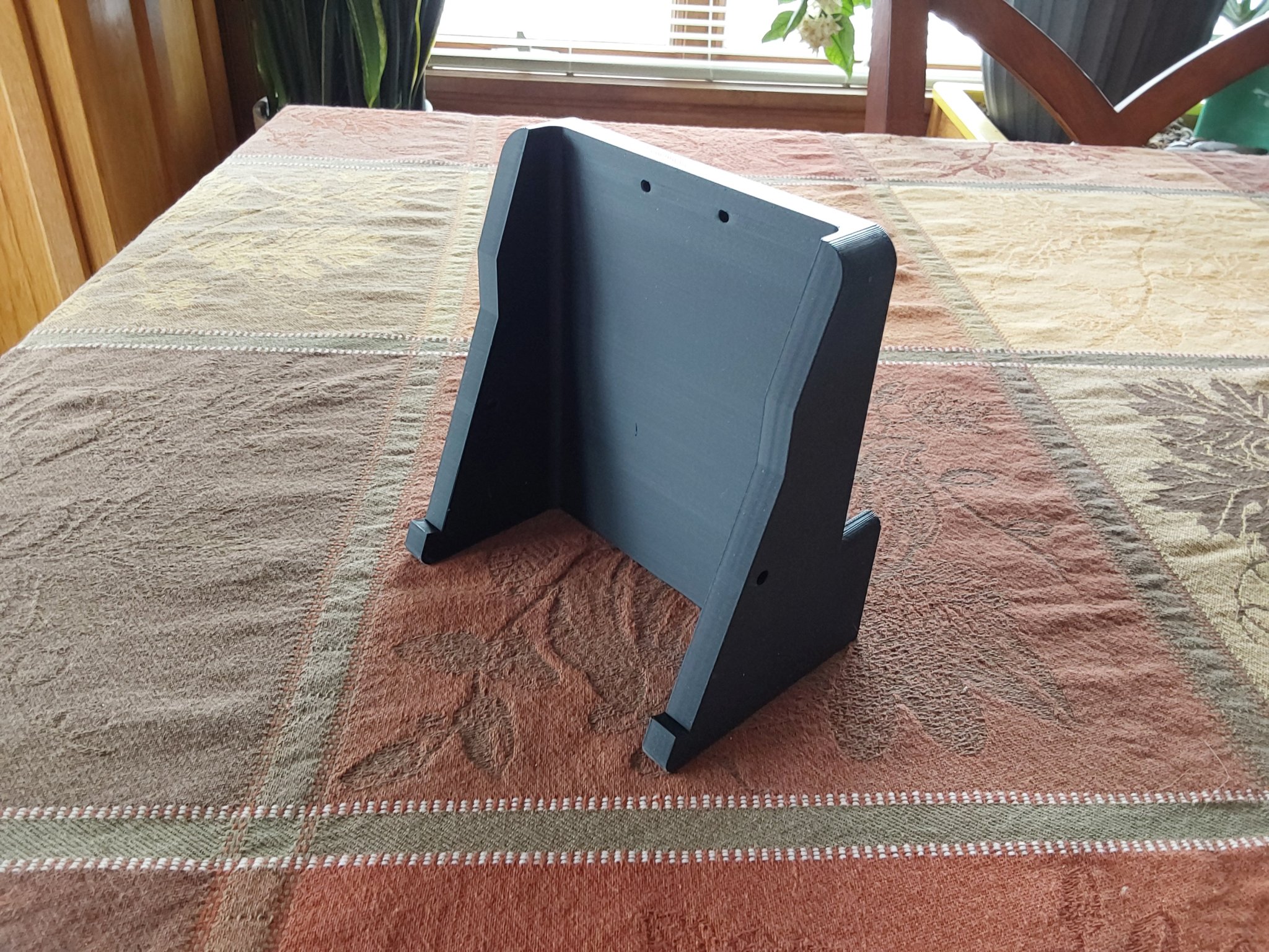

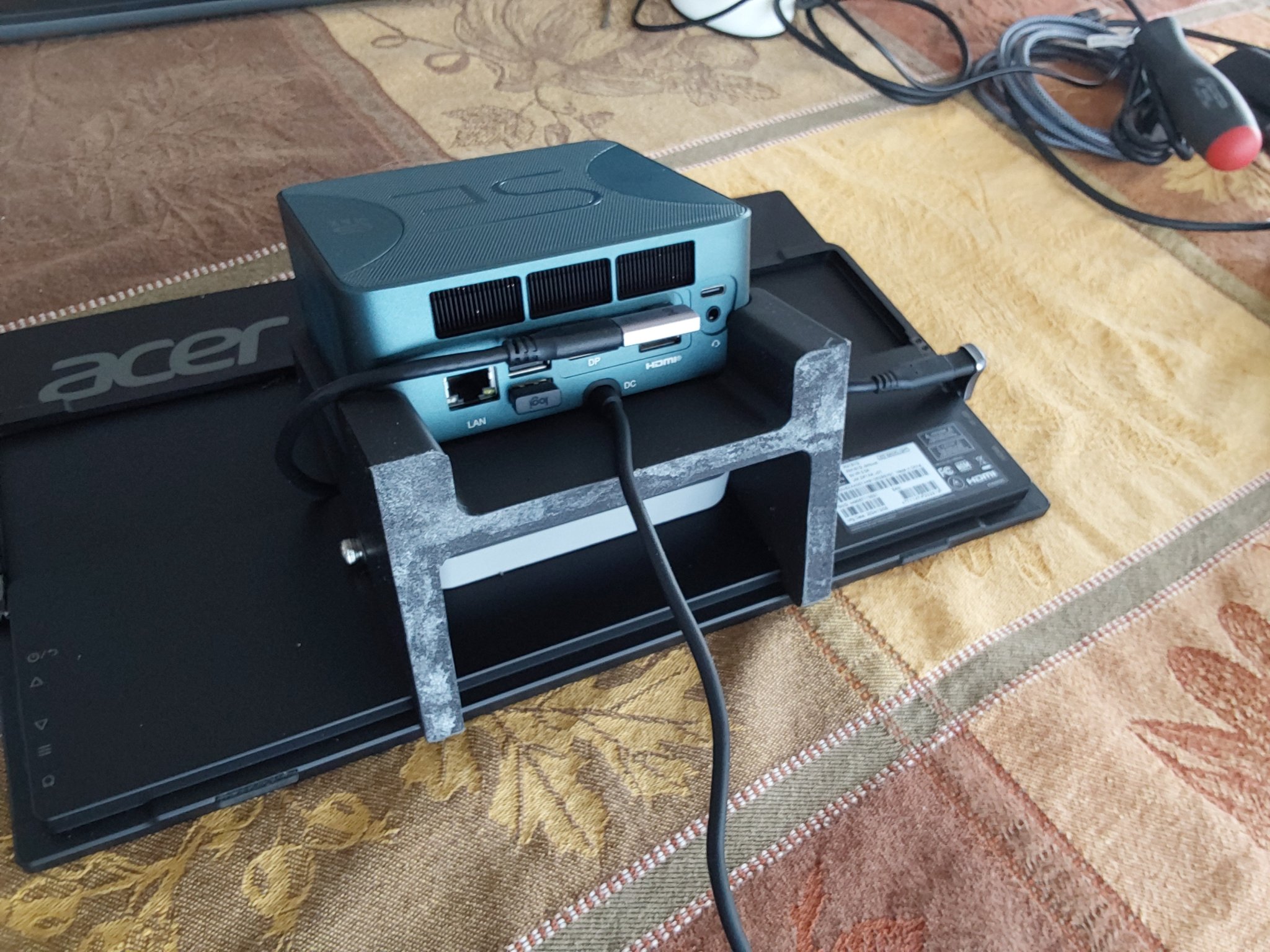

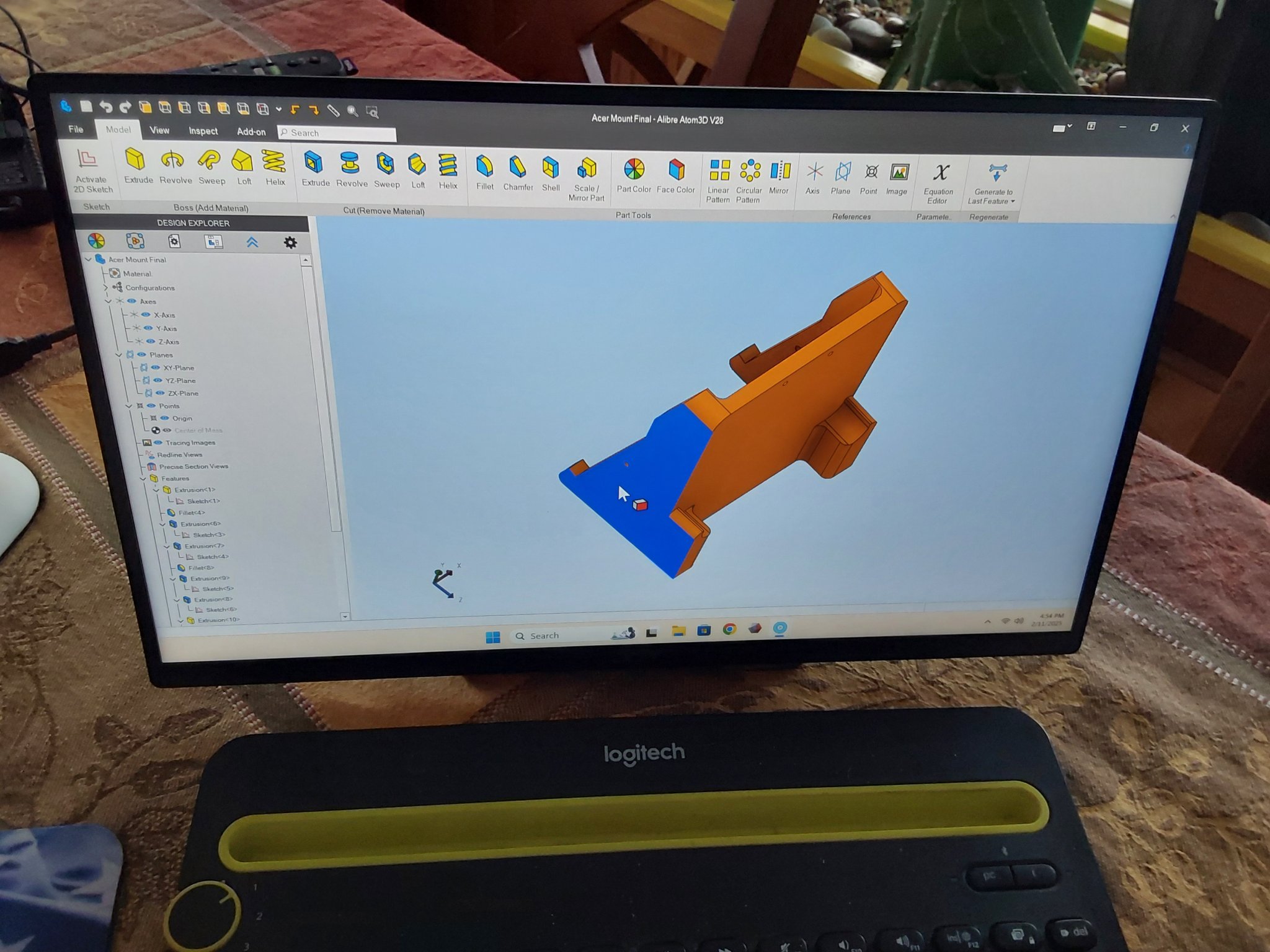

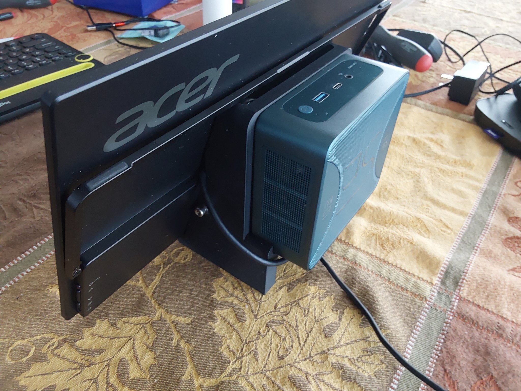

I bought one of the Beelink mini computers with a ryzen 7 chip, 32g ram and 1 t ssd for $300 and a small monitor for running Alibre and it's fast. 3d printed a mount to make a tiny pc that can also plug into my big monitor.

I draw them in Alibre ( A CAD program I bought), then I hit "save as",
Then I go back in the menu and there is an option to "export as STL".
I hit that, then I get the "STL. file.
After that, I dump the STL file into my "Orca slicer" (a free program) and it produces a "G- Code file" that the printer can read, (I guess?) Then it will print.
{If I sound like I know what I am talking about???...... I don't really.....I have only been stumbling/bumbling along, and doing this computer stuff for a few months}

Yea, thats a nice little set up for sure.
I wish I did not need the "portability" because those laptops are expensive, but "It is, what it is".

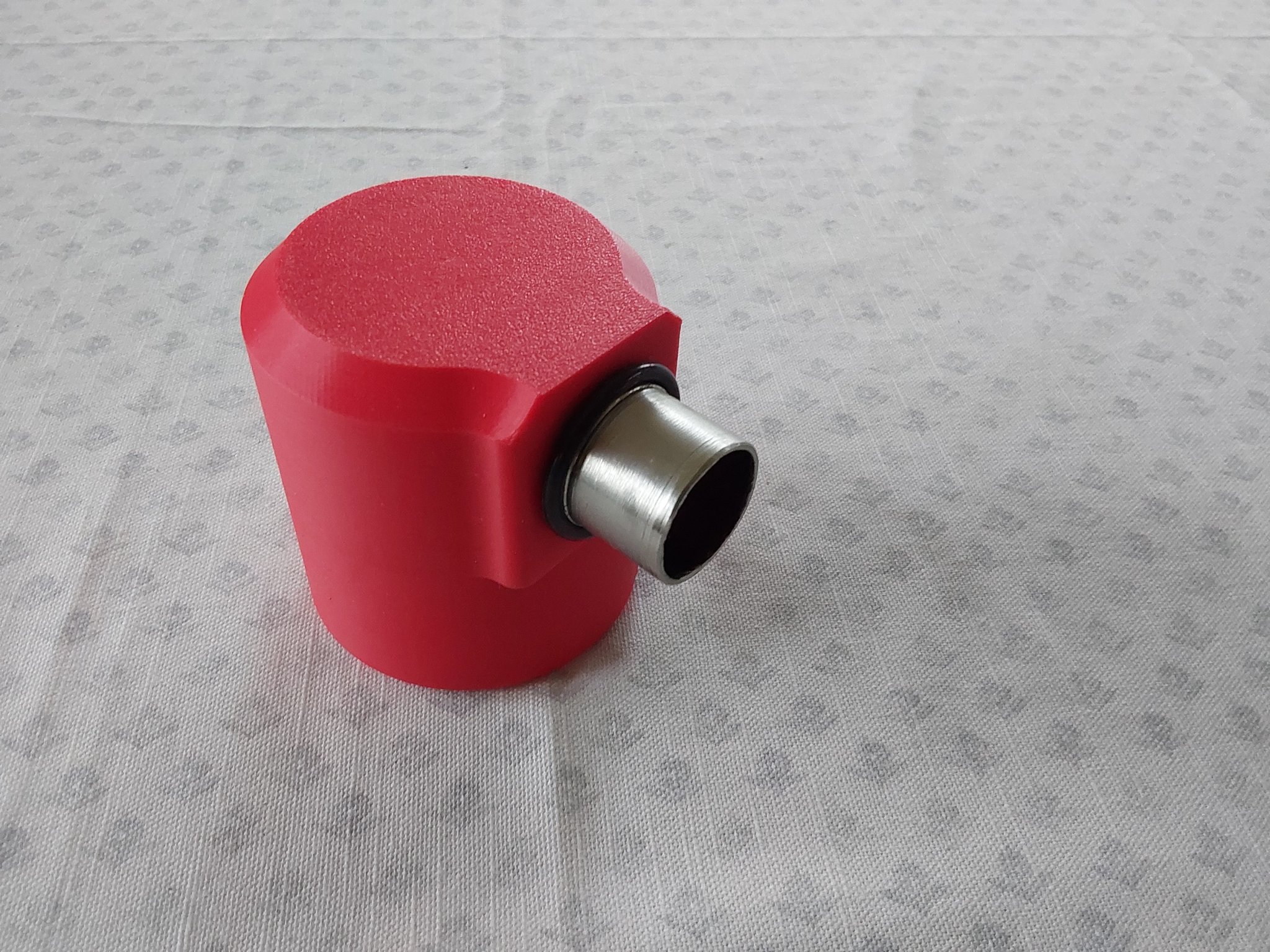

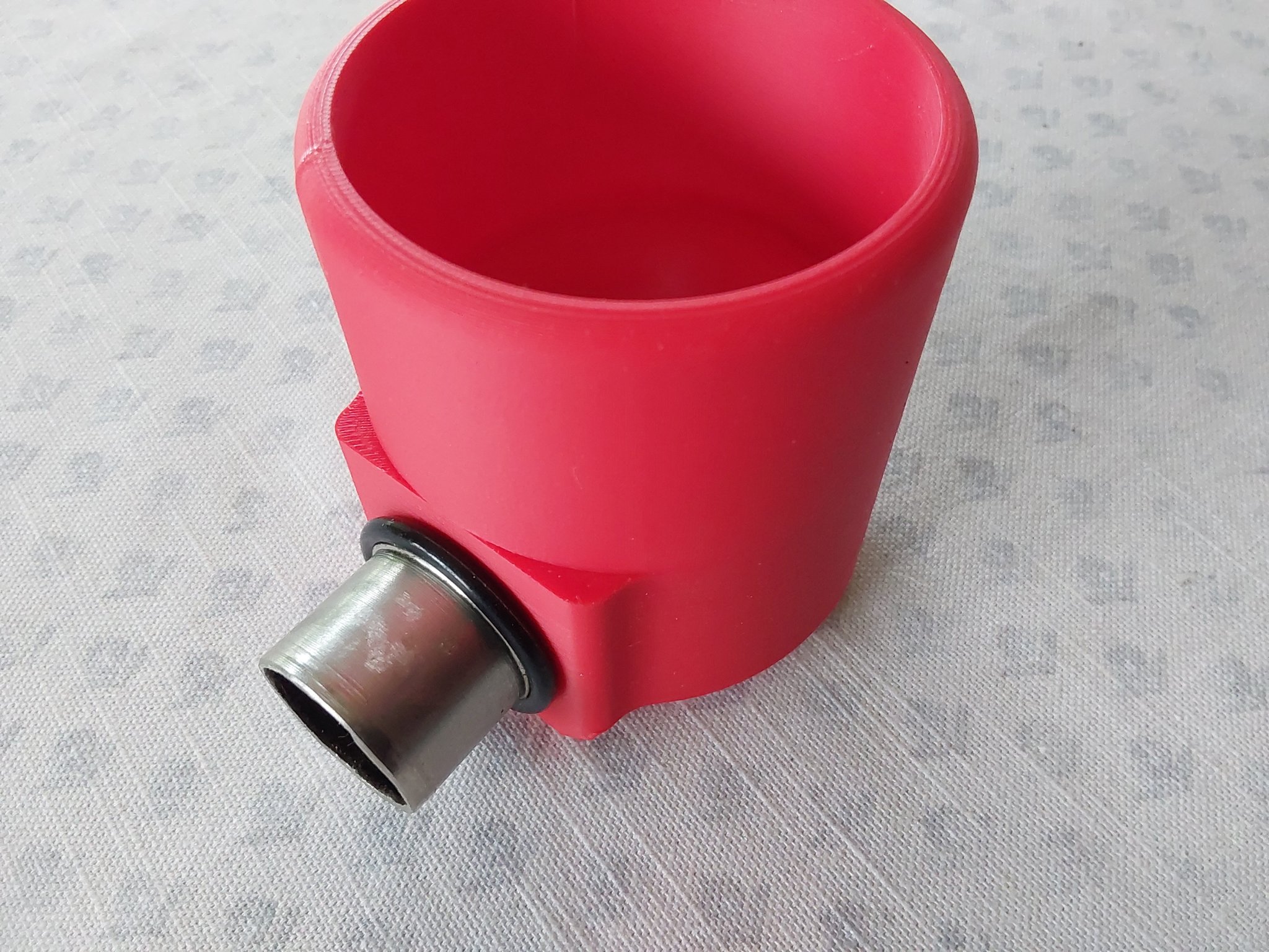

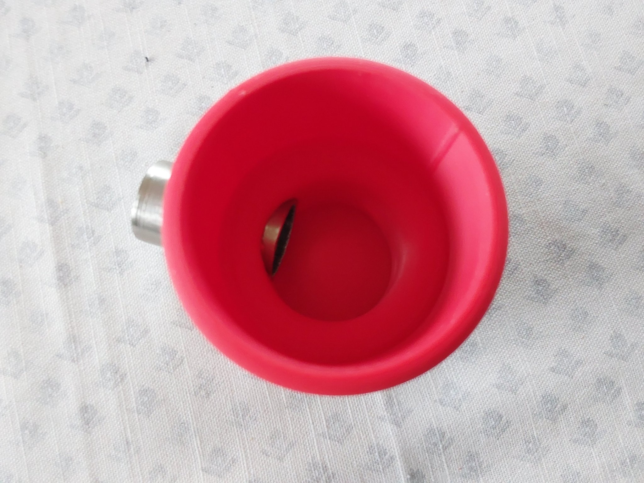

Needed to pull vacuum on my hydro assembly to change the filters without a lot of fluid loss for the 50 hour service. Designed 3d printed a shop vac adapter then turned a sub of 1 inch tubing to 25mm in the insertion ares for a perfect fit in my tractor fill boss that pressed in the plastic cap. So easy to solve problems with a 3d printer.

Thats very cool and a great idea.
