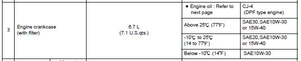

Standard engine oil specifications from Kubota are:
Note this is not from a B7500 manual so quantity is not correct.
