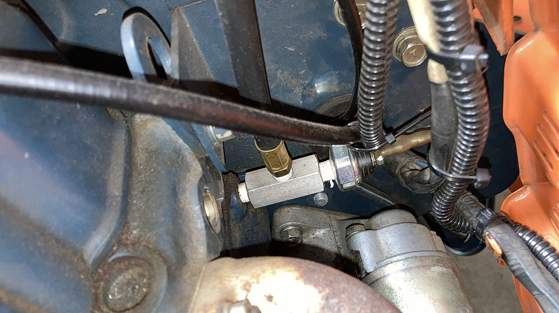

The T-Tap out of the block works well. I've been running this setup for a while now and it's been good. The tap and hose are all bspt threads. You just need a bspt to npt coupler to mount to the autometer sending unit and you're good to go, or a hose that has the different fittings at the ends...

Whenever able, use the smallest hose/pipe possible to reduce the amount of oil lost in a sudden failure. A large hose (like a 1/4” or so that appears to be in that pic) is unnecessary and a bit scary to me. (A restrictor orifice at the engine block would perform the job as well.)

That’s a grease gun hose rated for about 10 times the pressure it sees. There is absolutely nothing to worry about.
