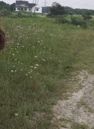

New l2501 with 5hrs on the engine. I have used the tractor mostly for disking and running a flail mower. After a short flail session yesterday, I parked the tractor and heard leaking noises, I jumped off and looked under the tractor and sure enough there was oil leaking onto the ground. I hadn't noticed any changes with the tractor's operation.
I called the dealership and they offered to replace parts and inspect the tractor, splitting half the cost. Now I'm wondering how this could have happened. I may have hit something, but the land is mostly dirt with some small rocks and then overgrown pasture which I've been clearing, could a rock knock this loose?
Today I used my metal detector to try to locate the bolt but didn't have any luck, I did however find where the oil blow-out started. In my estimation it ran either 100 or 200 meters (depending on what pass I was on) before shutting it down.

Asking for (and receiving it is doubtful) but I wouldn’t want the tractor disassembled by the locals over this. With the indications of oil still pouring/dribbling out that missing drain plug… and no low-oil-pressure indicatgion…. it’s most likely Zero damage has occurred. It was discovered in the “nick of time”.
Put a new plug in…torque it using a copper washer…put in the proper oil…and get on down the road.

Your picture shows a decent amount of oil draining from the plug. You can see the oil trail in the field.
Since you caught it quickly, I think you're fine.
