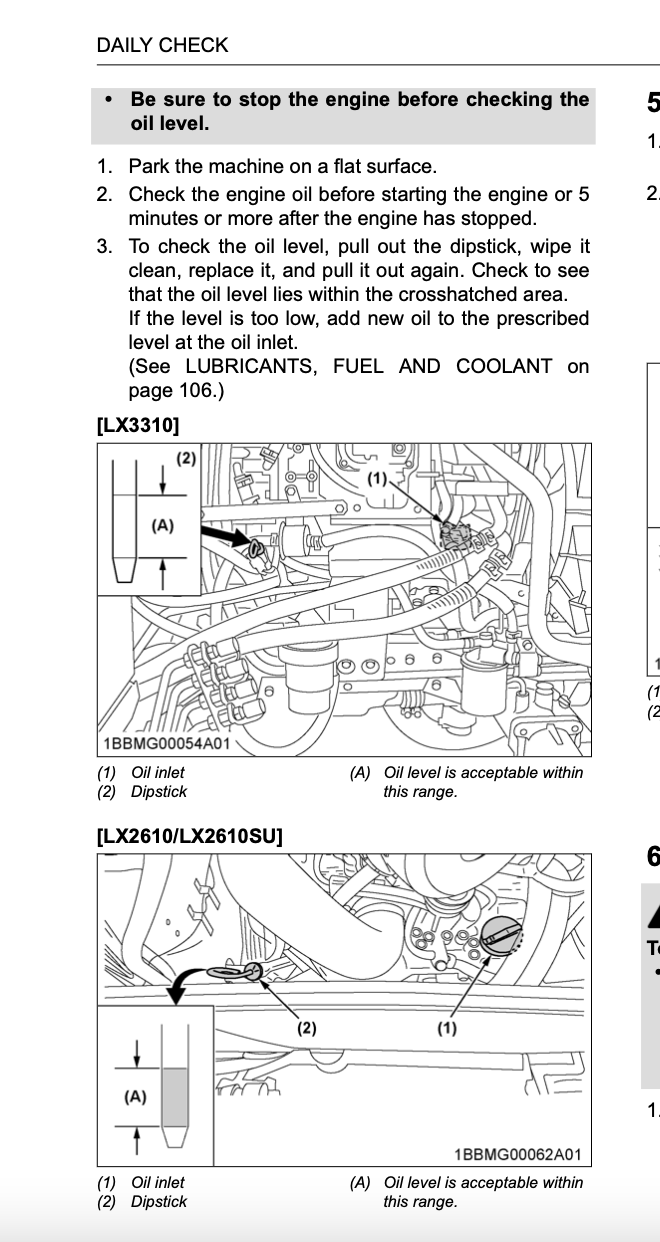

Have a LX 2610 Dipstick has 2 holes in it like many cars and trucks. Does not have the rough hash marks like it shows in the owners manual. Oil is up right above the first hole. Many vehicles like Ford v-8's say the oil must be above the 2'd hole. Do you think it is low oil in my tractor?

The oil range is any where between the two holes on the dipstick as long as its above the lowest hole on the dipstick you're good.
From what you describe your oil level is above the lowest hole on the dip stick so its good but if it was my tractor i would want the oil level at neer or at the top hole.

Thanks, that is what I was thinking.
