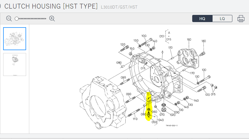

then before you run it the next time, look under the center middle of the tractor inline with clutch pedal, there will be a plug with a pin sticking out of it, push that pin up did fluid come out?
If it did, then your looking at having a front propeller shaft seal issue.
let us know.
let us know.

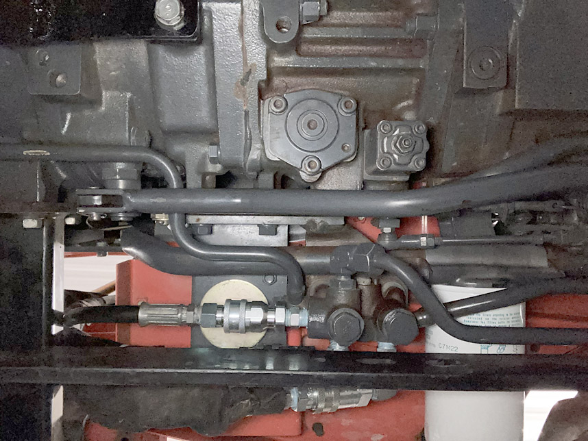

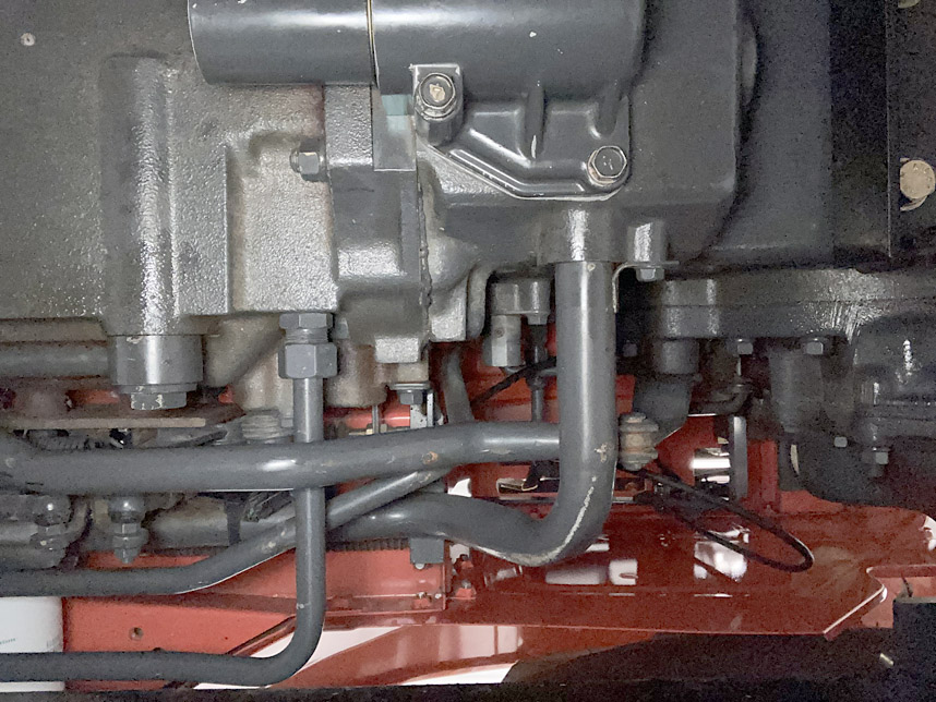

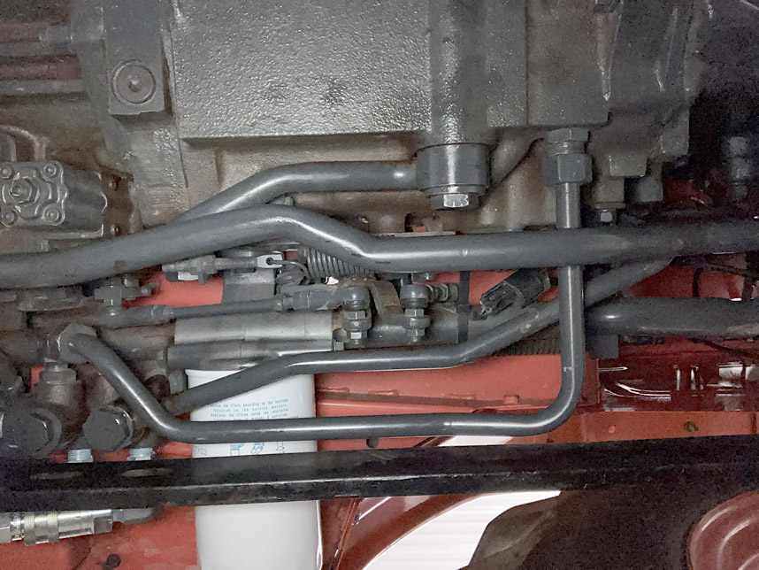

It is a very busy area in terms of hydraullic function. Snapped three pics of the underside of mine in the area you speak of. Let us know where you find the leak and we can better help ya out.
Will do, thank you so much!
More investigating tonight or tomorrow for sure!
