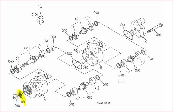

HI all, i seem to be losing hydraulic oil and gaining engin oil in my l4310 hstc. What would be causing this? Any help would be very much appreciated.

You've struck oil!!!:D
Oh wait, you've blown a hydraulic pump seal.:eek:
33,463
8,743
Sorry slow on posting, super easy repair, 2 bolts a couple fittings, pull pump, remove one clip and seal and reverse.
Now why did it blow the seal, betting stiff cold fluid.
What fluid are you currently using in the tractor, if it's cold SUDT 2 is the way to go, yes it's pricey but it flows good at low temps.;)
P/N 31381-76390

Thanks wolfman, i'll go look at my tractor tomorrow in the daylight. Is this pump about the same size as the injector pump? Also when i install the pump is there anything i have to do like prime it or just hook up and good to go?
33,463
8,743
Larger than the injection pump.
Yep just install and go, self priming.

Nope no need to drain, the pump is above the sump (reservoir) so you should only have minor loss from the pump and lines. ;)

Excellent, Having the WSM on hand makes working with anything on the tractor a lot easier! ;)
