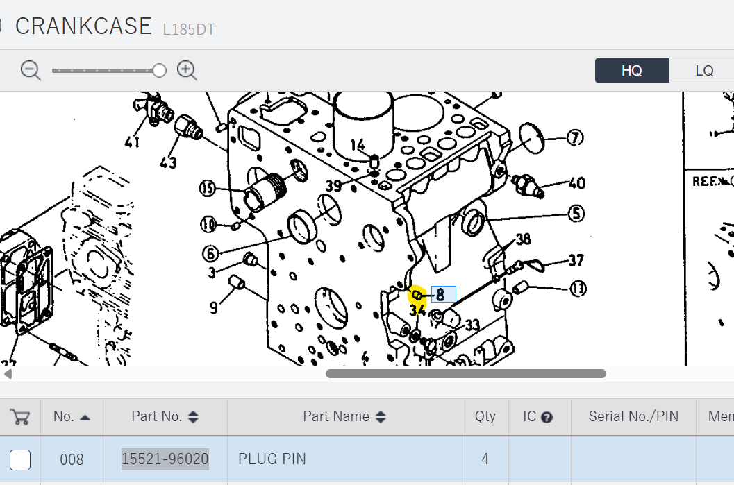

Most likely pin plug, easy fix, just put a new plug in the hole.
Pictures of leak will verify, as there are other plugs in that area too that could leak.
15521-96020

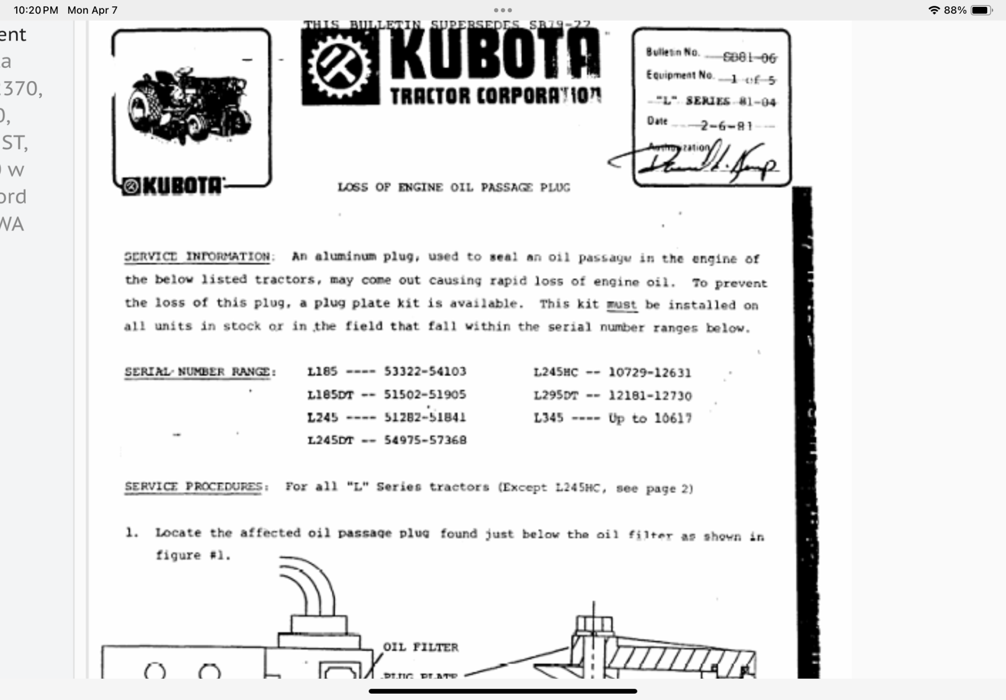

Here is a document that covers the long gone dealer repair. Sorry I don’t have the complete document but I think it was on here and posted by @whitetiger

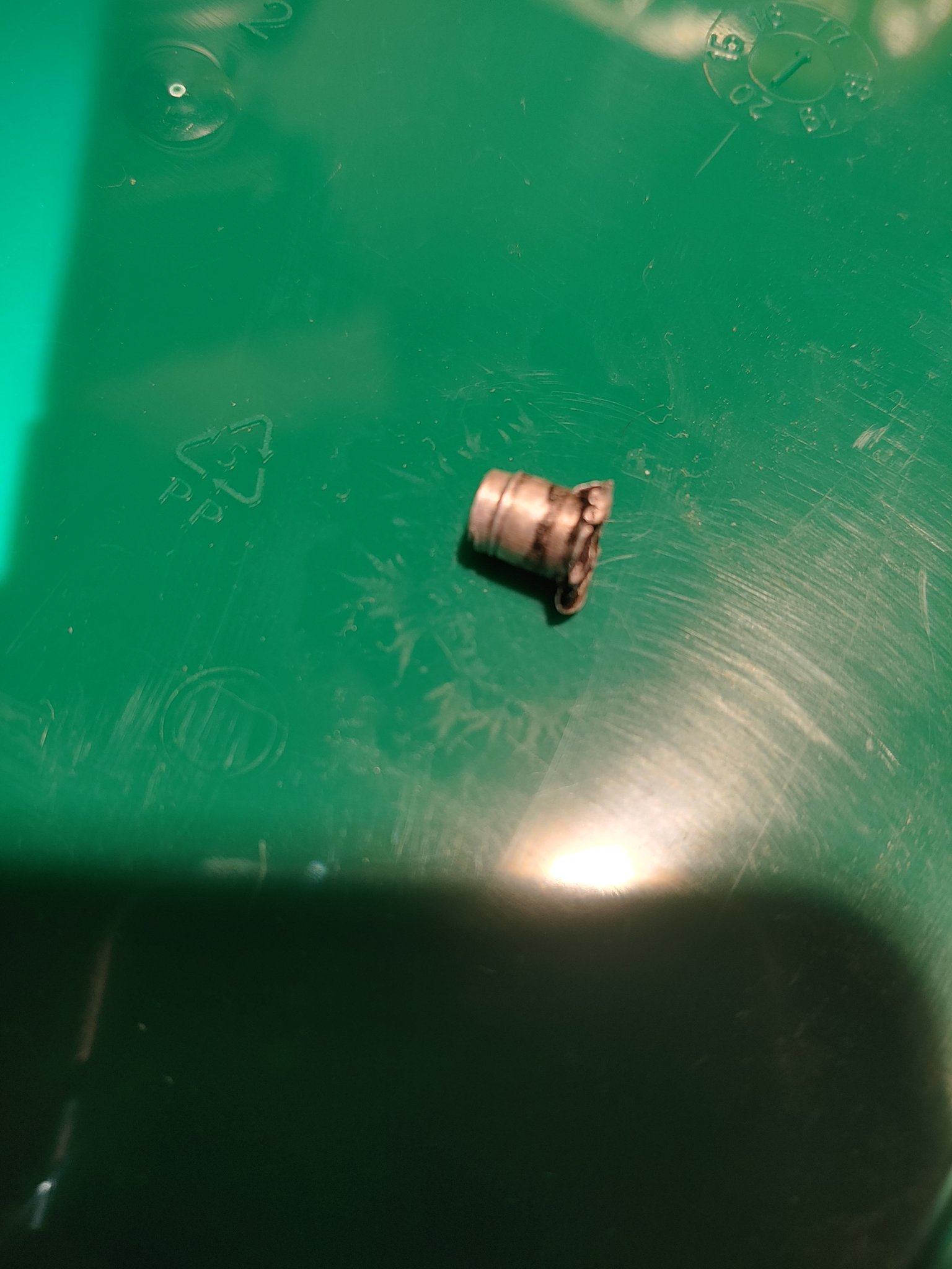

You guys were correct. Thanks so much. I found the old plug sitting on the alternator bracket. Is this something that I need to get from kubota? or can I get it at an auto parts store? It looks pretty cheesy and a little beat up. I would rather install a new one. Maybe it will last longer. 20250603_193247_HDR.jpg 20250603_193247_HDR.jpg

The new plugs are threaded, you will need a tap of the right size.

The plug in the service bulletin is near the oil filter. On my L185 the alternator is on the opposite side of the engine.
So have you actually located the hole the plug came out of (and where oil is gushing out)?
Please post a picture of where this is located so I can inspect my engine to see if I need to worry about the same plug.

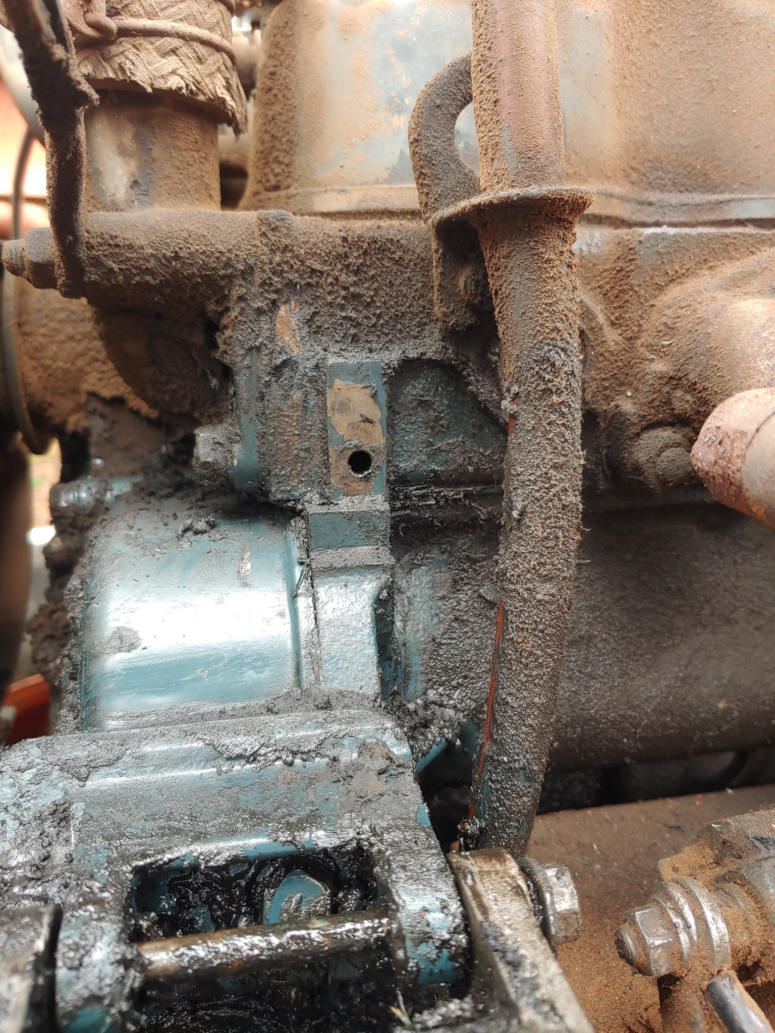

Russell. Yeah I located it directly behind the alternator. You will have to remove it to see the plug. If you see oil weeping around the alternator its a good chance its that plug. whitetiger, I sent that and the other diagram to my kubota dealer. They have no idea about this. Thank you.

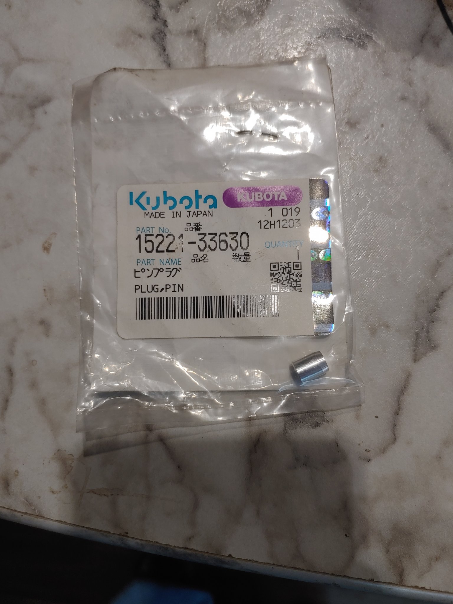

This is what kubota sold me. It is the same part. I bought 2 in case the other one fails in the future. It will be fixed and back in action shortly. Thanks again guys for all of the help. 20250605_084345.jpg

flintknapper. I used the loctite equivalent. however it was useless. These plugs are slightly larger than the hole. So when they go in the ouside of the plug scrapes off slightly. The plug is very soft. I used a drill punch after installing to tighten it a little more. Its holding so far. Will see what happens after a few run times from cold to hot and expansion and contraction. If it pops out again I will find a small fine thread bolt and tap the hole.
