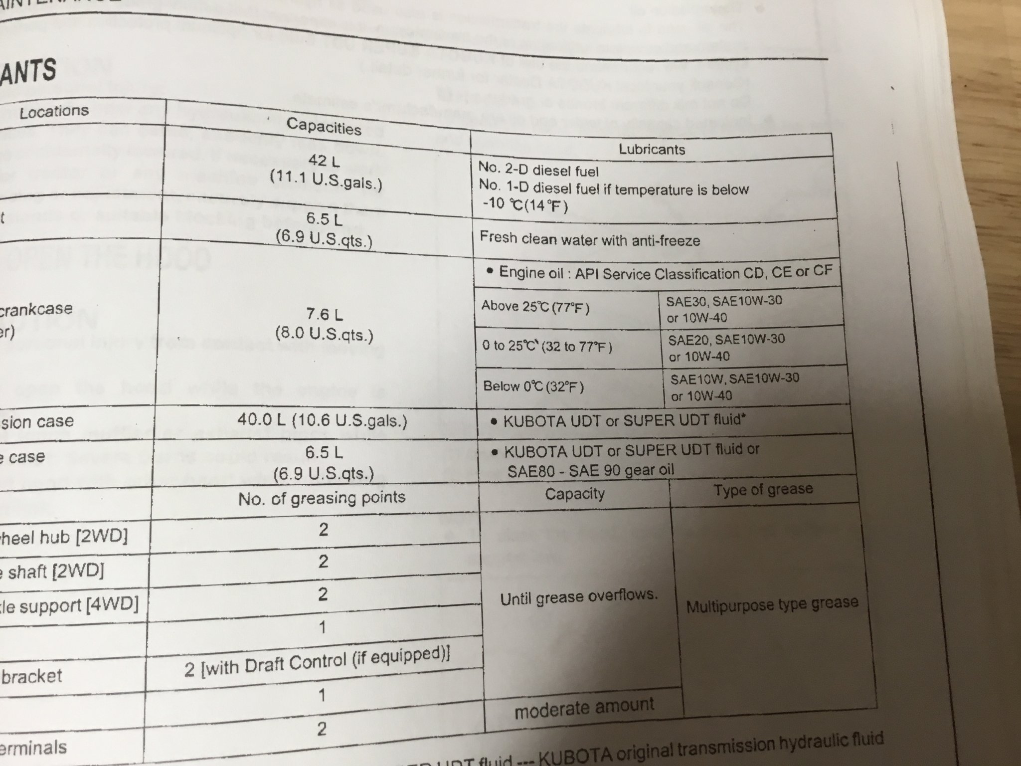

Not to dicker but here is the manual. There is nothing in there about 15w-40. However from the other comments I take it it doesn’t matter.

I don't know when Kubota started packaging 15w-40.. that may be the reason. They also list 10w-40 as acceptable which is one of the worst weights you can use in conventional grade due to the large amount of viscosity improvers. There are many of us out here running 5w-40 Rotella T6 in just about everything we own... gassers, cars, trucks, motorcycles, Kubota and all other light and heavy diesels. Don't worry, you're safe.
