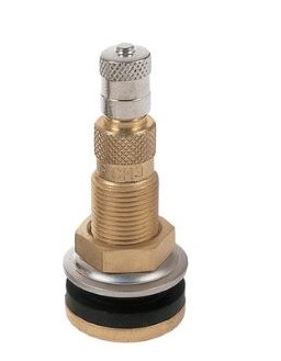

If the leak between the rim and valve continues you could try 'gently' tightening the knurled plastic 'nut' at the base of the valve stem. I did not find a picture of the knurled plastic nut type but I found this picture that shows the basic construction of the valve stem - the rubber seal inside the rim will hopefully keep the entire valve from turning.
View attachment 70128 As I mentioned in an earlier post this tire has a tube and thus has the plastic nut. The example you show is for tubeless tire
