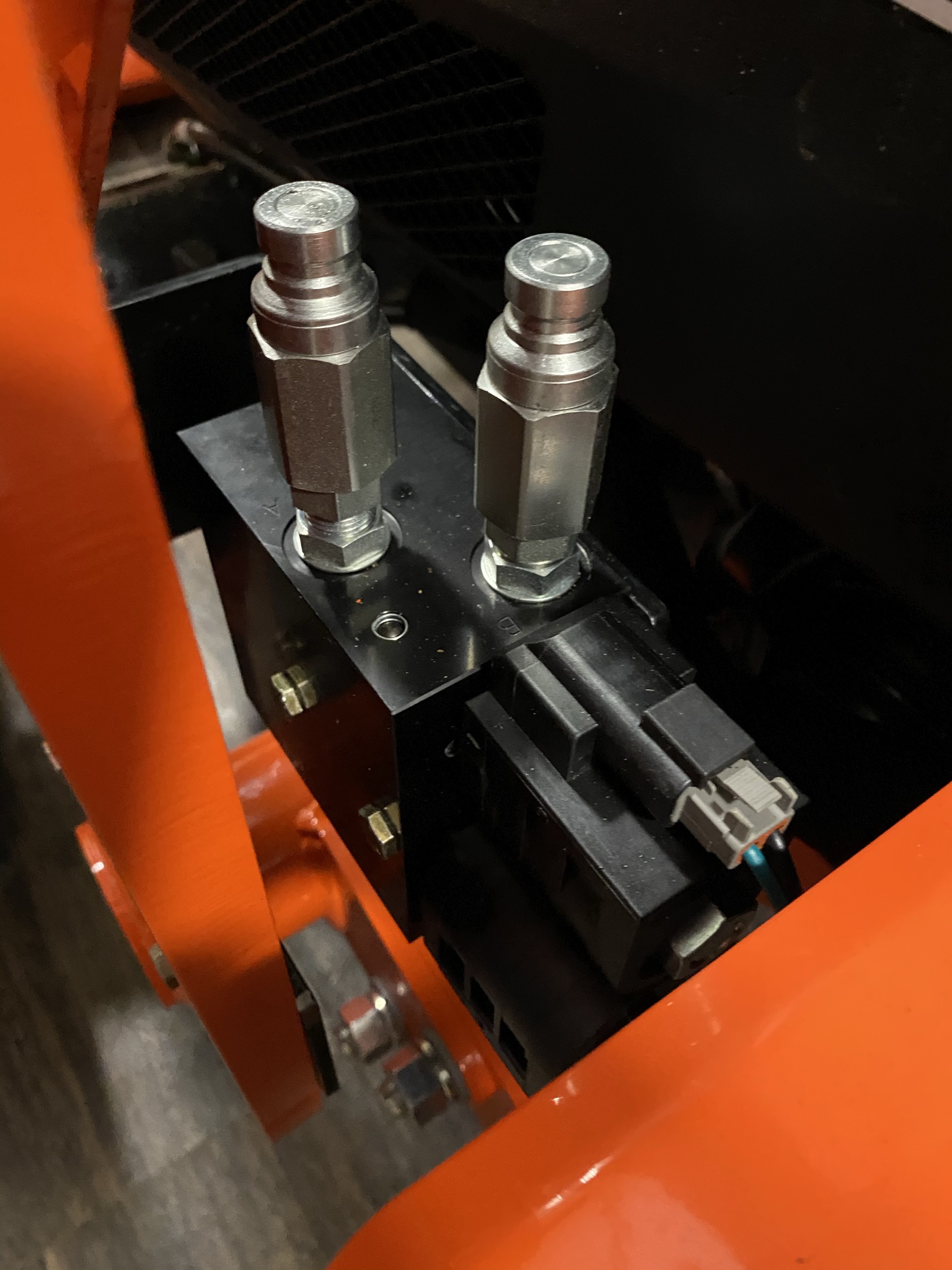

I just installed the LandPride 3rd function on my LX2610.
Completely different setup on mine.
Valve is located on the inside of the left loader support.
Hydraulic lines are routed on the inside of the left loader boom, and are hose, not steel.
But, my 2610 does not have the single point loader hydraulic hook up.
Replacing the return line under the seat was a pain.

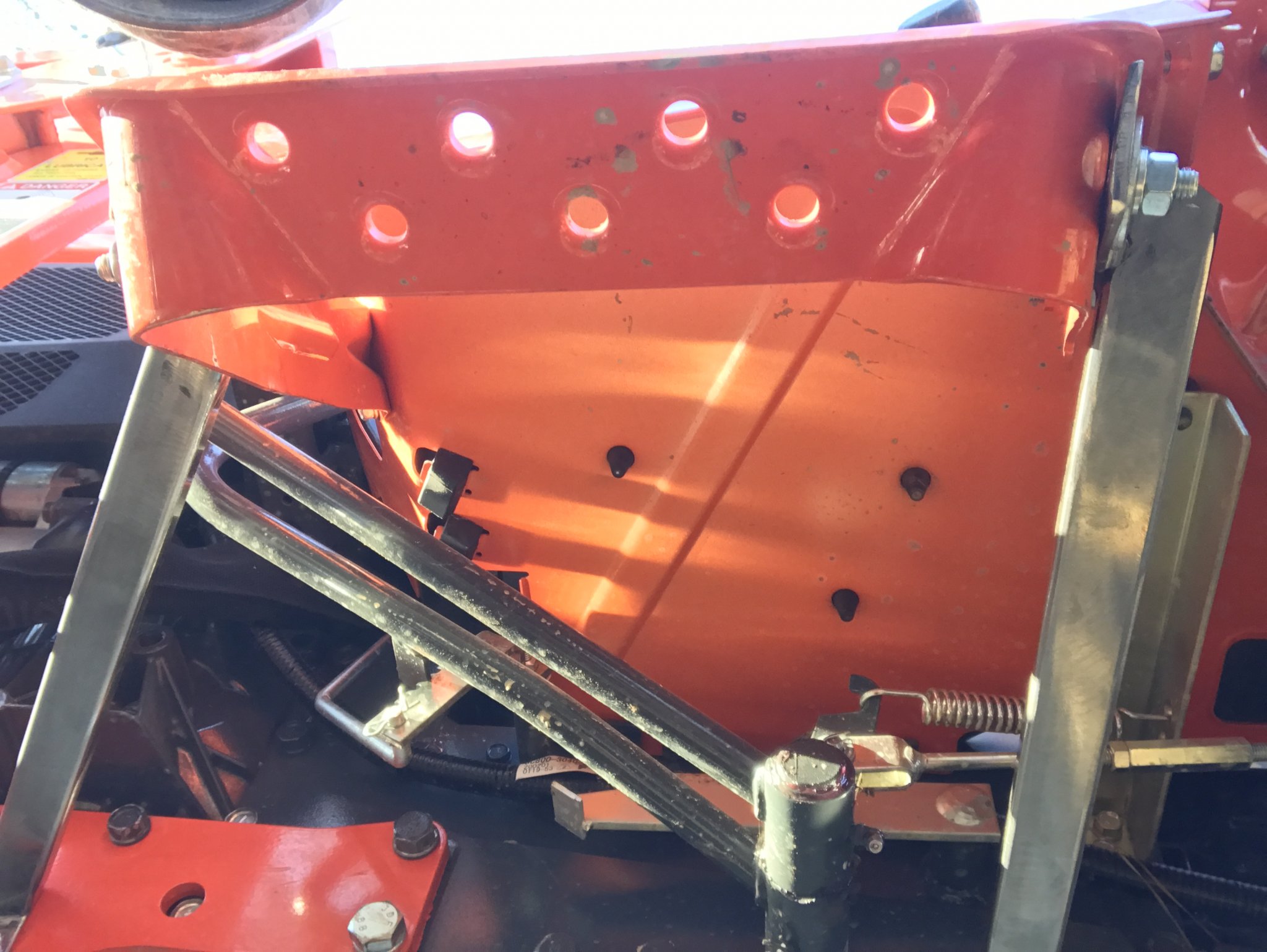

This photo answered a nagging question that's been bugging me since I saw what I thought to be a discrepancy. If you'll look close, you can see a threaded hole right behind the vent, and what looks like a corresponding hole in the seat mounting plate right above it. Straight to the right, behind the filler plug, there is a bolt with a couple spacers that goes through the plate, and threads into the transmission housing. That bolt doesn't actually appear to be holding anything, other than acting as a dowel to locate the seat support. I've been thinking the whole time that my tractor was missing a bolt. After looking closely at this one, nope, same exact hardware on mine that is on this one. I really need to take a closer look at how that thing is mounted.
I've noticed quite a bit of flex in the floorboards getting on and off the tractor, too. I'm not what I'd consider a 'big ol' boy' at less than 190lbs, and I wonder about the longevity of the stock step on the LX models, or perhaps fatigue cracks in the floorboard. Am I worrying about nothing?
Funny you mention that as I thought something was missing on mine as well. I have the flex with the step also but I'm guessing it's the same setup as they used for the B2650 so I'm not worried about it. This guy added some reinforcements that seem to help.

Hard to see how he mounted the far ends under the deck. I wouldn't think it would be a smart idea to weld them so they can't be removed. Shouldn't hurt to just take one bolt out somewhere on the frame for each leg of the brace and put them under the existing bolts. Will obviously have to keep bolt length and material thickness in mind. Hard to see properly, but it looks like he used angle for that. I'm thinking box-beam or tube would look nicer (as well as be stronger) and round tube would be one less sharp edge to bump my noggin on when I go after the HST filter change. If I use round stock I can flatten and bend it on the ends to fit, much like the bracing on strut towers on a car. If I use box beam, I can weld a bar stock flange on it and close up the end to keep yellow jackets and dirt daubers from moving in, but will need to leave weep holes to keep it from filling up with water and splitting when it freezes. Hmmmm, sounds like a fun project. I think I already have the materials I need if I go with box beam. Don't want to steal the dude's 5 minutes of fame, just improve the idea a little. If I giterdun, I'll post pics and maybe some drawings so you can copy.

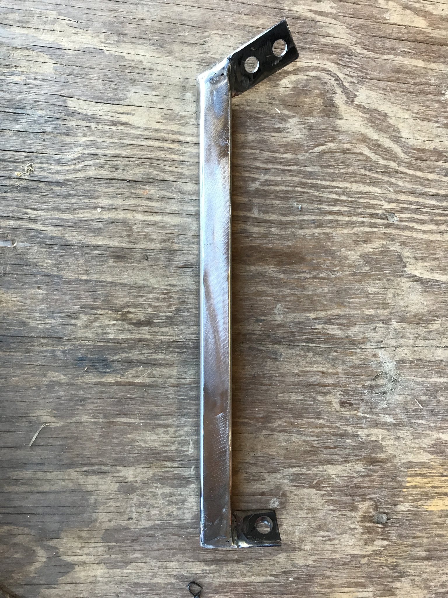

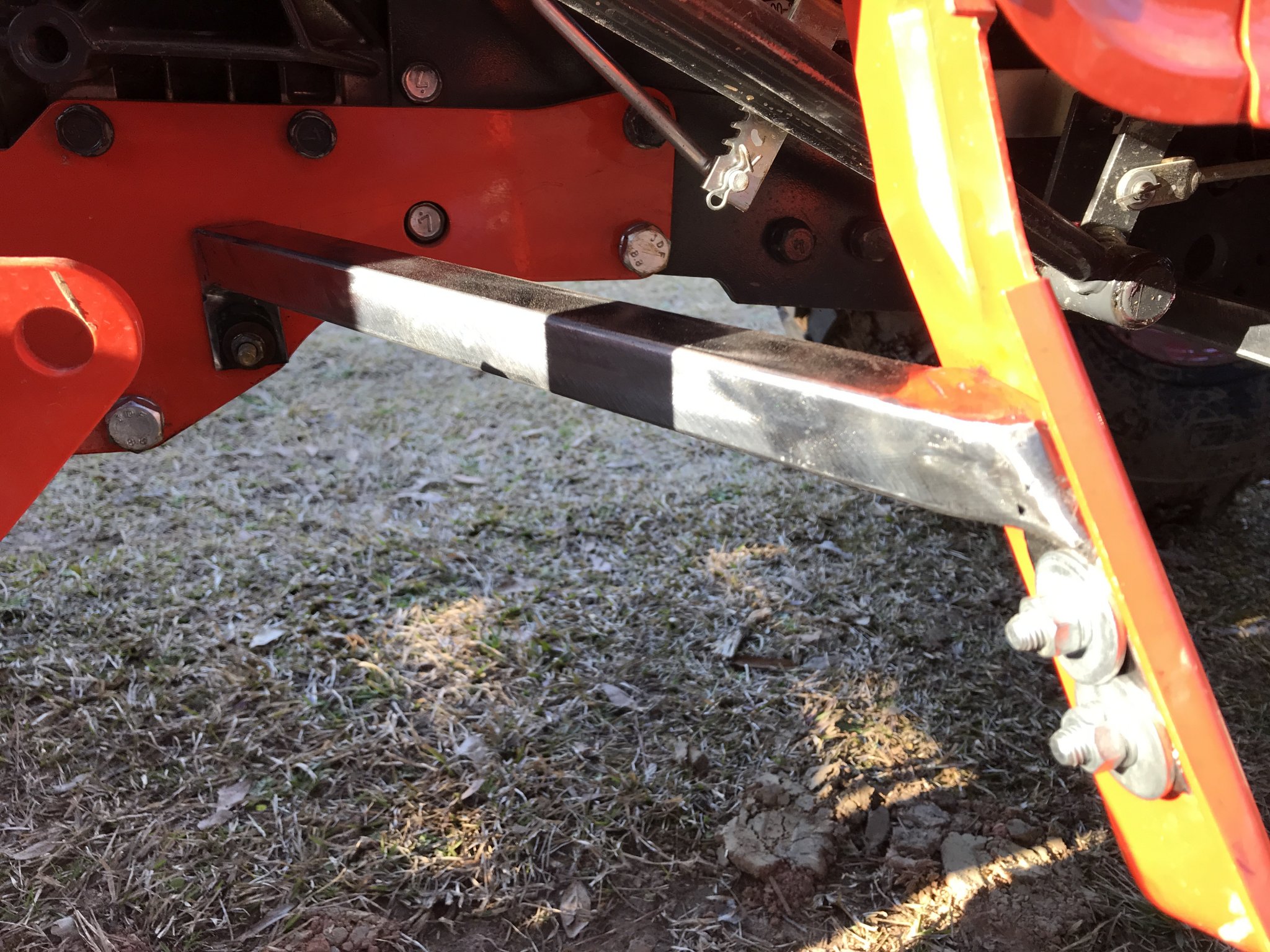

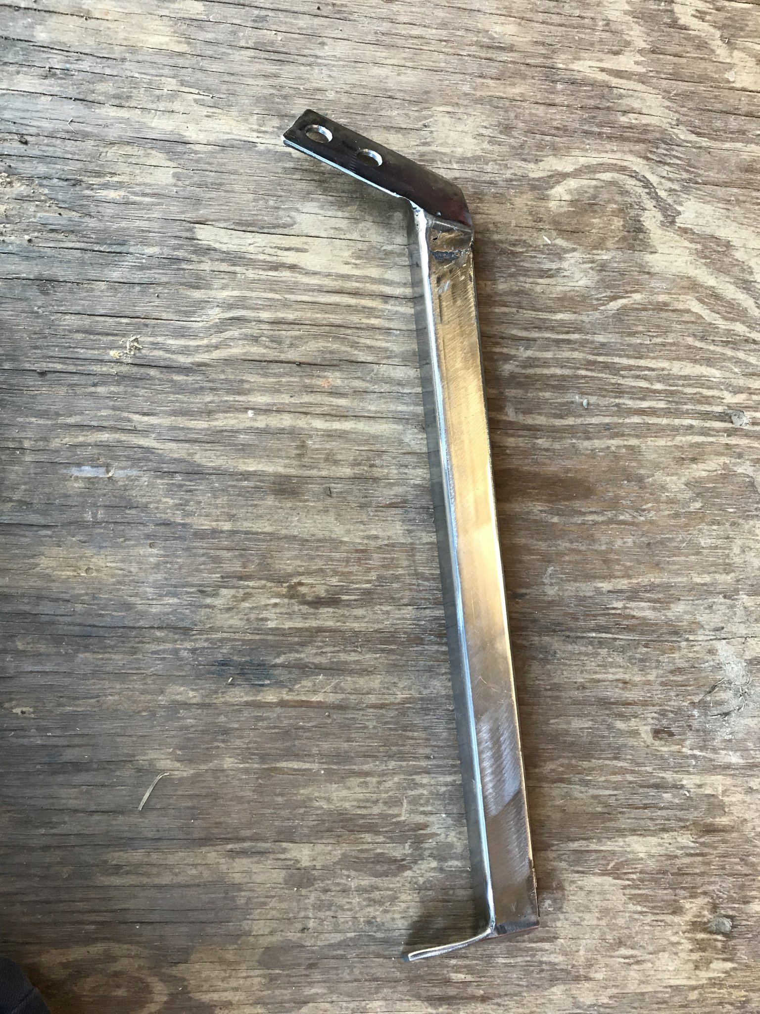

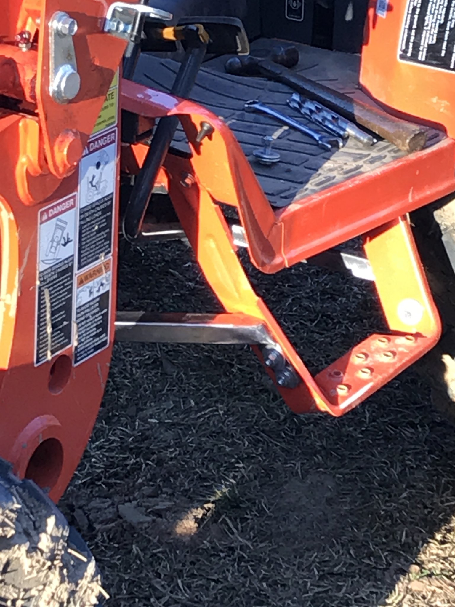

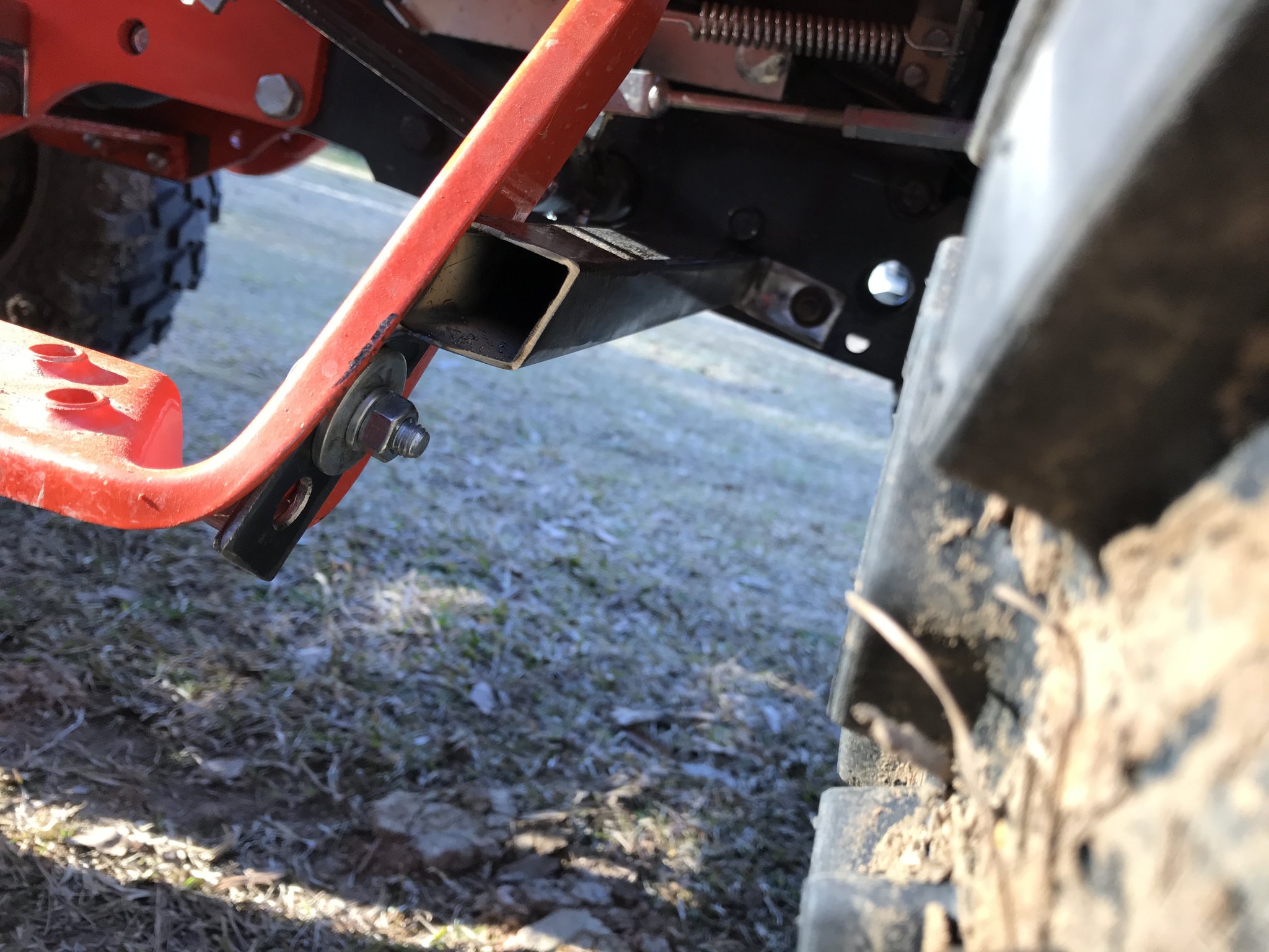

No drawings , but here's some photos of what I did today. I free-handed most of the work, so didn't really take any measurements that weren't corrected with an angle grinder and cut-off wheel.

Didn't take any close-ups of the rear brace, but it was very similar to the front brace. Made the braces with 1" square box beam and 1.25" flat bar stock (which really wasn't very flat). Never realized just how hard rolling scale is until I tried to polish up the braces after welding. Welded the bolting flanges to the box beam, and drilled one hole for the tractor end, and two holes for the step end. Wound up using only one hole on the back.
I have learned that I'm an excellent welder, if you leave me alone with a grinder long enough. I didn't learn wire-welding in high school, and high school was a LONG time ago. Marking and cutting the angles on these was fun. Kinda free-handed them, and then what didn't match up, I filled in with the wire. Had to be careful not to blow holes in it, but managed to seal up the front bracket. Still gotta put a cap on the end of the rear brace. and close it up, then I'll drill some holes to keep 'em from filling up with moisture. A little Kubota orange, and these puppies will look like they belong here.

Oh, forgot to mention, this kind of adds a little bonus of a bit of a guard for the HST filter. Unless something goes between the two braces, then, the HST filter will be toast. I try not to run through that kind of stuff if I can help it, though. P always treat my machinery like it can be broken, because, usually, it CAN. Especially when I'm using it.
