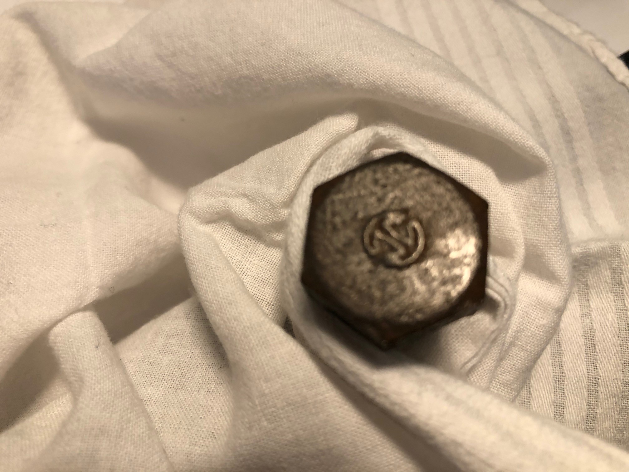

Took apart an older Howse 5' rotary cutter. The shear bolt is bent but not sheared, making me think the bolt may be a grade or two above what's recommended. What was there has an unusual marking (at least to me) on it.
Can anyone identify this bolt marking?
Thanks.

Looks like the manufacturer's mark for Highland Bolts and Nuts. No other marks, so Grade 2
