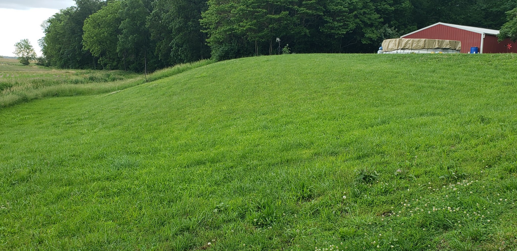

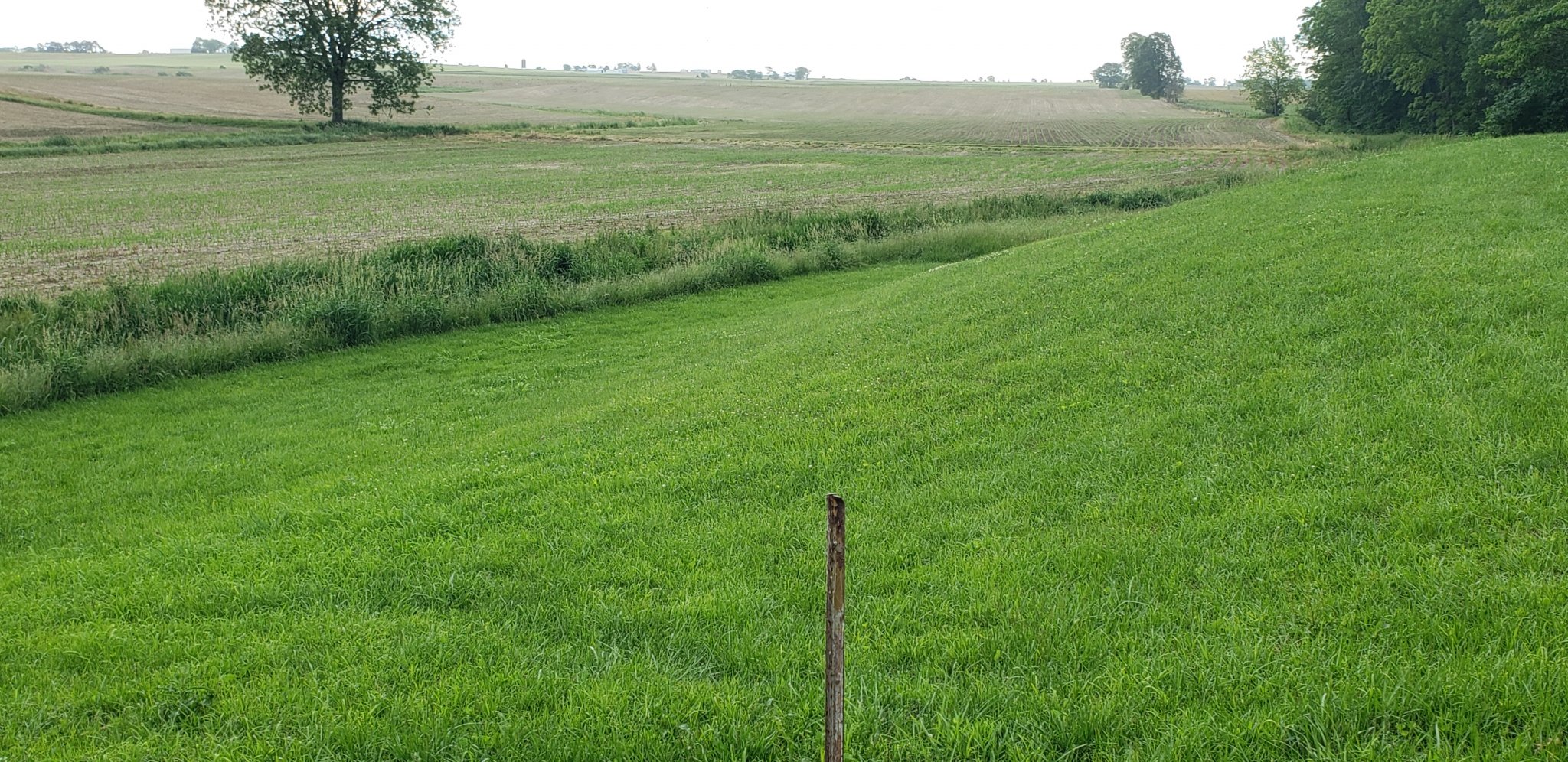

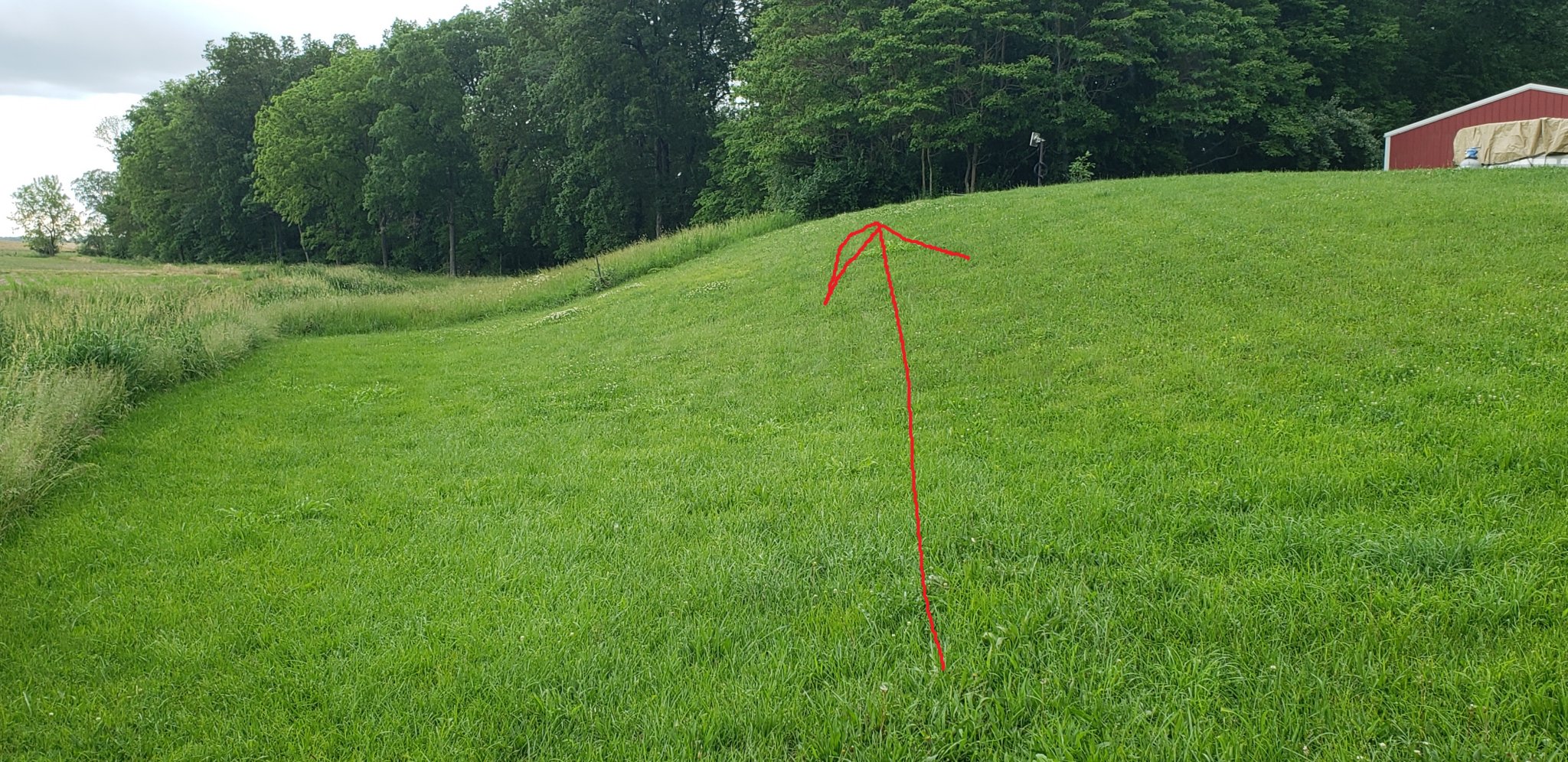

I have included a few pictures of the hill in my back yard that I will be mowing only, no tilling. Garden is on flat area at top of hill.
The one side of the hill is approx. 15 degrees and at the other side of the yard may be closer to 40-45 degrees. Not a large area on the hill.
With my riding mower I do a couple of passes around the perimeter going up the smaller slope and down the greater slope. Then I mow at an angle going from bottom corner of lower side up the hill at an angle towards the side with larger slope (see red arrow in picture). Once I can't make the turn then I mow the 2 triangles left individually.

The pics say a lot. That’s a nice place you got there. I don’t believe I understood the math. That is very different than the original written description from the way I interpreted it. Any of those machines should be able to handle that at least at a glance of my perception of the pic…45 degrees seems steep but it doesn’t look aweful in the pic…maybe I am still misunderstanding. Assuming all maintenance has been completed, none are really over used and 2 and 3 options seem like lightly used. I think you have a tough choice between the two? Extra attachment or extra HP, knowing full well for the use of the extra attachment the extra HP might be preferred. All three of those machines should be bullet proof if maintained. If the hour meter is true then the attachments could not have been used much. On the BX I had even with filled tires and ballast, it ran out of traction before tan out of Hp…this is in general using loader or skidding trees. It would do a lot…more than most would expect, however from the MMM I thought it was under powered in tall grass…for regular mowing it was fine. I think the same of my B though too….with HST it’s easy to slow down and let the mower catch up. Regarding the slope it sounds like you have a procedure already…you can always fill tires and put ballast on to give a little more margin…(split breaks would help but I don’t recall BX having split breaks). Personally I think the B as a BX with a lift and bigger tires and less stable than a BX…IMO. I am not sure how any of those would work with the tiller you mentioned. I would think if the garden already existing or previously filled it makes little difference…to break ground it may mean go a little slower, make shallow passes…and maybe a few more passes if it’s too much, but honestly I don’t know. Have fun shopping and keep us posted.

You're not going to be able to mow that the same way as you have been, it's too steep for a BX, it will roll on you!
You might be able to go straight up or straight down, but only in 4wd and be prepared for slide or spin.
And I wouldn't mow it with the loader on!

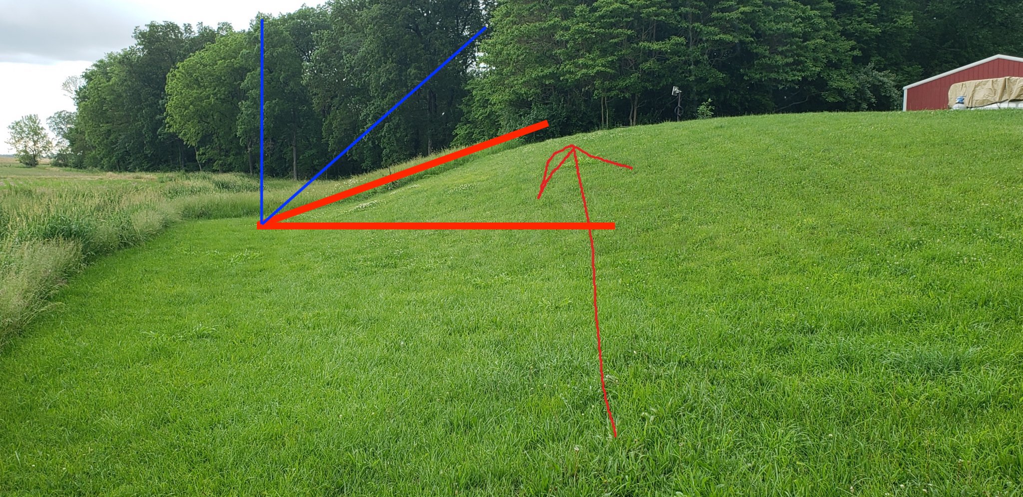

Angles are very hard to judge. I typically take a photo and then draw on it (as below), or I put a board on the hill and ask my phone what the angle is (the level in your phone can also tell you angles).
I think the blue lines are roughly 90 degrees and 45 degrees (they're freehand, no guarantees). I'd make that angle at the back about half of 45 degrees, so about 22 degrees. And that would be safe up and down on a BX, a little hairy if you're going along it in the angle your original red line is running. Not that you can't do it, it's just something I'd take care before doing. But I don't see any reason to run side to side when you can go up and down - you've got reasonable runout at top and bottom so if it gets away on you it'll stop at the bottom.

As an avalanche instructor I'm used to judging slope angles to prevent death. Although pics can be deceiving, I don't see anything there over 25ish. If it's dry a BX should mow that safely, a ZT would do it much faster ;) If it's wet, come back when it's dry is my approach.

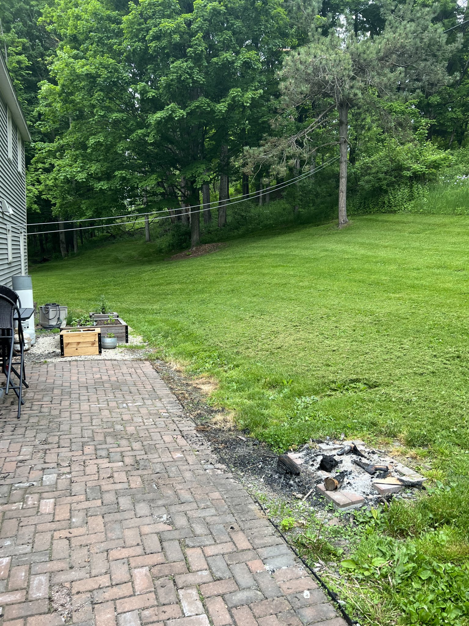

Doubtful it’s as steep as the PO’s, but I’ve mowed it for 32 years. It’s steeper closer to the camera, off the corner of the house, and kind of variable.
This is 10th with a BX. Had just 2 garden tractors prior.
Obviously I side-slope all of it. Do it without wheel spacers. I would never suggest the OP’s slope with the loader on. I might try a SSQA with just the bucket off.
Just to be clear, don’t suggest nor recommend you do as I do. Only point is a BX is pretty stable.

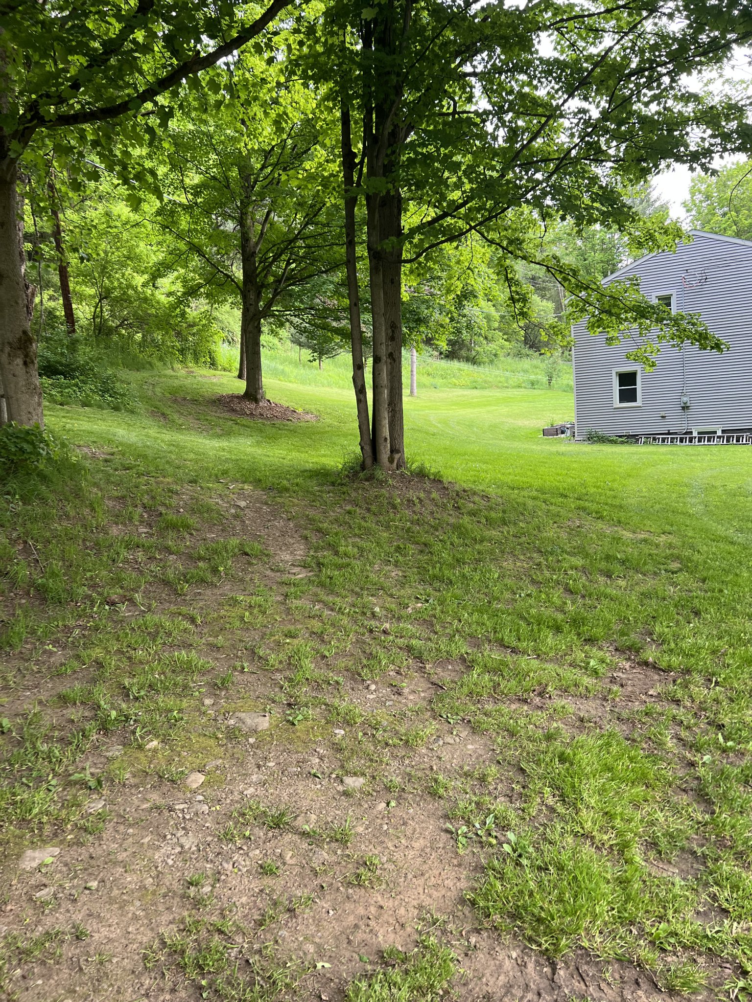

Here’s a view from the other direction.
