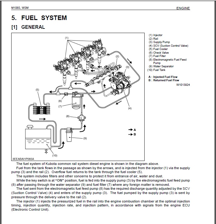

Do you know that your M108 has an electronic controlled common rail fuel injection system.
I have attached a page describing the fuel system.
Unless you have some particular training in these systems, I would suggest you call for dealer help with their proprietary computer system.

Yes it does have a fuel rail system and yes this is one of my fears it could be ecu. there are no codes appearing on the dash. Its kinda funny i have 9540 thats newer with a regular pump and injector system.
