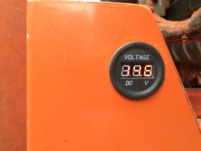

I installed an "always on" voltmeter. It should read 12.7 before it is cranked showing that the battery is good. A reading of ~14.6 indicates a properly charging alternator.
