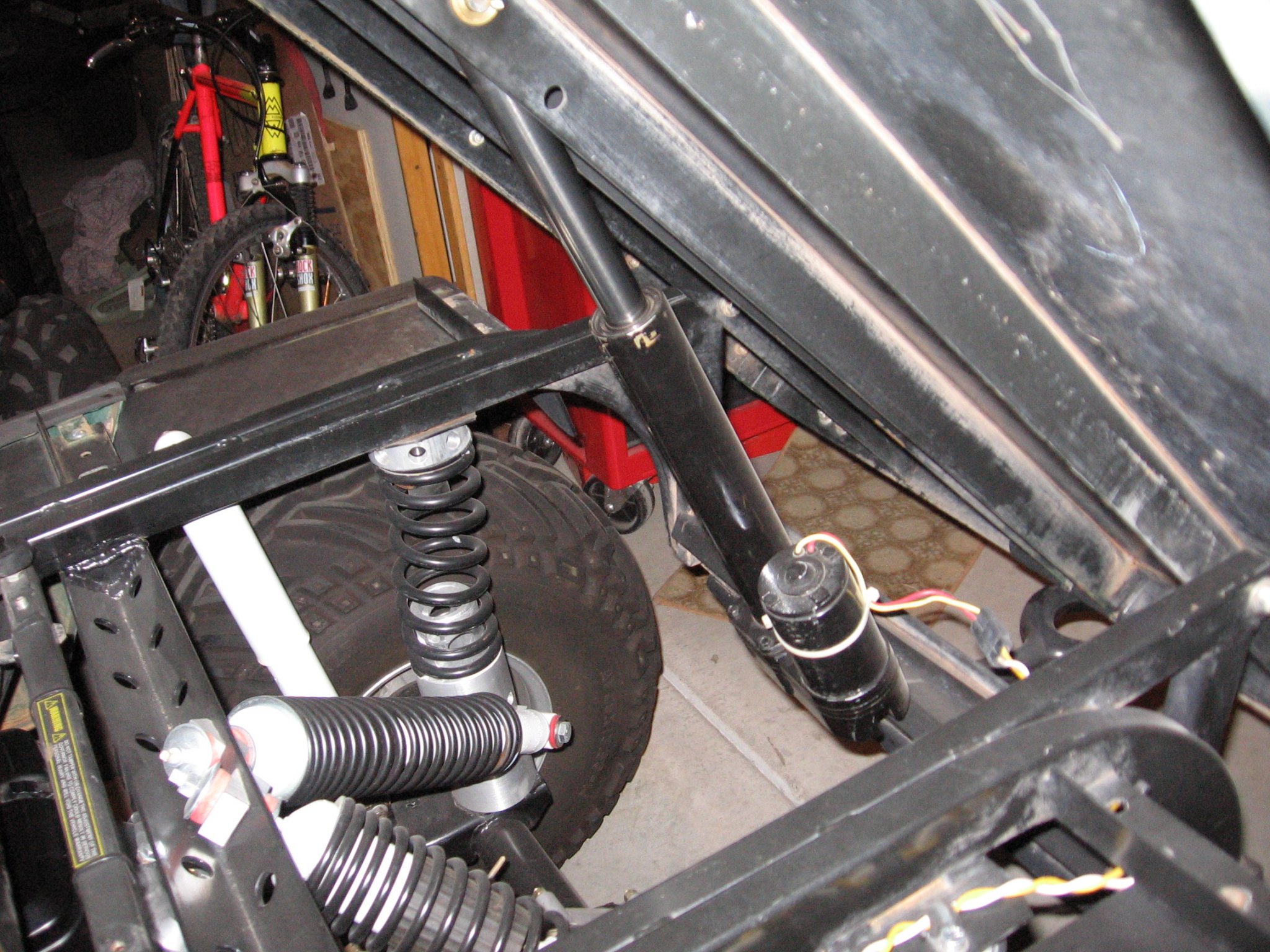

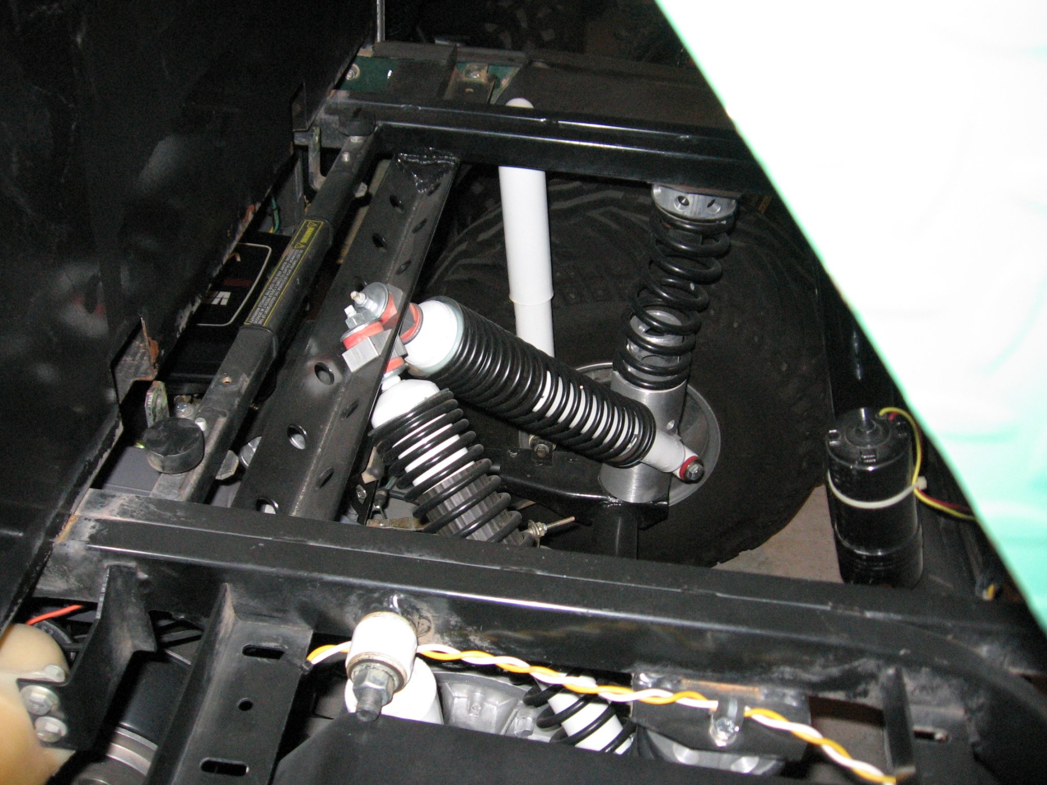

I would also put in a linear actuator, like this one in Lil Foot, my "Golf Cart"

Nice buggy you have.
Thanks. I'm sure there isn't another like it on the planet, especially with all that traction and a 16hp V-Twin.
