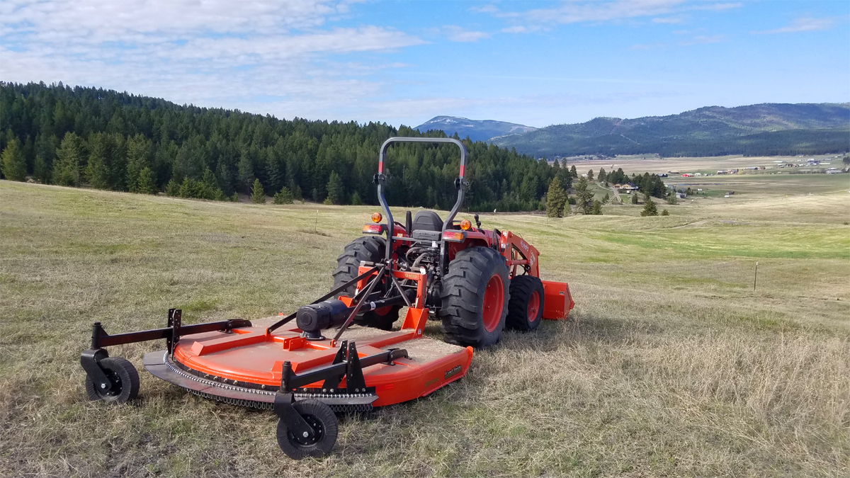

I have a 7ft Land Pride rotary cutter (RCR1884) with front and rear chains, dual wheels and slip clutches. I used it a lot last year at my place and a friend's place cutting 25 or so acres.
There can be a lot of things to think about when choosing a rotary cutter beyond quality and reliability. They're expensive implements and it's easy to make a mistake. I should have looked at dual spindle rotary cutters, and maybe the single spindle would still have been the best choice but I'm not sure of that. Unless you can try before you buy you have to take a leap of faith sometimes.
Anyway, things to think about in no particular order:
1. Size
2. Weight
3. Single or dual spindle
4. Floating or static top link
5. Cutting height range
6. Single or double rear wheels
7. Shear bolts or slip clutch
8. Rubber, metal or chain guards
9. Deck design
10. Cost
I'm not cutting in and around a lot of tight places, but rather fairly open fields so bigger was better for me. The problem with large rotary cutters is that it's easier or more likely to get them high centered. That's one of the reasons why I decided to buy an offset flail mower to use in conjunction with or possibly instead of the rotary cutter. Only time will tell.
