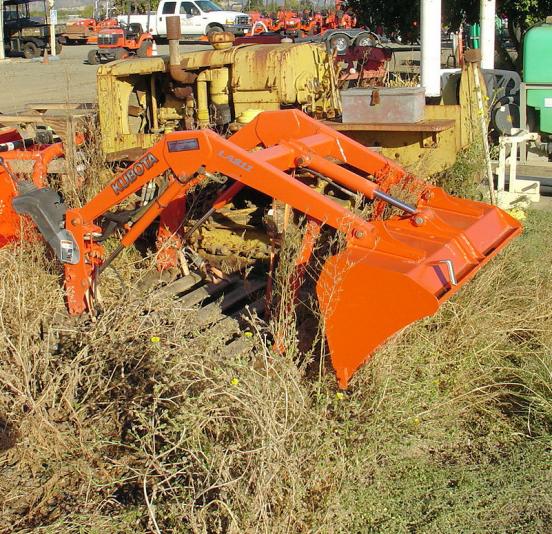

I bought a Kubota brand LA211 FEL after a few years of having the BX2200. They are very hard to find and the local dealer just happen to have one sitting out back all overgrown with weeds. Other companies make a FEL for the tractor and likely that will be what you will be looking at.
