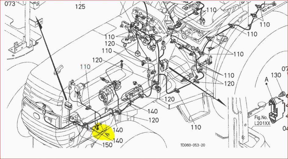

Another possibility is that it has lost the ground connection, look at the yellow spot and check the ground connection. :)

So got it figured out. Tested the fuse block (the one by the radiator), no power. Followed the wires out of it, and found a black plastic connector not connected to anything, then noticed a metal tank attached to the battery terminal... Re-attached, and powered right up. Doh! Glad it was something simple. Thanks for the help.
