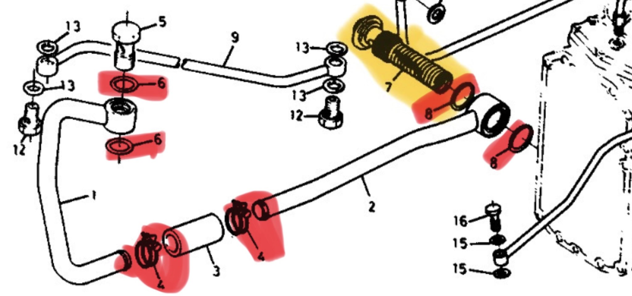

Small bubbles in the fluid are not normal.
From the diagram above I highlighed in red the places air can be sucked in. It may be best to replace the hose and clamps since a small hole in the hose can also cause air to be sucked into the pump. I believe all the others are a sealing washer but they can be a copper or a rubber (encased in steel) so not sure which you have. Get new from the dealer and replace. Clean the surfaces and make sure there are no large scratches on the surfaces.
If you drain the new fluid out into clean containers you can reuse the oil. I would suggest using paint strainers when draining and then filter it through a filter before using it again. Perhaps a fine micron filter that fits on or in a five gallon bucket would be better like these bags that might work really well.
or these that sit on top of the bucket
on edit = added photo I had forgotten to add
I drained fluid again and replaced o-rings #8 and hose #3. Strainer was clean this time but did spray with brake cleaner and used air to blow out. Still no lift. The pump sounds like its cavetating. Will replace o-rings #6next.

While you are changing the o-rings you can also ”prime the pump” by putting some hydraulic fluid into the top opening of the pump. I would recommend leaving the banjo bolt out and pouring oil through the opening in the tube marked #1 where the bolt is installed.
The oil may drain down slowly since the oil level might be below that level. The coating of oil on the gear teeth in the still help the pump pull oil into the pump. But I would try to start the tractor soon after you get it back together to give it the best chance of pulling fluid.

A gear pump is self priming once filled with oil. If it loses prime after sitting its defective.

A pump kit is not going to fix your problem. If its bad you need a new pump.
Do a little diagnosis before throwing money at it.
Remove the hose clamps (4) and rubber connector (3) on the suction line and drain the oil into a bucket. Start the tractor and use your thumb to test for vacuum on the suction pipe

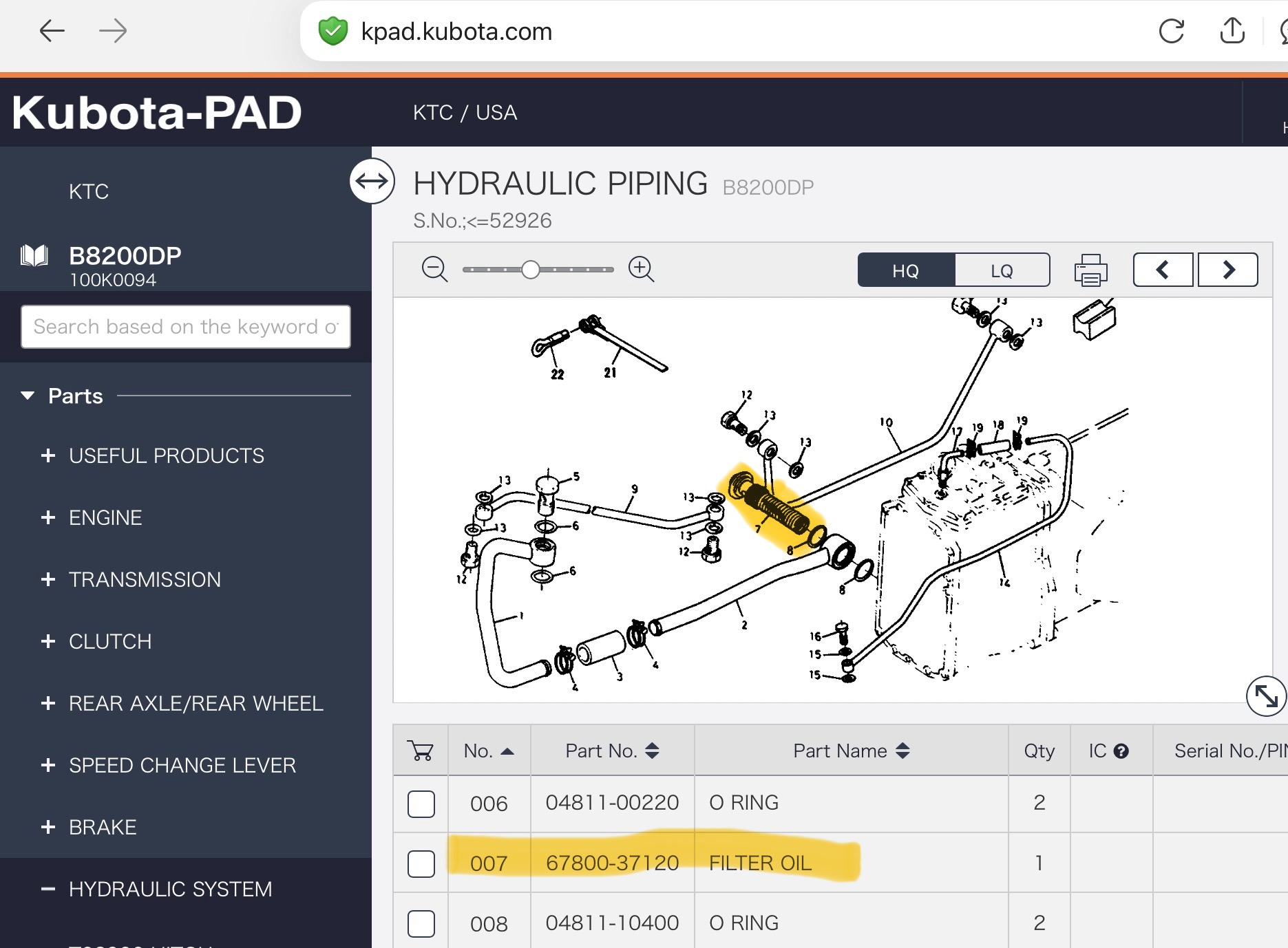

Thanks everyone for the help. After cleaning the strainer 5 times I have lift.
