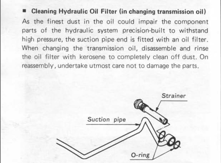

Regardless he suction strainer needs to be cleaned. it will look like a bolt on the side of the transmission.
This is what the suction screen looks like.

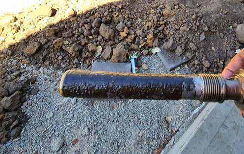

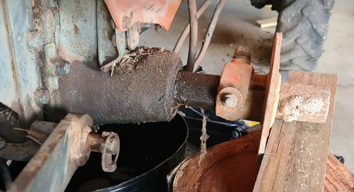

Today I dropped the loader frame which was bolted to the rear diff assembly.
This made it possible to remove the filter from the transmission.
Filter picture below.
The loader frame is cracked so going to take it into town for repairs.
Also noticed some sort of nasty setup on the rear axle with how the
frame for mounting the wheel is attached. Looks like I have rear seal
leak as well.

Yuck. Definitely time to clean that filter.
The rear wheel hub is a poor design. Supposed to make it easy to adjust the wheel width, but tends to be a very sloppy connection. There are a number of fixes to tighten it up and also an updated hub available.

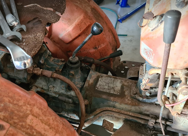

Ok like Dave said my knowledge of tractor part terminology is a little unclear so
it is why I have started to post pictures.
Here is one of where the hoses go.
Thanks for the help.

Yeah, that looks like it is supplied from the directional control valve. Is that the return line on the other side of the gear shift? It appears to be returning to the fill port. There should be a tee fitting with a cap for topping off the fluid. And I assume there is a separate joystick or pair of control levers for the FEL functions?
It is safest and most stable to have some weight hanging off the 3ph as a counter-balance when using the FEL. An implement, a concrete counterweight, a box of rocks -- whatever you have that weighs a few hundred pounds. Hard to do with that hydraulic configuration, but you can lift it with the 3ph, chain it up (there should be a slot above the 3ph to accept a chain link) and settle the weight on the chain before switching the valve to FEL use.
I would definitely clean that filter first and change the hydraulic fluid. And remember that the lever used to lift the 3ph must be in the Up position after changing the directional control valve to use the FEL if it has separate FEL controls.
(Some early FEL designs on domestic tractors had a simple single-direction lift and gravity dump with a cable operated release. The bucket would be re-latched in the horizontal position by lowering the FEL to the ground. Primitive, but it worked. That concept would just use the directional valve itself to raise and lower the FEL).

I believe it is the return line on the other side of the gearshift where the filler normally is. You say about a T fitting being there well who ever set it up neglected to install one. I have been removing the fitting to fill the transmission. I will get a T and install on my next trip to the hydraulic shop. Yes I have separate controls for the FEL.
You also mention the counterweight for using the FEL. I have a slasher on the back which I ve been holding about half way up. Should I be chaining it in position and releasing the pressure on the 3Pt when using the FEL?
Other issues i have are stuck in 4wd looks like the lever is seized. Also the PO used the decompressor to stop the engine. I can see from the users manual the key should stop it. I ll be getting around to these shortly.
Thanks
