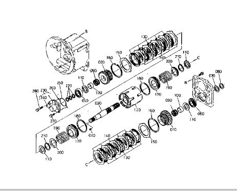

IMHO the issue is all in the hydraulic shuttle valve. The forward clutch pack isn't getting pressurized and/or is leaking down, failing to remain engaged. Check the shuttle linkage first - it may not be pushing the valve far enough. The shuttle is a pair of wet clutch packs inside the transmission - they are likely ok if reverse works. The shuttle valve may have a problem. Study the WSM and parts drawings, take the valve apart and clean it out. Good luck, Dick B

You've went into the mechanical clutch, but have you went into the hydraulic clutch pack?
Because it goes into reverse easy and all the time, I'll say I suspect that you have a synco issue on the forward side of things.

That's not true, it has a dual clutch pack so it's very possible that the forward section of the clutch pack is damaged yet the Reverse section is still intact.
