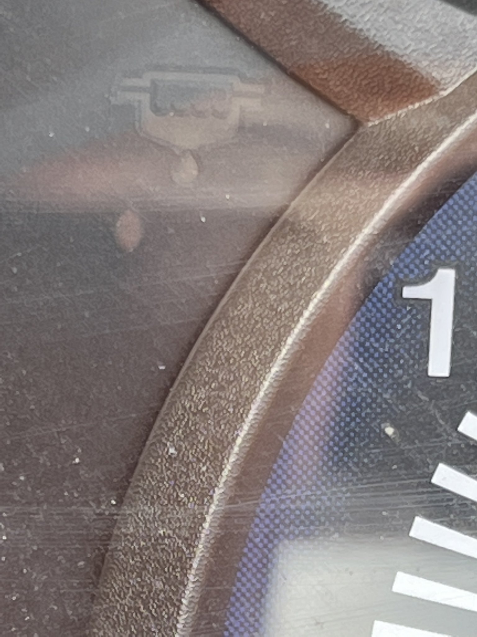

Hi all!
Looking forward to learning here from many of you. Just picked up a 2021 mx6000 with 14 hours on it yesterday. Unloaded it and notice when I turn up the throttle to say 1800 a light comes on flashing and it beeps until I lower the throttle. It’s this light on the dash to the left of the 1k mark on the tachometer. What is this light?

Did your tractor come with a owners manual ? If not you should be able to download one from Kubota. A WSM ( Work Shop Manual) is also a great reference to have and are relatively cheap. Nice looking rig.

water separator is a CRITCAL light ! Diesels do NOT like water IN the diesel. For sure ,read the manual about what to do NOW, before any damage, $$$$$$$$ damage ,is done.

Seems odd for such low hours and only coming on at high idle speeds I’m betting electric issue and not water in diesel but I’m with greensvillejay I’d be checking it out before I kept using it.
