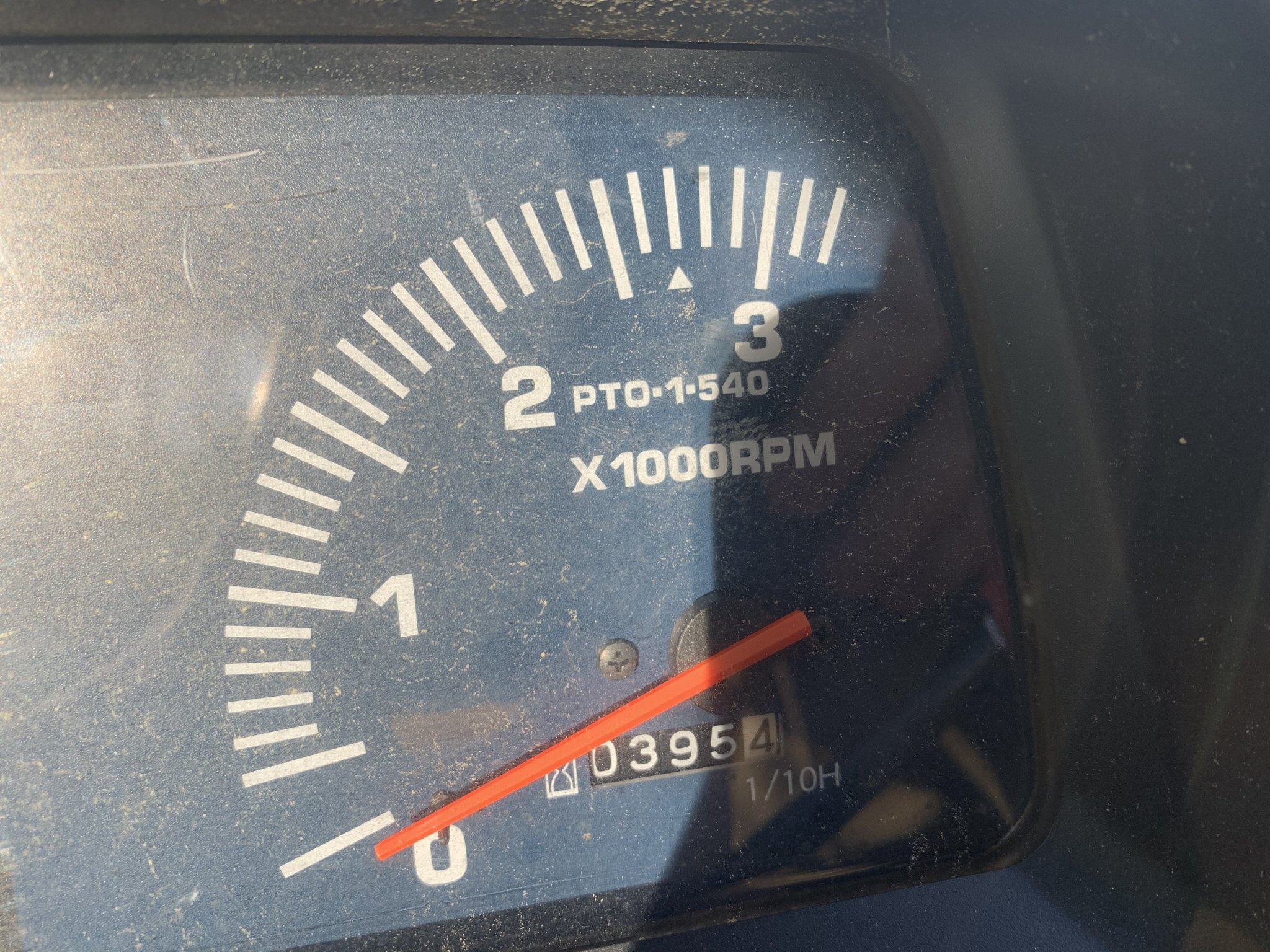

Should be an odd color line or dot on the tach to show 540 PTO. Usually up around the 2000-2500 engine rpm mark.
6,329
1,985
The 540 RPM is the tractor pto shaft speed (also is the input speed of the implement (rotary cutter)). The tractor engine speed could never be as low as 540 RPM or the tractor engine would die.
There should be some indicator of engine RPM for 540 RPM PTO speed. On old tractors there was a marking on the tachometer that gave the proper engine RPM. On the newer tractors there may be a separate display setting for PTO RPM instead of engine RPM.
The engine generally has to be around 2000 RPM to achieve the 540 PTO RPM.

The 540 is PTO rpm, NOT the engine rpm you see on the tach. Unless there’s something really odd about it, there should be a mark on the tach for whatever rpm you have to have the engine running to make 540 on the PTO. Run it at that speed. If your tractor has a multi-speed PTO make sure the selector is set for 540. There’s a good chance 2000 engine rpm is actually a bit slow.
So far as the 540 rpm ONLY. If your running 500 rpm or 550 it’s not a big deal. The reason it says 540 only is if you have a multi-speed PTO and set it on say 1000 rpm that’s not cool at all.

I got a chance to check today, and yes, there is a mark on the Tach for PTO RPM. It corresponds with 2300 RPM.
So, learned something new today. Probably would be a good thing if I bought the owners manual online. I didn't get one with the purchase.
