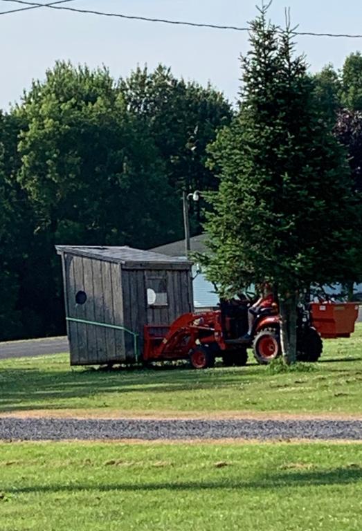

This is where I was a few years ago, no idea what I was going to do with this tractor except for snow blow the driveway and it has ended up being the best investment ever. As far as lift capacity, remember that sometimes you only need to lift something a couple inches to get done what you need which allowed me to move a shed halfway across my property or when I used a 5:1 pulley system to rip some small trees out of the banks on my pond. These little BX's are quite versatile.
Not sure what these weigh exactly but I have lifted and moved to where needed
5 sheets of PT 3/4 plywood, 4 sheets of 3/8 CDX, and 7 sheets of 7/16 OSB, granted it was only maybe a few inches off the ground but that's all I needed to get it where I wanted, worse part was staying on flat ground so the 4x8 sheets didn't hit the ground, haha.

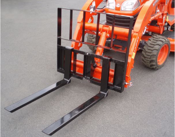

Still been looking around, and found Earth and Turf for the QA that weight 160 pounds total, with 31 inch forks. $697 plus approximately $130 shipping.
Nice find !!!, I missed these when I was looking. Looks like they have a nice high back stop also. If you end up getting them report back on how you like them, may help someone else.
I am ordering the Earth and Turfs today. 160 pounds total, 31 inch forks. Should work for anything I need to do on my tiny hobby farm. I'll report back after I get a chance to lift a couple things. Plan to fill my 40 gallon sprayer and see how that does.
. View attachment 44678
One reason they’re light is the forks look to be made of hollow rectangular-tubing. Careful you don’t try to pick up something heavy too forward on them.... they might bend. (However your FEL/Tractor setup may not have enough lift to do that so you might be OK.)

I called my local dealer today. Sold out, "might" get some in in two weeks. Most of the call was him trying to sell me a Hustler mower. These E&T are the lightest I could find with the rear guard, and I haven't seen any negative feedback on any of their stuff. Hopefully the forks are as good as the rest of their product line.
So....after doing a bit more looking, and reading these replies.....the E&T's do look not at stout as I'd probably like. I'm going to keep checking with my local guy and grab a set of PFL12's when he gets some in. 80 pound weight difference should not make a big impact for my use.
Not hollow George, inverted structural shape. I seriously doubt they would flex like forged forks will.
The gusset on the upright where the horizontal member intersects it, is the giveaway.
They look exactly like the ones I almost bought.... until I discovered the forks are hollow, rectangular tubing. Yes, the gussets are there to add strength to that area, I saw them. They add strength to the mitered corner where the hollow tubes are joined. (How the heck ELSE could they make a 90-degree bend in hollow tubes?)
That’s what is actually the “give-away” for me. Those forks are not nearly as sturdy as they appear and a sufficiently strong FEL can bend them outside/forward of those gussets whereas forged forks will merely flex.
Structural steel shapes (in this case the forks) have very little if any 'spring back' ability. Once structural steel is deformed, it usually stays deformed, whereas forged forks are resistant to to deformation from bending.
I guess they would work so long as you were cautious about how much weight you applied but we all know that people in general don't heed loading limits. Consequently, I'd NEVER purchase them. Most time, light weight means weak (except in aircraft where the use of exotioc alloys means strength with minimal weight. Not the case here.
