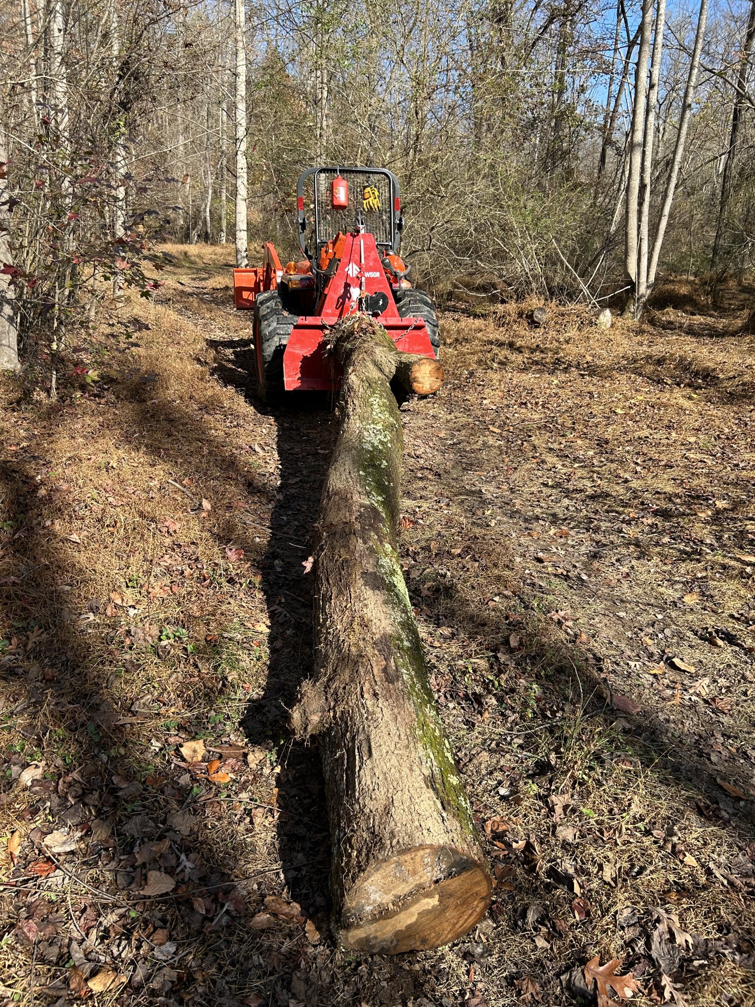

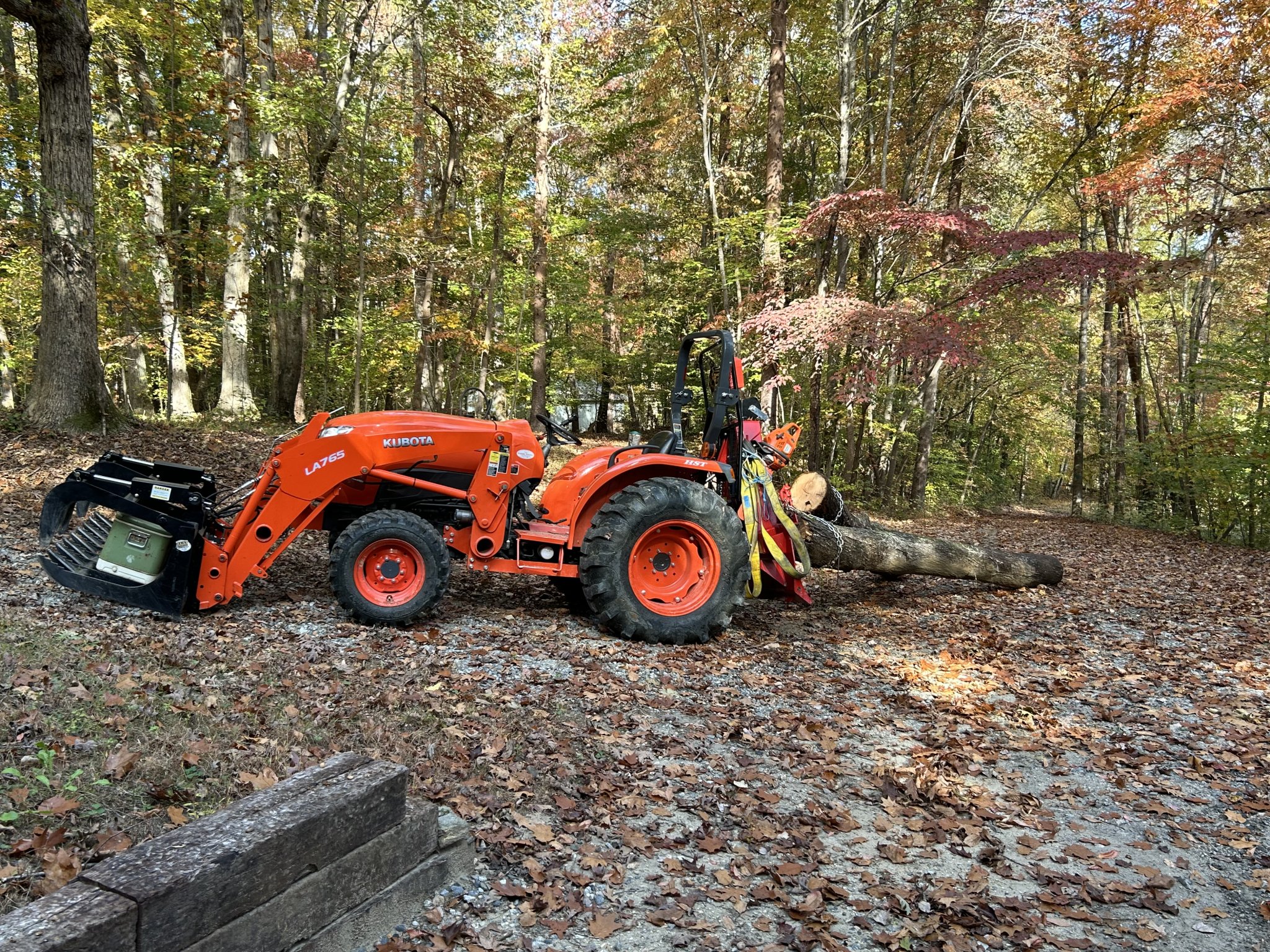

In the interest of potentially adding confusion…
If you’re doing a good bit of firewood work in challenging terrain a skidding winch might be a consideration. There might be part of the Nantahala Forest region that isn’t “challenging” for low impact logging. I haven’t seen nearly all of it. Parts I’ve seen are somewhere between difficult and requiring a heavy lift helicopter. Anyway, a winch will allow retrieving logs from areas impossible for equipment to access; just have to get within range of the cable.
Combination of grapple and winch allow me to efficiently and safely pull down windfallen trees hung up in other trees, manipulate logs and transport back to the wood yard for processing. With a couple snatch blocks, tree saver straps for anchor points, and some creativity you can retrieve logs from some pretty gnarly places while your tractor stays on solid footing.
It’s still physical; still have to split it and stack it. My prior process was buck and sometimes split to man sized pieces to manually load on a trailer, manually unload trailer at wood yard, final split, and stack: manually picked it up and moved it at least 3 times. With the winch and grapple, I’m getting it to the wood yard in log form, buck it to length, split, and stack. I’m now manually moving it once. I’m not getting any younger, I work alone, and I’ve got a few of those glass shards in my left shoulder plus a knee that sometimes causes folks nearby to ask where the heck that nauseating bone breaking sound came from. But I can pull in a lot of wood really quickly without doing anything to myself a couple Gatorade’s and a magnesium supplement won’t cover.
I have a Farmi W50R rated at 11,000lb. Both Farmi and Wallenstein and maybe some others make one size smaller, but you’d probably need a L size frame to hold it.
Just a thought..,

The skidding winch looks amazing! I’ve never seen nor heard of one.
I asked the group before buying mine. Got some good info.
