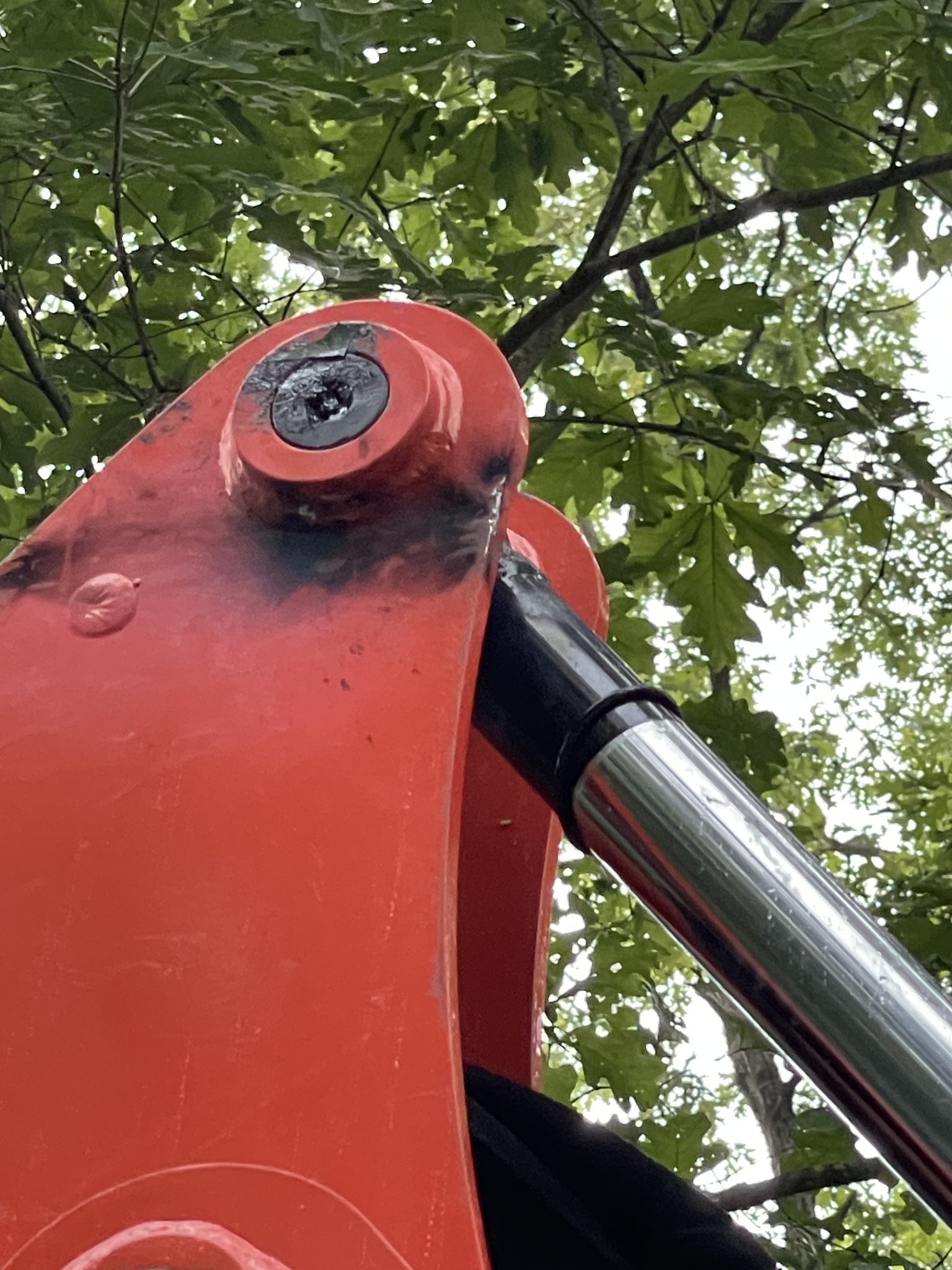

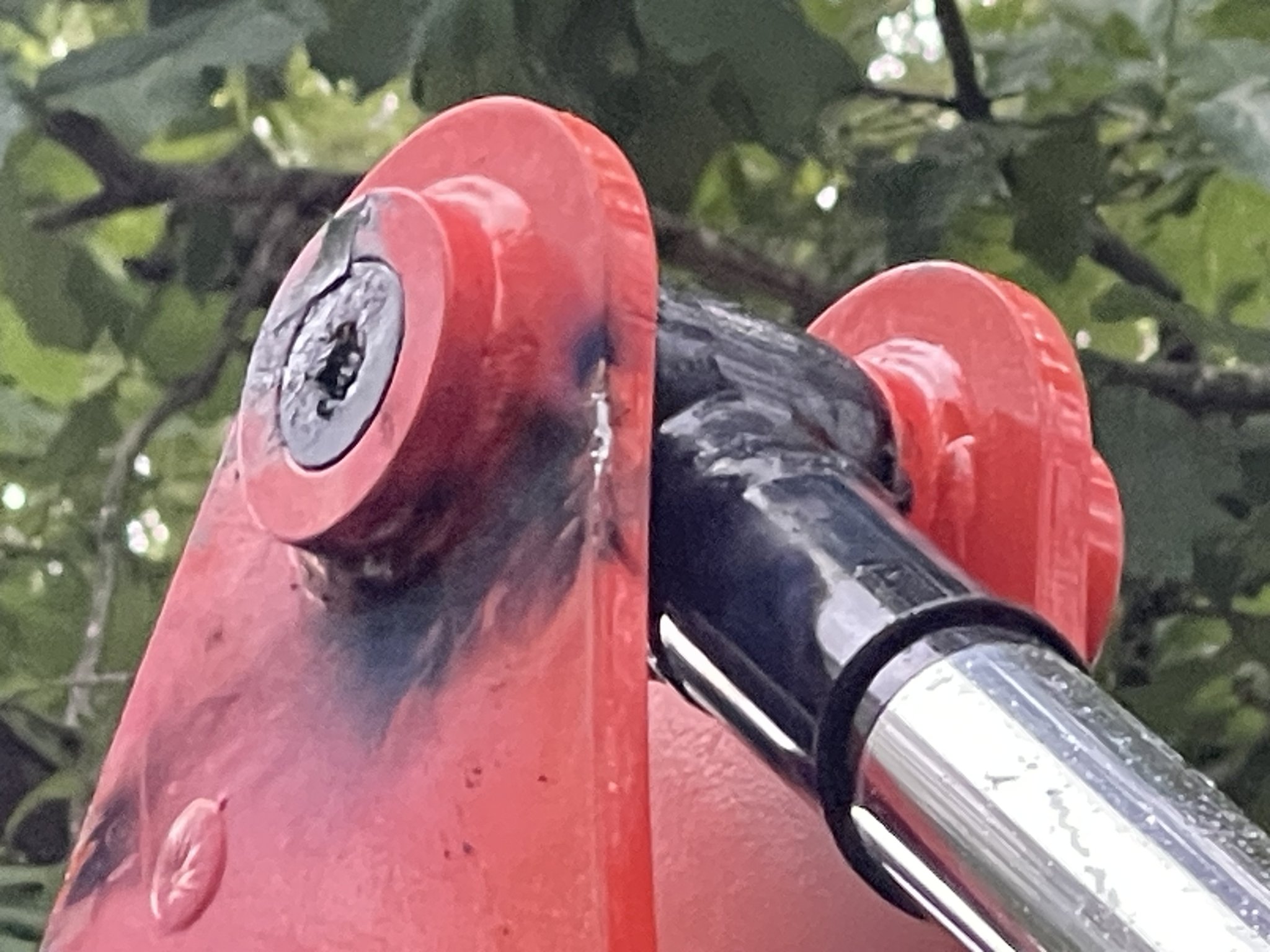

Pic of electrical arc burn attached and delivered implements:

Where the burn scar is, I would have them remove and inspect the pin as electricity has a funny way of destroying bearings and pins. Lighting strike on a pickup fifth wheel trailer and within 200 miles all wheel bearings needed replacement. Enjoy your new toy and I find I am smoother on the backhoe running at about 1800 RPM's, but I do not have emissions. Therefore, I don't recommend it for you as the SCR/DPF likes full throttle.
"have them remove and inspect the pin"
YES!

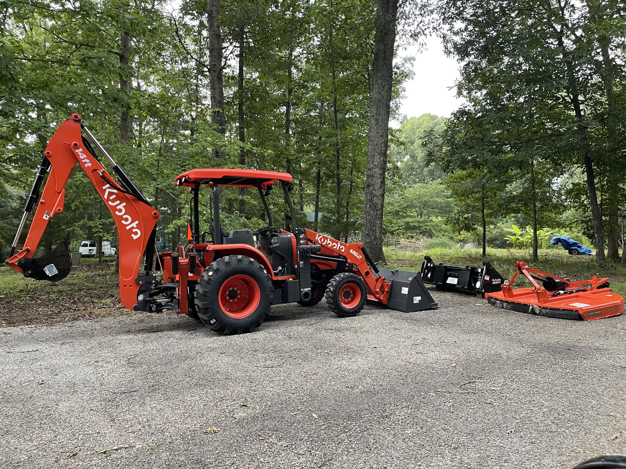

From your pictures, it does appear that you DO have the BH bucket quick attach system.
You will be VERY happy with that.
One caution though.
The BH bucket system has a long lock pin, with a lynch pin to secure it from sliding out.
Take that OEM locking lynch pin out, and throw it as far away as you possibly can!
Replace the lynch pin with a common bolt, and two nuts, tightened against each other.
Thus, you will need to carry two small open end wrenches if/when bucket swapping.
Why do this?
If the OEM locking lynch pin is used, it will find a way to fall out of the long bucket pin at the most inopportune moment.
The long bucket pin will then fall out, and you will likely find it next week,.... or maybe next month.
A new bucket lock pin will cost over $100 with shipping, and you will not be digging again until UPS gets the pin to you.
Ask me how I know this!
I actually was lucky,......I found my pin quickly.
One caution though.
Why do this?
thanks, I saw that! appreciate the heads up!
