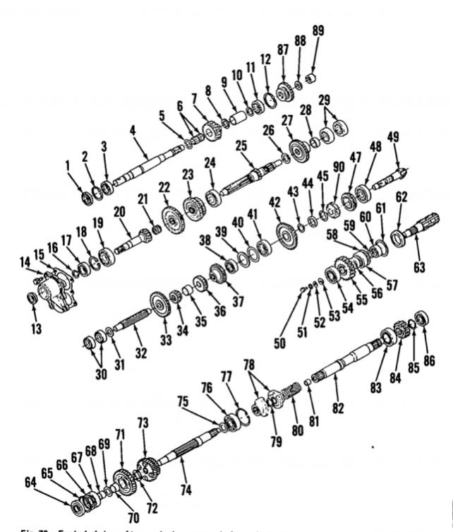

So it looks like I need to R&R the reverse shaft. Anyone with experience getting into these transmissions please chime in and let me know how it went and how difficult you think it is and any other gothchas . I started looking for a new reverse shaft and noticed there are two different potential part numbers (66611-14814 @ $116, 666110-14812 @ $52).

I will have to dive into the transmission layout on the B7100, as with my transmission in my L the reverse shaft is for that, reverse, not for running the front propeller shaft. :confused:
I was confused by that too, and I could still be wrong. The conclusion that I came to was that the reverse shaft is used for the front wheel drive in addition to reverse. I am attaching the diagram, #4 is the the reverse shaft and #87 is the front wheel drive gear.

I wouldn't buy any parts till you get it opened up and can see for sure what's in there.
One piece of advice, there are a lot of parts and there orientation and placement is crucial to get it to work right, I would have a good flat table set up and as you pull parts lay them out exactly as you pulled them.
And take lots of pic's too.
