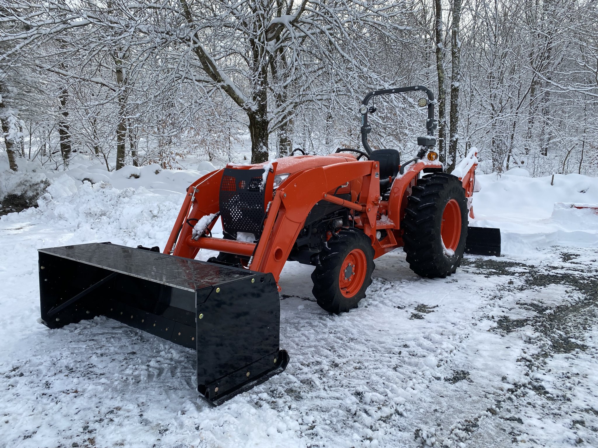

I use a snow pusher and a rear blade. The pusher is just for straight lines and fills up and ya gotta dump it by steering off the side driveway. The rear blade can be angled and you can drive over the snow and just throw it to the side over long distances.
These work pretty well for me, and are less expensive than angled plow blades or blowers. And the back blade is a good relatively inexpensive grading implement (non-winter dirt a d gravel use).
If I were in your shoes, I’d try using a back blade and the bucket for the first winter and see how it went. The snow pusher is definitely faster and easier, because you aren’t constantly readjusting the bucket angle after dumping to not dig up the gravel. But if you don’t get a ton of snow, maybe the speed isn’t worth the expense.
One other thing I’ll add, my B2301 was useless with R4 tires in snow. Chains were an absolute must. So far with my L4701 and R1s I’ve done just fine.
Good luck with your search, tractor shopping is so exciting! It’s a lot of money, but you’ll use it all the time, including things you wouldn’t have ever imagined using a machine to assist with before it was sitting there begging to be put to work (and it’s expensive justified).

I appreciate the advice & will take heed. In the pic, what is the device up front in place of the bucket? Never mind, you mentioned it was a snow pusher. Never seen one before.
I'm not sure what tires are standard on the 2502 but I'll toss chains off if needed. My driveway is all gravel so a blade is a must. I'll reach out to you for recommendations.
