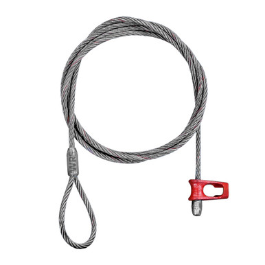

I agree with this, but even better than a chain is a log choker cable. They are made for this purpose and grip the log better. I have one that I found in the woods. They are also easier to hook and unhook and they slide over rocks and limbs better than a chain. I use mine whenever I skid anything: logs, lumber, brush.

Why not use a choker cable instead of chain like the professional loggers do?
Thanks for this link. Been looking for something like this.
Chokers come in various cable thicknesses and lengths. They are much easier to use than chains for log skidding ( it’s all they are designed for).
