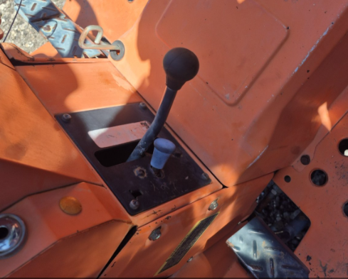

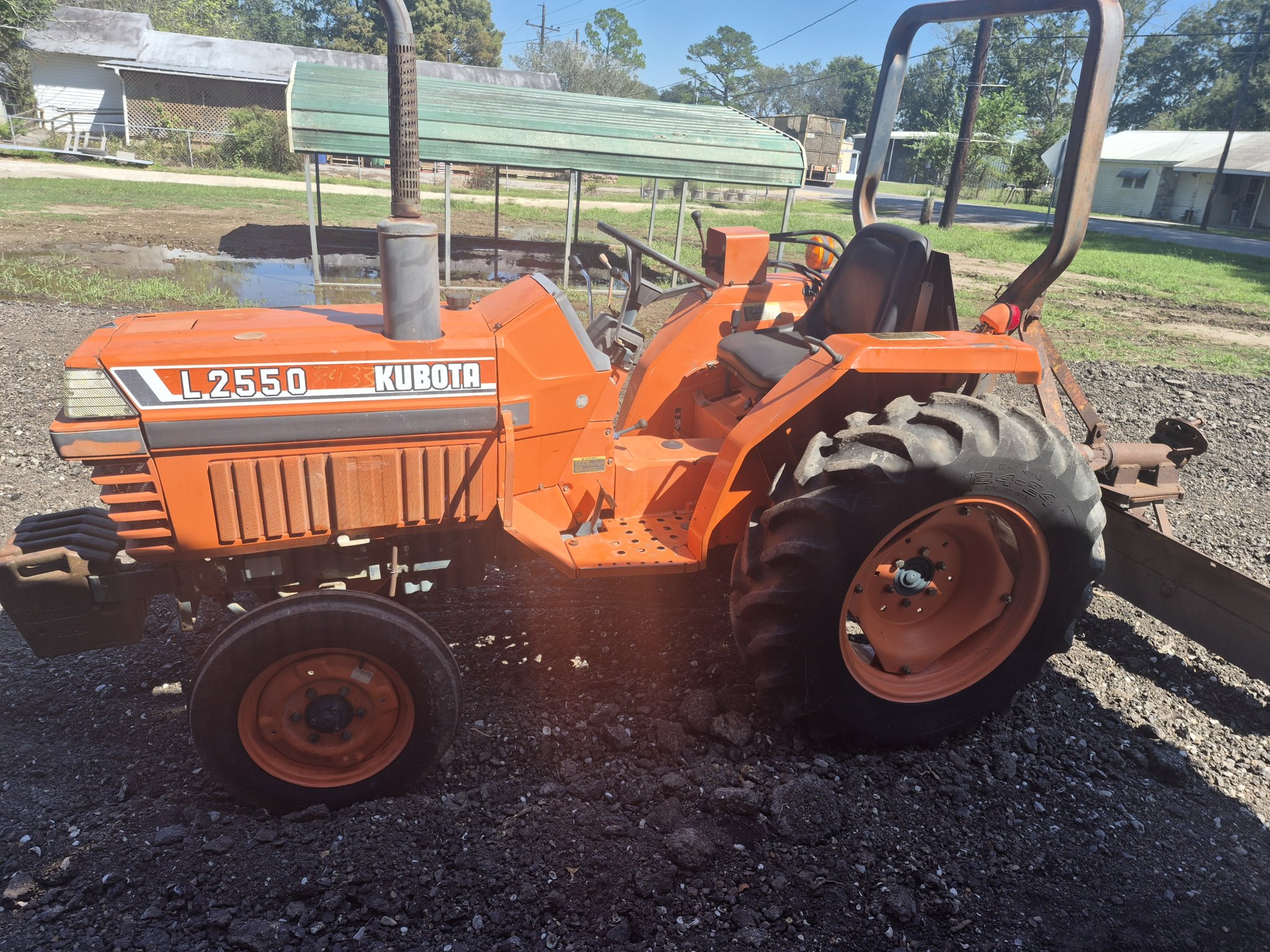

I bought this thing at auction low hours ran great but it's strange there's no PTO switch but when you press the clutch in PTO stops I was wondering if it's one of those kind of strange models that they had for the l2550, everything works great there's also a oem factory 1 remote... hear is pics what yall think

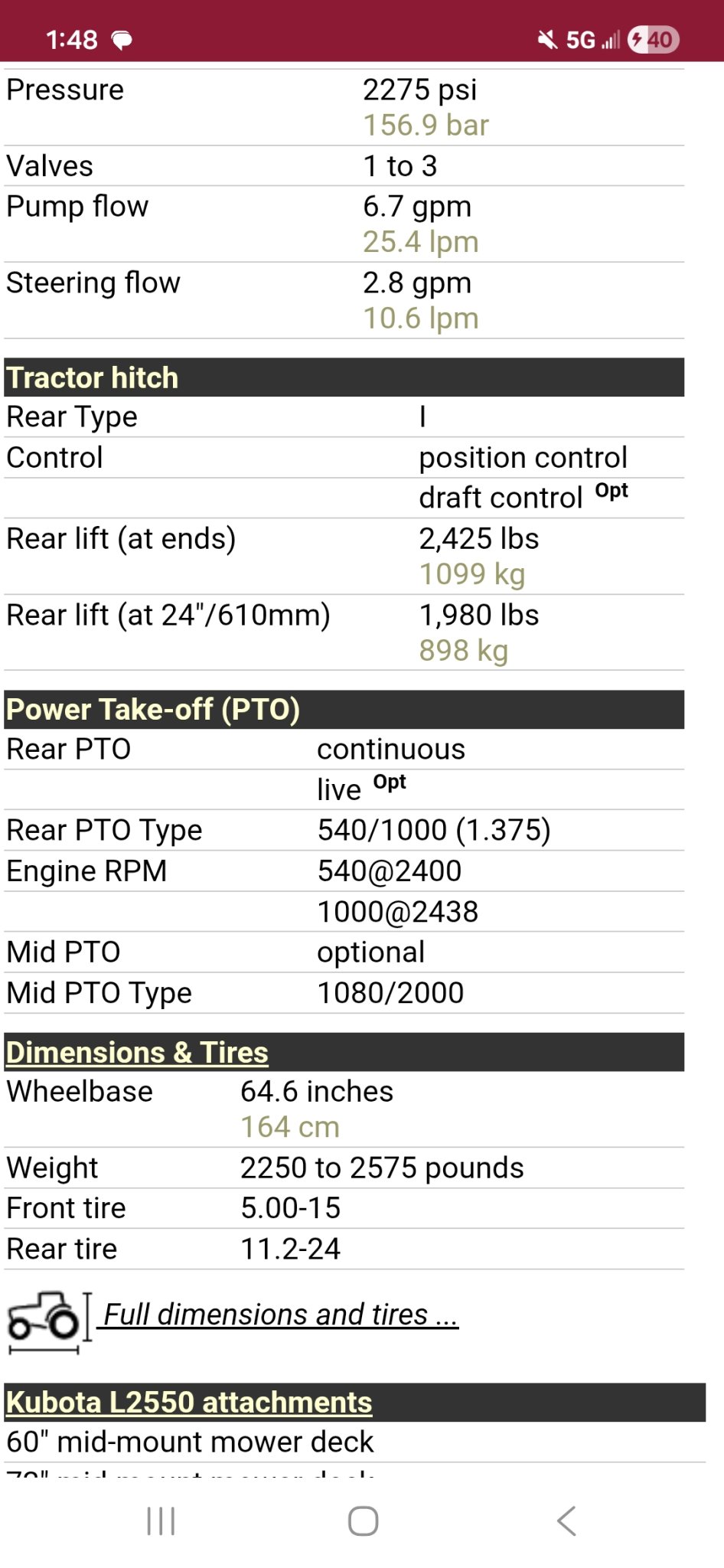

Does the pto only stop with the clutch in, but starts up again when you let the clutch out? Thats normal for a tractor without live pto. Look for a pto engagement lever. Theres got to be one on your tractor.

PTO is the lever with the black knob in the middle. The blue knob is a lockout to prevent the PTO from accidentally shifting.

Not Quite, The PTO on that model is a 2 speed PTO, the blue knob is a lockout to keep it from shifting into 1000 RPM without overriding it.
