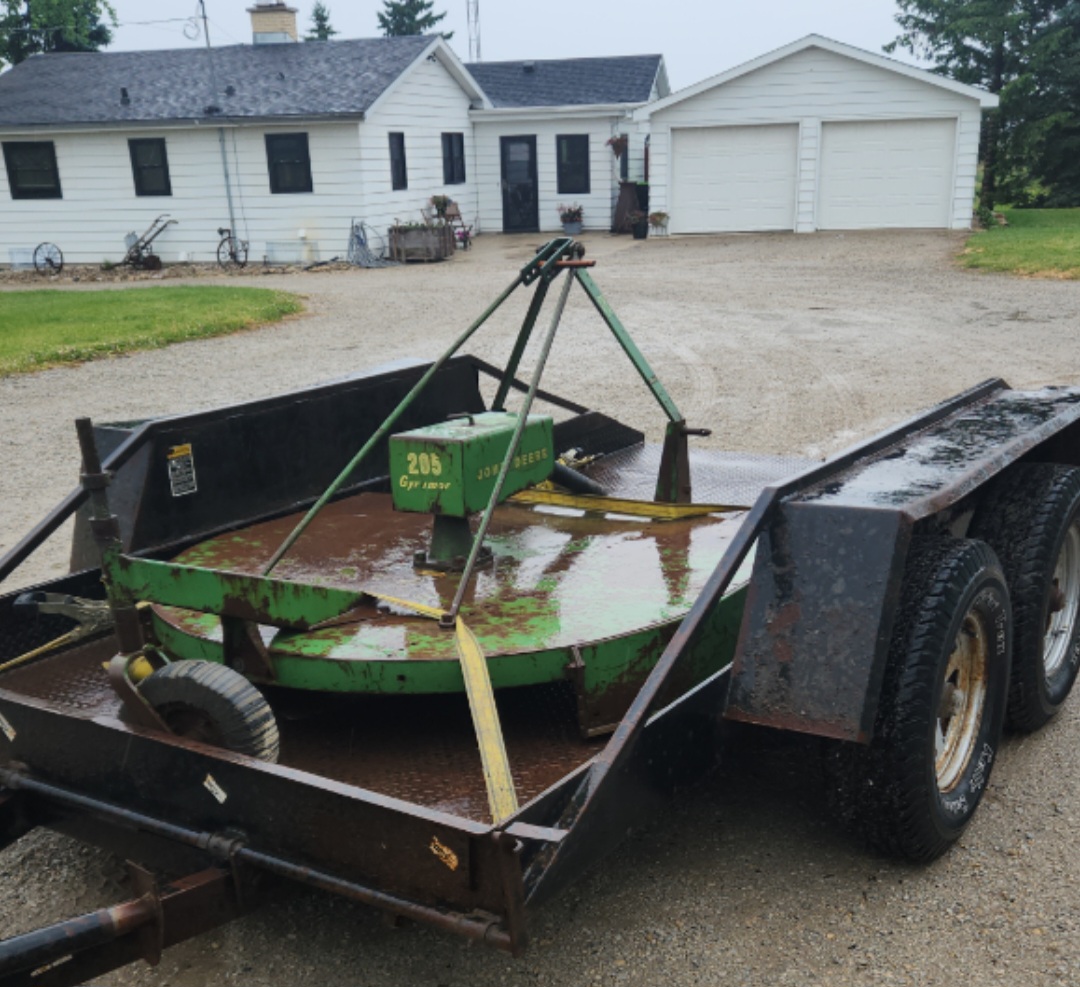

After purchasing the kubota I've been in the market for a brush hog to mow atv trails and knock down corn and sun flower stalks. I've been coming up short on my hunt, either getting outbid on auctions, finding no name brands with parts n.l.a, finding light duty brands, or finding over priced twisted, rusted out, piles of junk. I came across this John Deere 205 gyramor for a more than fair price. I was waiting a week for my auction check(I didn't want to offer money I didn't have or ask him to hold it)Unfortunately when I called the nice gentleman said someone was going to come that afternoon or next day to get it. Well the guy was a no show no call. The seller tried to get a hold of him 3 times, and decided to give me a call. I'm making the 1.5 hour trip today in the rain(won't complain about it) to pick it up.
It's a 6fter and being used on my lx2610. From what I read the kubota should be able to handle it, just keep it reved, maybe keep it high and work it down and go slow. I'm really eager to try it out.

6’ is a lot of mower for an LX. That price is right, though. I had a LP1860 on my LX and could bog it down at will. I have a 6’ bush hog brand on my MX6000..

Too wide and too heavy for your LX.

I am pretty sure a Deere 205 is a 5' cutter unless they made a "special" model, The one I used a long time ago was a 60" cut. It is heavy but your tractor should handle it fine. For heavy stuff you will have to slow down and/or raise the cutting height.
I have a Deere 5' on my Deere 955 (27hp PTO/33 engine) and it will go through really tall stuff at the right speed.

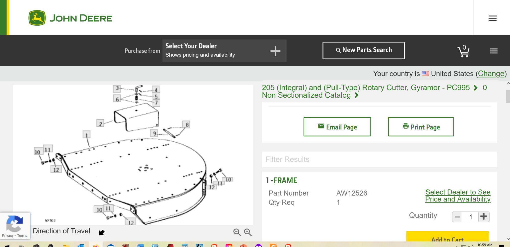

Interesting because Deere parts site lists only a single frame and a single blade holder for the 205 cutter, three different blade options are available but all are the same length and differ only in whether you want high suction or hook blades. So if there was a 6' unit it must have been a very short production run that is no longer supported with any parts that were specific to it.

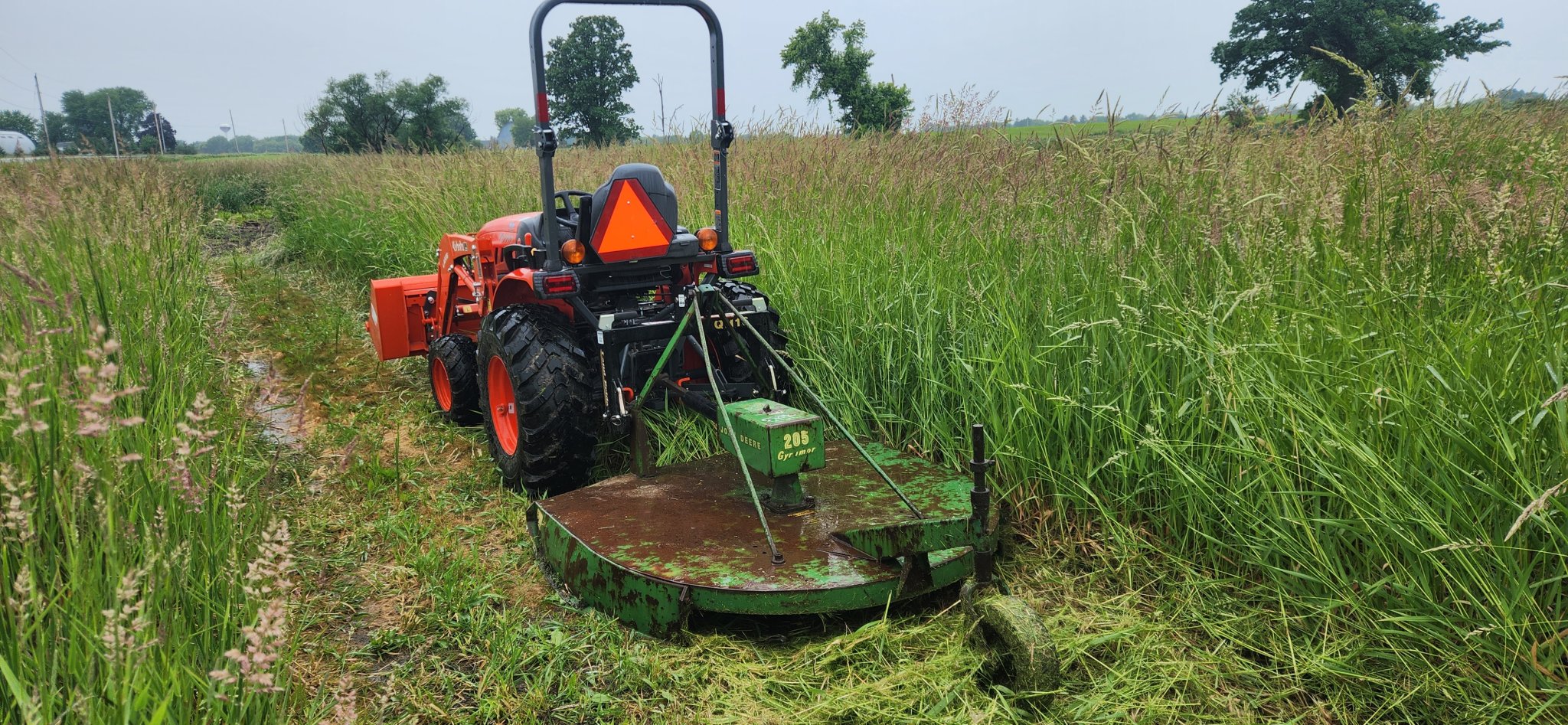

I picked up the brush hog with no issues...... didn't end up on a meat hook hanging down in a basement......always a plus.
I got it home alright too.
Those that mentioned the width you're correct it is only a 5fter......classic case of the seller not knowing what he had. As soon as it was placed on the trailer I could tell......I could've brought a smaller trailer then and saved some gas.
Those that mentioned the lx couldn't handle it for pto, or weight. I'm just curious for my own knowledge the facts or data of it. I want the right implement for the right tractor to prevent any injury or equipment damage so it'd be nice to see that data.

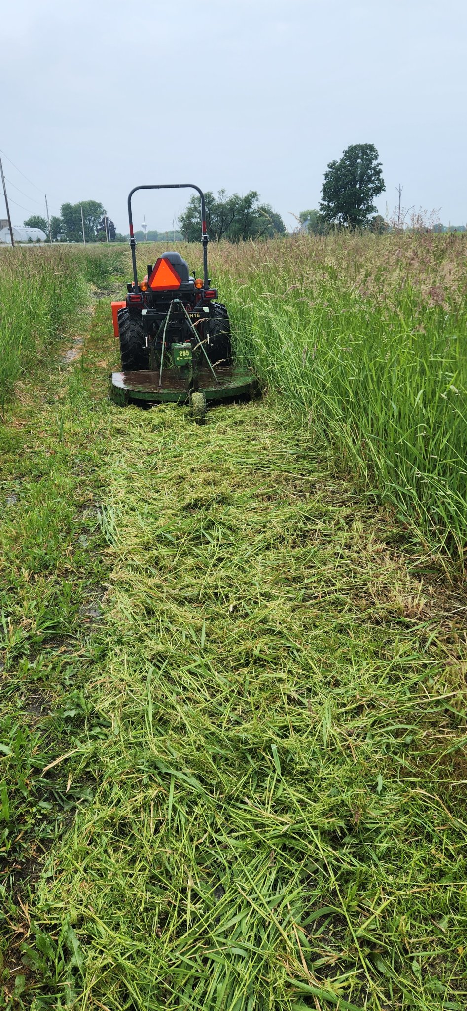

I lubed everything up, checked it and tried it out in the rain.
I have the front end loader on yet for dirt projects and wanted to use that as a feeler doing some test runs. I really couldn't tell of any extra weight on the back........nothing more than my tiller. The back wheel is back there for a reason too.
I was mowing grass and cat tails that were over the hood.
I was in medium accidently and was going along fine. I kicked it down into low in the thicker stuff and only once did I have to raise up and I think that was more so un even ground. I felt more comfortable in low anyways running a machine I had zero history of.
It did a nice job for being wet. I think like anything the right speed plays a factor, if you try to mow in road gear foot to the floor you'll have issues, or trying to knock down 8 inch diameter trees you'll wreck your equipment. So far no regrets. I looked at many different brands. King kutter, lady & son, howse, and nothing compared to be as heavy duty as this is. If I had the funds I would've gotten a new landpride though. At the dealer the attachment promo was only good for 3 attachments too.
In the shop to get cleaned up and somethings adjusted.
