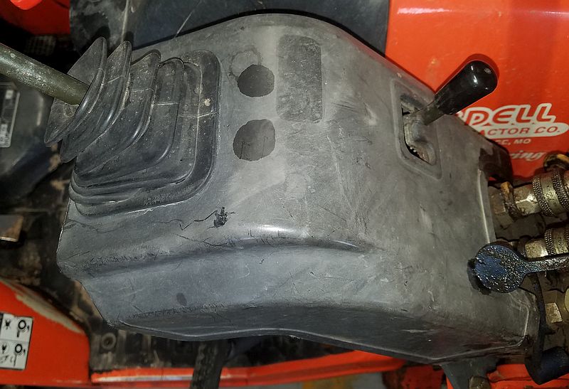

Next question -
Attached is a pic of the loader control. What' the lever with the black handle in the upper right of the picture?

If I am not mistaken - that is a "lockout" -- throw it into the other position and the joystick will be locked out
