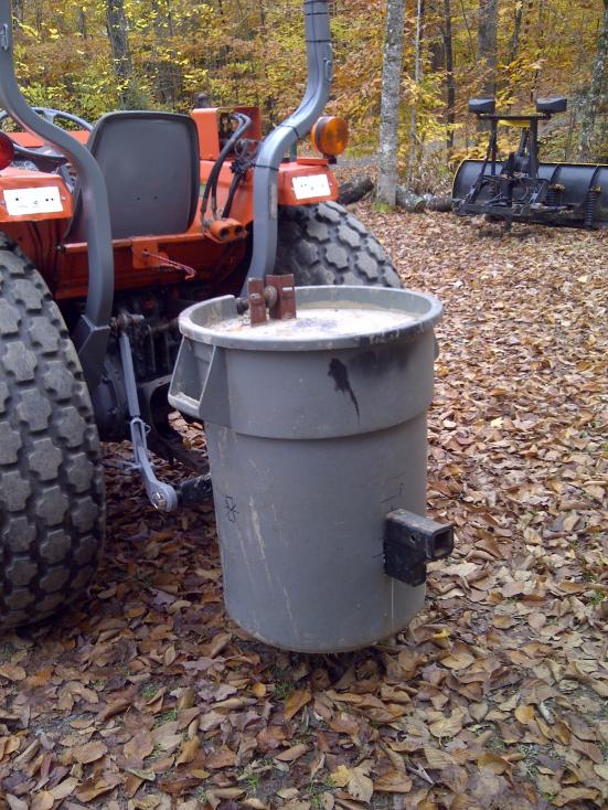

My first day with mine I tried to pick up a big rock on a small hill, the back wheel came up over a foot off the ground. never been so scared in my life.
I immediately went to work on a counter weight. I am no where near alot of the guys on here for quality but it works great. a draw bar through a 55 gallon rubber maid can with a little steel and an old trailer, hitch then filled it with concrete and weighs about 1100 lbs :)
