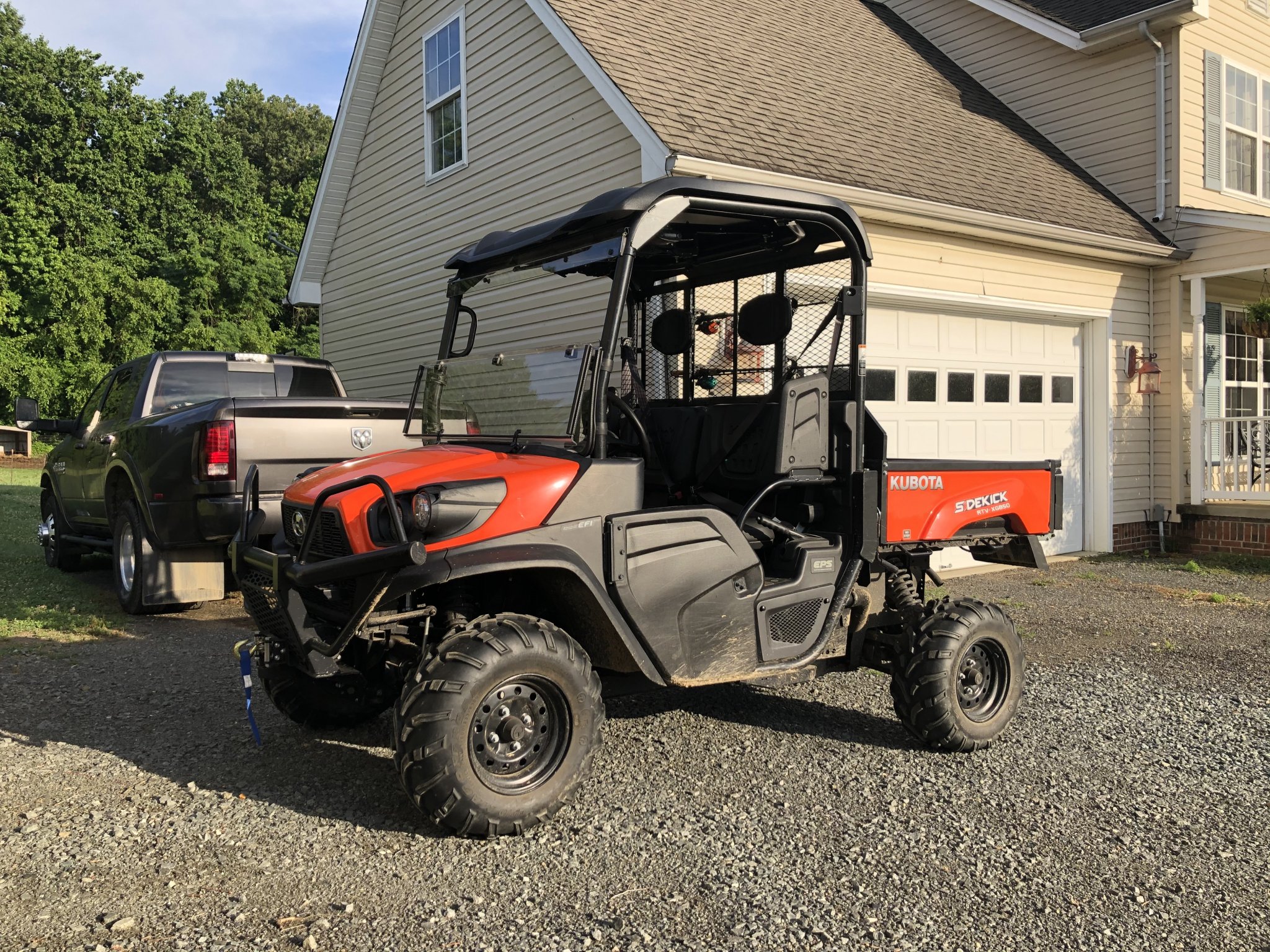

Howdy All. I was in need of something to pull a trailer and haul dirt roots and just what ever. My local dealer had an Orange Sidekick XG850 at a price I could not say no to. The only option I wanted it did not have was the hydraulic lift bed. Is there an after market one I can get, or a way I can make this one power? I know with money all things are possible, but I would like to keep this on the cheap cause I told the wife this is hers and she will be running it.

Love mine! FWIW, the hole in the dash for the Kubota switch to dump the bed is not a standard size for switches. I cut the blank panel out thinking I'd put my winch button there and had to use a different hole or cut the hole even bigger. I choose to use a different hole in case I ever put the dump kit on so the dump button will still fit. All the other switch holes have blank panels in them and they pop out of the panel easy. That should have tipped me off before I cut the blank out.:(

I found one that would work, not sure if I posted here or another forum...I think there is a member on here that installed it..

Mine had to go in and get the bed replaced because all the Lin-x stuff they used was peeling off as well as a few welds broke. I purchased the lift kit and the dealer installed it for free because it was there and taken apart already. I am waiting on the new tail gate before I get it back.

NOrthern Tool sells “linear actuators” which run on 12V and are easily installed in place of the hydraulic cylinder to operate that bed-lift and have the lifting capacity to do so for less than $200. While I‘ve not yet convinced myself that I need to do it... as I grow older ... manually lifting that bed is becoming more and more difficult for me, especially after I added a school-bus seat to the bed. It’s a planned project for me. Some day. Maybe. Perhaps....
Thats me. I bought a linear actuator from Shoup and installed that. Just measure the open height and get an actuator with that extended length. You'll need to make up some brackets and run the wire but it's all pretty simple and way less than 800 bucks. More like 300 total and your time.

562

562
