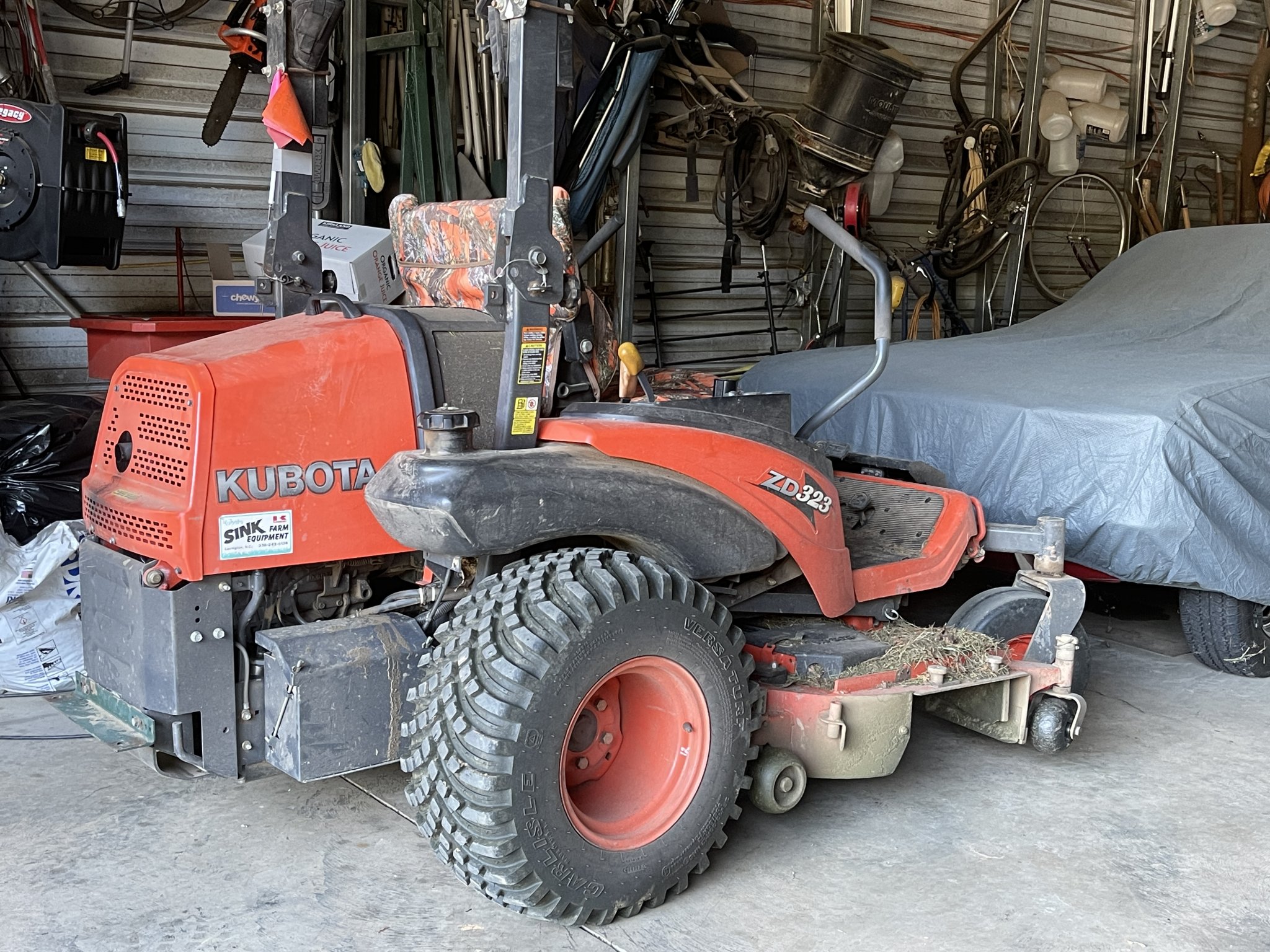

My 10 acre property has a 90' drop in elevation from front to back. It start with a steep hill that drops 40' levels off and then drops another 40'. Mowing downhill on my zero turn was doable unless the grass was wet from dew. I had a few white knuckle rides. Two years ago I installed Carlisle Versa Turfs on my zero turn (Similar to R-14). The added traction really improved the downhill stability as well as side hill stability. If you purchase the zero turn first as recommended see if you can get the Versa Turf type tire instead of the turf tires. Several lawn care guys in my area are using the Versa Turf tires.
