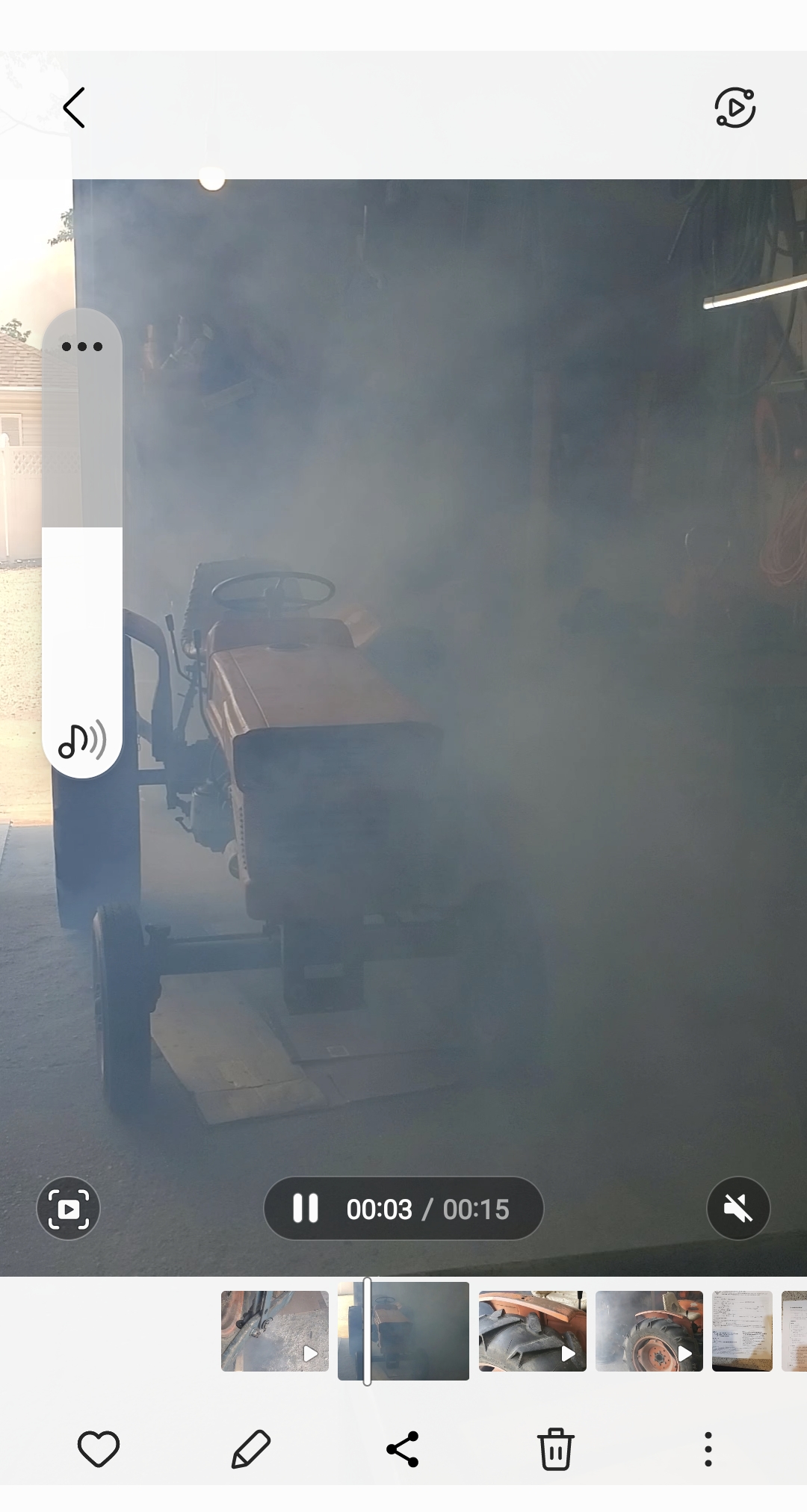

Here's the beast running...although I did let it run for probably 20 minutes and the smoke did lessen...IDK but it sounds like an exhaust valve isn't right...don't know if you guys can hear it...
Guess I can't show the video...can't find how to attach it...sorry.

You can post the video on your favorite YouTube or similar site and the put a link here.
But that amount of smoke isn’t right.
Start by getting a diesel engine compression check kit that will have an adapter for the glow plug ports. I would recommend you buy new glow plugs and get a deep thin walled socket that fits them and install the new ones after you have done the compression test.
I am assuming your tractor is fairly stock, the glow plugs are wired correctly through the indicator and you know how to use them correctly. But that probably won’t help with the smoke (after 20 minutes it should have been warm enough that the glow plugs would not help it start much).
You may want to replace the injectors and their seals (from the dealer or Oregon injection repair) to eliminate them as the problem if you want to spend that much money now without much troubleshooting done.

The guy i bought it from said he put new glow plugs in and they do look new and they do work. I don't know if it's stock or ever been overhauled, but that much smoke i would say not...
Might be a winter overhaul project...and i wondered about trying injectors...
