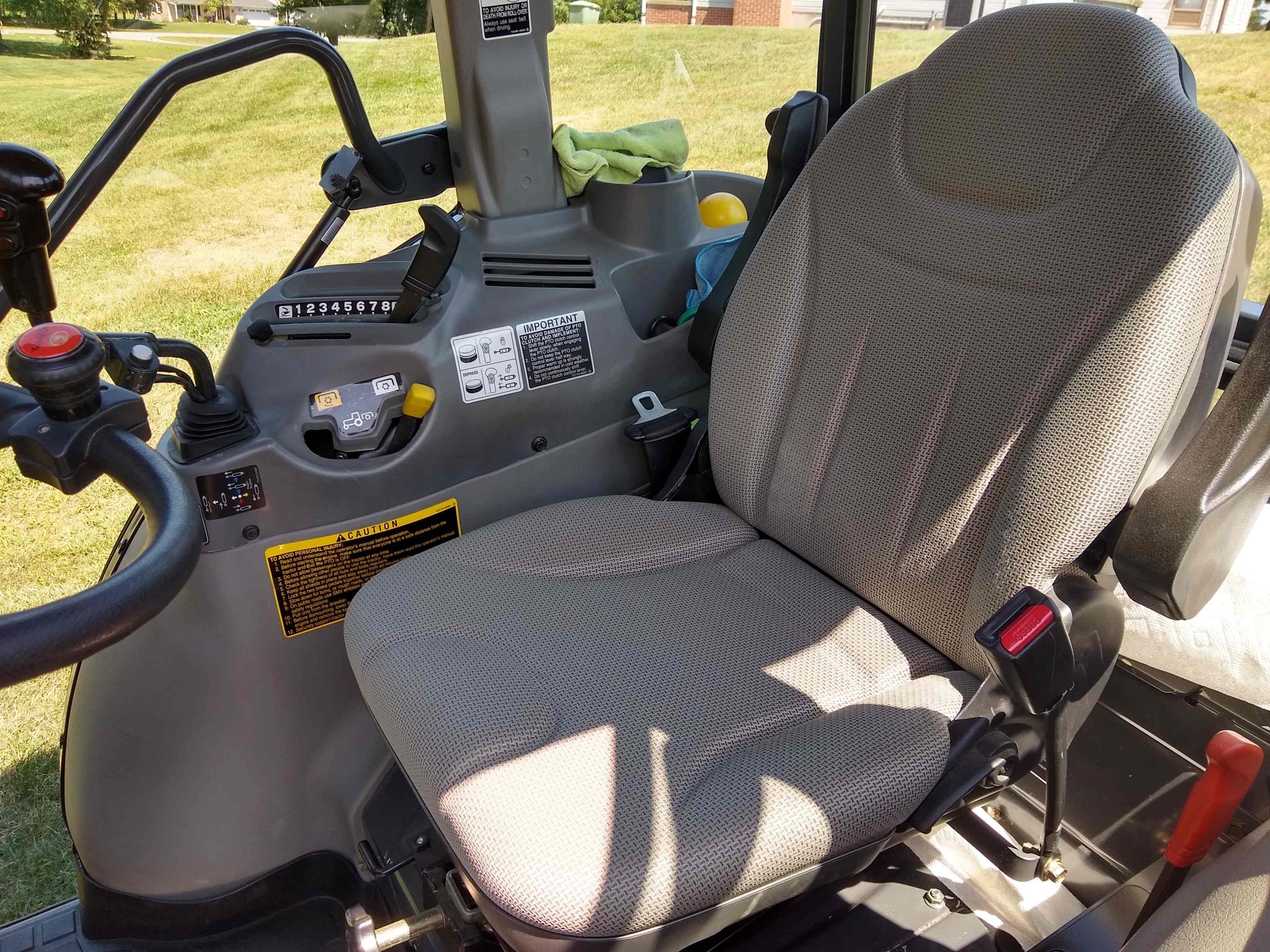

Get the best seat you can afford ...

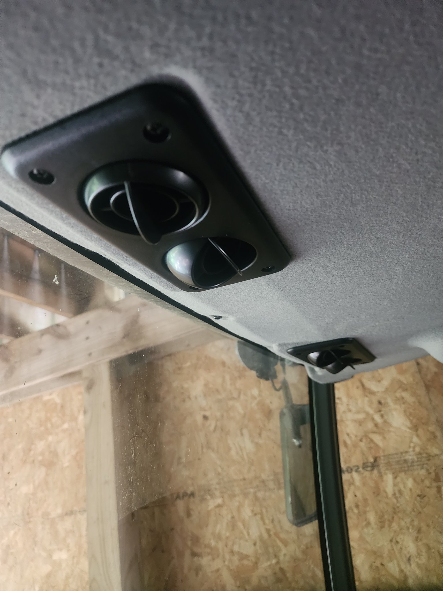

Front Def is as others mentioned, round vents in the ceiling. It works well.

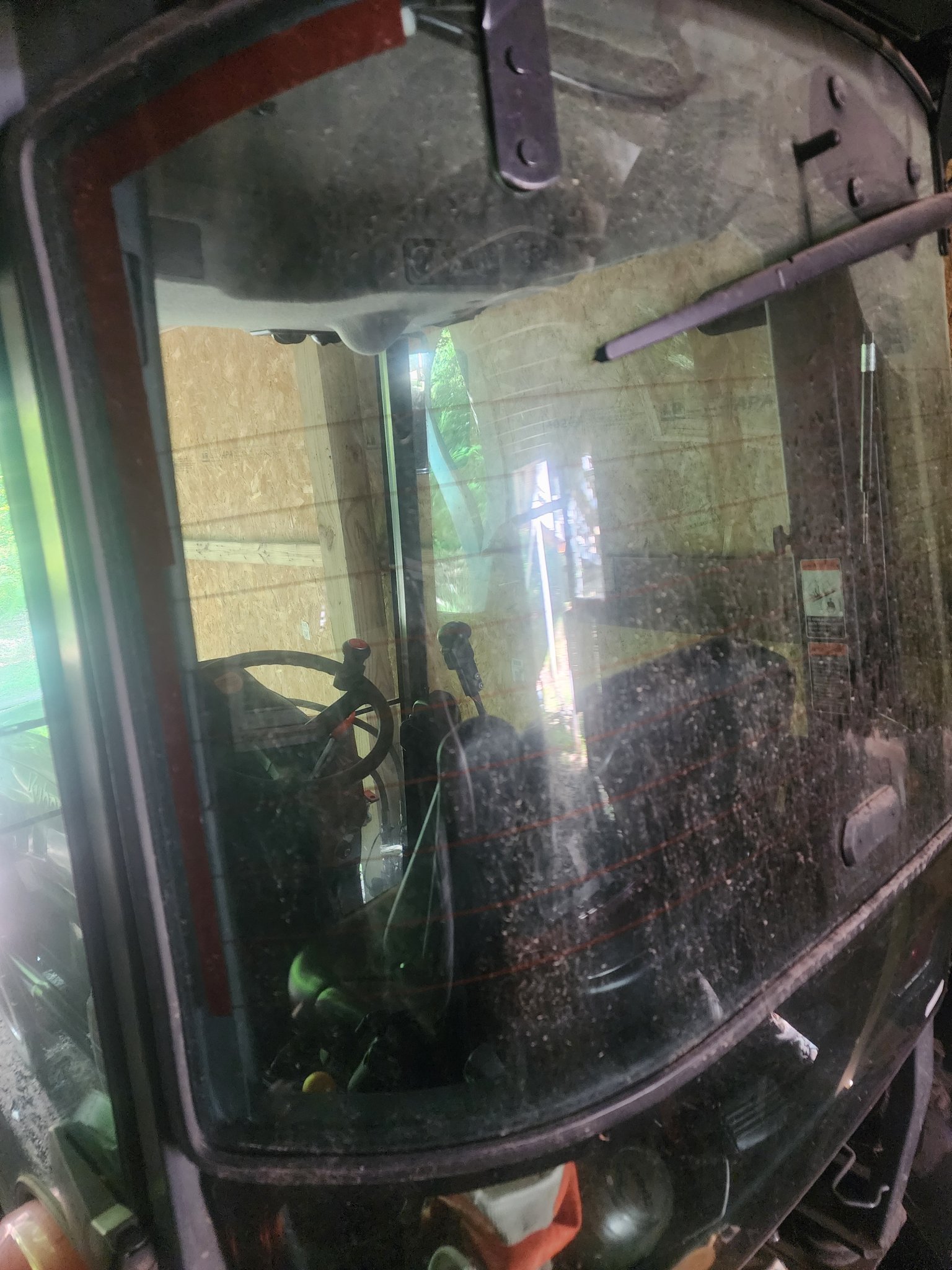

Rear defrost is a switch on the dash like a car. Element lines in the glass.

Front defrost vents:
Rear window with defrost lines:
