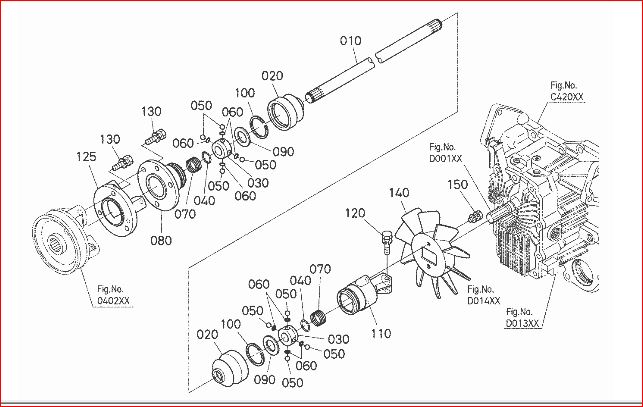

Yea your talking about the 2 CV boots (#20's), they are a bear to change.
But with a little work it can be done right.
and the cost of not doing them up right could be very costly as those 2 joints and shafts are not very cheap to replace because of wear from dirt getting into the joints.
Kubota doesn't skimp on 1/2 repair parts because there is no logic in not repairing it back to the exact condition that it was designed to be. ;)

From the looks of it you would have to take the whole body off to get to them,,,,:eek:
32,929
8,380
It can't be that hard to do on a BX. :rolleyes: ;)
I can have my L body striped, split and trans pulled in about 4 hours, but then again some think I'm a little off, and I think they are probably right! :p:D

yes wolfman that is the parts breakdown i have and part #20 sitting on my work bench x 2. I will have to have another look at it, maybe i can take it apart and change seals by removing hdro instead. Anyone done this job before. thanks
