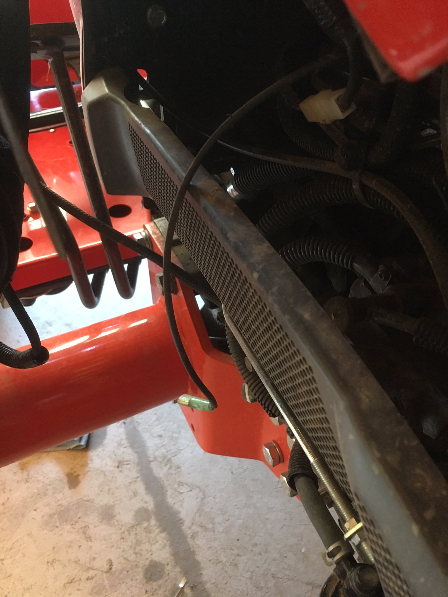

There was one small stain on the concrete I noticed underneath your right foot where the hydraulics all meet. I did have a third function added by the dealer. Maybe there is a small leak. Well, I don't know how this all works so maybe when it is operating it is more than a small leak under pressure and when parked it is barely anything (maybe 1-2 tablespoons since yesterday).
Nicfin36
Jun 19, 2019
1,018
470
Decatur, AL
That is where mine had a fitting spin loose and dumped most of my fluid. It was probably not tightened properly when the backhoe plumbing was installed on mine. It would not hurt for you to check to see if they are tight. Just see if you can tighten them. You don't have to go crazy on them. I think I had about 10 hours on mine before it happened.
