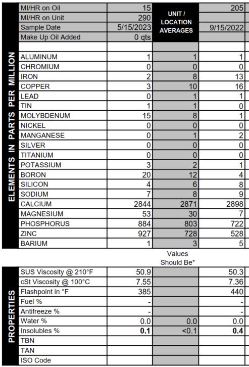

  • We noticed at about 200 hours that the hydraulic oil on our new M62 looked less translucent than we were used to - did an oil change and it looked pretty awful (see previous pictures).
  • Sent it off for analysis (see attached) September of 2022 and it came back with the insoluble’s four times over the upper limit.
  • Kubota helpline was completely not helpful. Out-of-state dealer that we purchased it from also not helpful.
  • Kubota says the hydraulic systems of new tractors ARE NOT flushed prior to delivery.
  • Did two complete changes of the hydraulic oil and filters ($600) and then sent the tractor to the nearby dealer for an “hydraulic washout” - $600 transport fee - when the tractor got to the dealer we found out that the washout would not be covered under warranty and would cost thousands of dollars.
  • Regional representative told dealer that this is normal for the hydraulic fluid in a new Kubota tractor.
  • Paid for another complete hydraulic oil and filter exchange. Now insoluble’s are just slightly above the recommended limit (see attached).
  • Blackstone is recommending another change of the hydraulic oil filters.
Questions?
Has anyone had a similar experience?
Any idea what’s going on - is this normal?
Should we change the hydraulic filters again?
Should we change the hydraulic oil again?
Thanks in advance for any advice.

Was the fluid and fiters changed at 50 hours, if it didn't look bad the something happened between changes, was any fluid using (besides theFEL) attachments used in that period? As always do as you feel is best but I would do just a filter change (no fluid). Do you have a third function or remotes, if so consider a side stream filter (high filtration) to help remove contaminants. I believe you need more than 15 hours of hard work to ensure everything is getting into solution. Does your hydraulic filters have magnets, anything on them? When draining the oil are you removing ALLl drain points?

I’m not much help, but I can say it is not normal. My L had 550 hours on the fluid and is looked fine, honey colored. My B at 50 hours had fluid that looked the same as the new stuff in the one gallon jug of super UDT2 that I topped up the fluid lost due to the filter change (with the unit still full of fluid). My L runs a FEL I take on and off regularly. It also has a 3rd function that runs a grapple, although that’s a newer addition this spring.
Only someone with a financial stake in the matter would say oil that looks like what you’ve removed is “normal”. It’s any thing but normal. Too bad that guy’s integrity is for sale for the wholesale price of a few (or 10) pails of fluid.
If I were going to change the fluid three times, I’d just change the filters when I was done with that. Mainly due to cost.
As you know, changing the fluid leaves a bit in that doesn’t come out. On my L, the specs say 11.4 gallons and only 9.4 gallons came out and it read full when I started and I pulled all four drain plugs. Based on that, I think my unit would still have about 10% old fluid in it after 3 changes.
Maybe check the case vent to make sure it’s open to both positive and negative pressure variations.
