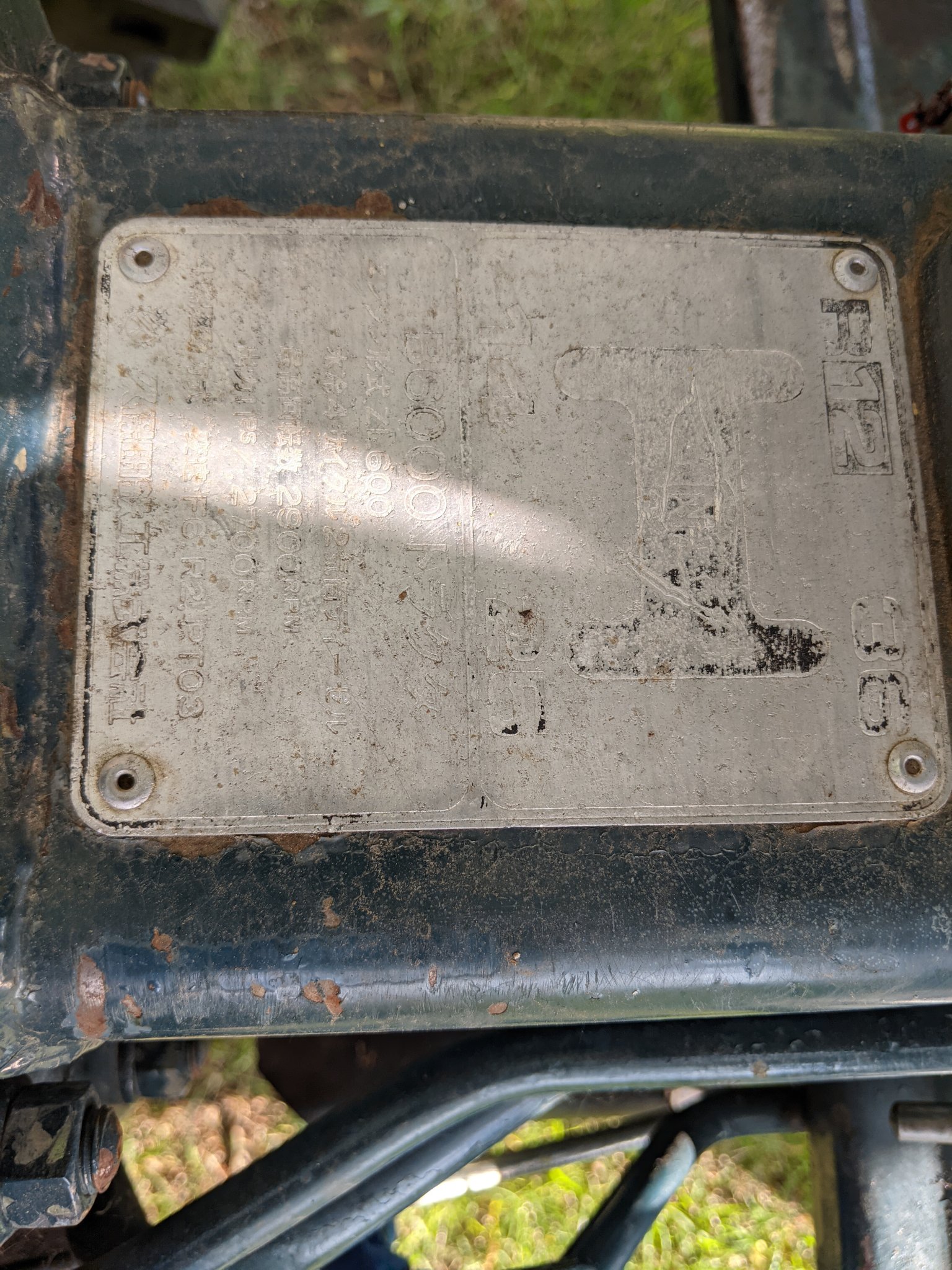

So had a closer look at the name plates and they do have Japanese characters on it... I'm guessing that's a good indication it's a grey market. The serial number is B6000-52631 and there's another tag below it with Japanese text on it.
Is it a big of deal in Canada and getting parts from a dealer being Grey market?

36,870
11,551
If you need to go to a dealer and get parts it's a B6000, don't even mention the grey thing! ;)
It's the only model that was both grey and non grey!
And yes that one's a grey!

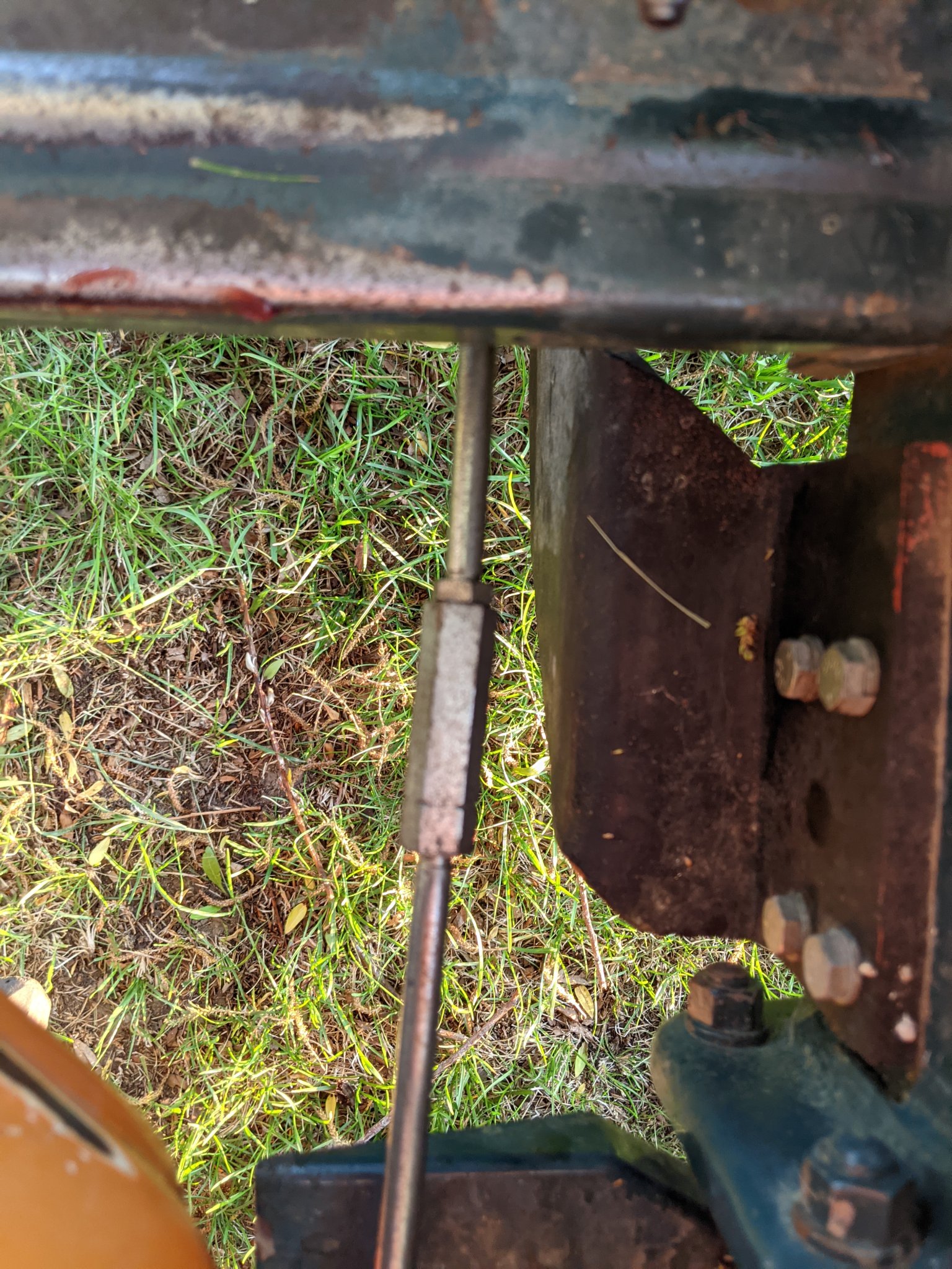

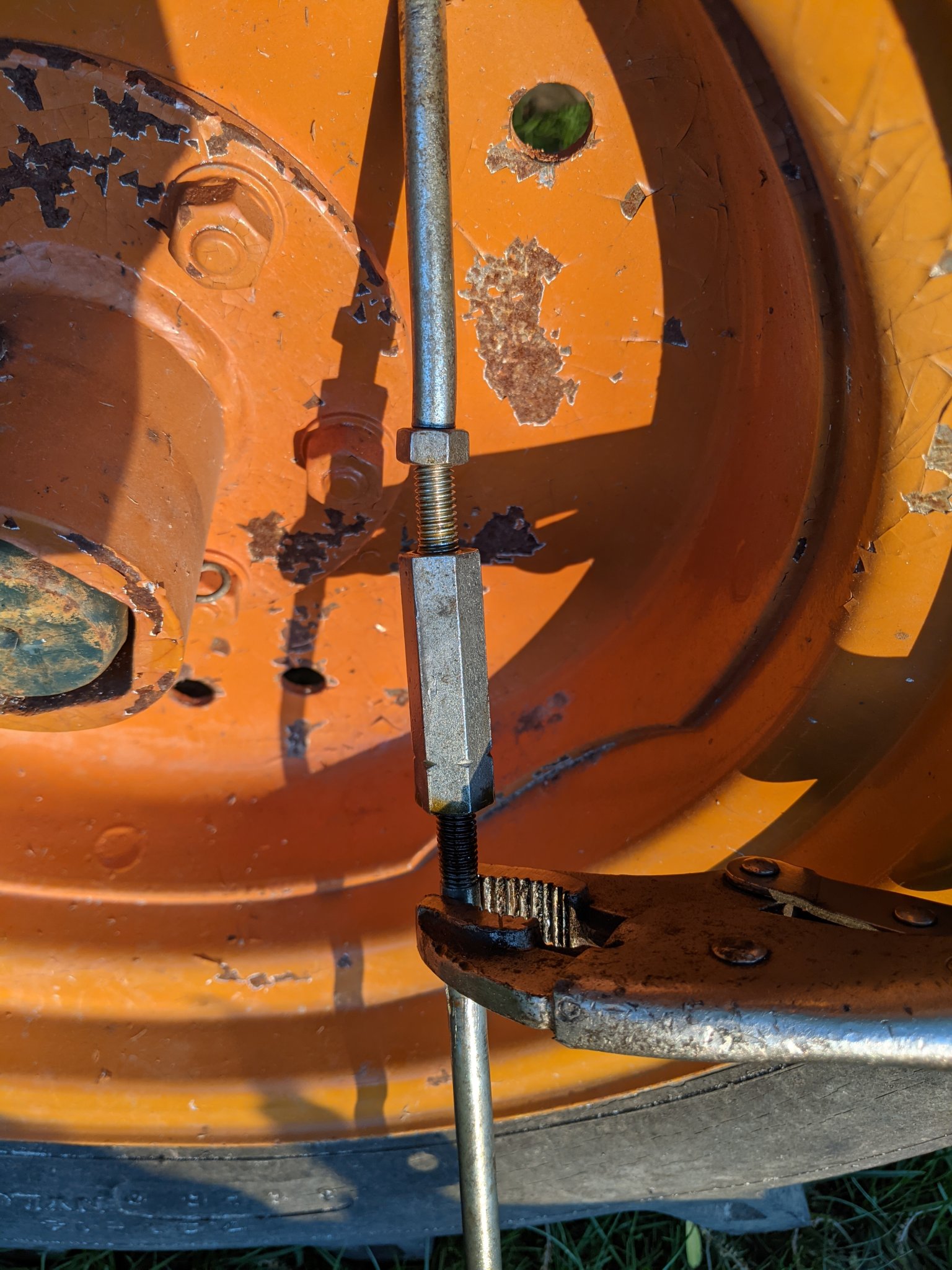

Last night I got the left side brake adjusted all the way in and it feels like it might have some bite.
The right side turnbuckle is still seized on one end. Took the other end out and filled it full of PB Blaster so hopefully gravity will do the work. It feels like that small diameter rod will be really easy to twist in 2 pieces with too much force.

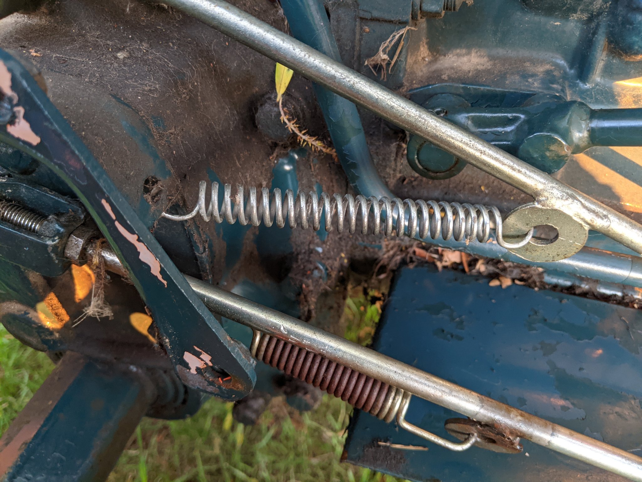

I also noticed that the diff lock pedal return spring was missing so I found one in my bucket of springs that was about the right length and felt like the correct K value so I put it in there. I have a few more to try if that one doesn't work.

PB Blaster is sorta OK, but "Kroil" is the very best.
Lots of folks here on OTT will agree.
It is not easy to find in the USA, and likely nearly impossible in Canada.
If you do find it, (Home Hardware, or NAPA?) the price will drive you insane!
You can mix equal parts of transmission fluid and acetone, for a near substitute.
Acetone evaporates very rapidly, so lacquer thinner may be used as a substitute for that.

Thanks for the tip on Kroil. I've heard that brand mentioned before. And yes it is hard to find up here.
If the PB Blaster doesn't work I'll try the ATF and acetone mixture. I don't think it is *that* seized in there all the other ones turned fairly easily.

It's fine here as there are as many B6000's Grey's as non greys and they are all the same, no real variations between the two that I've seen.
Should have listened to my own advice.
Got it turning a little bit. Got tight again so I turned it back in. Went to go back out again and she snapped.
Since it's the left hand thread side and pretty sure it's metric threads rather than getting a tap for it I had a welder at work stick it back together.
Hopefully there's enough adjustment in the other threads.
I'll just have to pull the pin from under the pedal to make the adjustments. PXL_20230526_093233241.jpg
