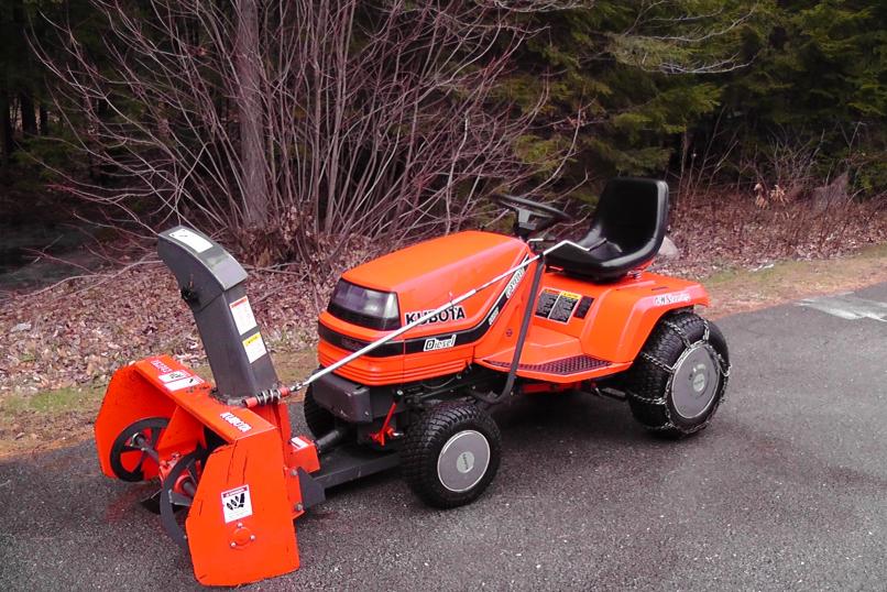

I've been looking for a year.... I did find a diagram of the optional kit.. One dealer I spoke with remembered installing one way back in the early/mid 90's. There was a diverted valve that switched between the rear "3pt" and the mid lift cylinder. It had no down pressure... It was also a 900 dollar option....
I have fabbed up a rear Reese style hitch and have all the parts for my own design cat 0 three point. I have aquired many different hitch setups from old brinly sleeve hitches and craftsman. I haven't had the time to finish it. I had a thread in the fabrication area where I built a front snow blade from a 5100. I tapped into the hydraulics and left myself an extra port on a manual three way valve I bought. You are probably going to be better off to either find or make a front blade. It will be easier and work better as long as you can get enough weight on the ass end. I filled my tires and made a 150lb weight plate that slides into the rear hitch I made. The original g series snow blades are very cheaply built. They are all bolted together with very thin steel. I looked for about a year, ended up finding that Hyd front blade and made it work. Then after all the work I found a front snow blade for the g series (g2001 iirc) and was very disappointed in how weak and cheaply built it was.

Steve, it seems that from what I've read this hydraulic 3 pt hitch is very hard to find. Luckly, my son and a close friend are pretty good welders/ fabricators so I will probably have to make something close to the real thing. Nice job on the plow!
