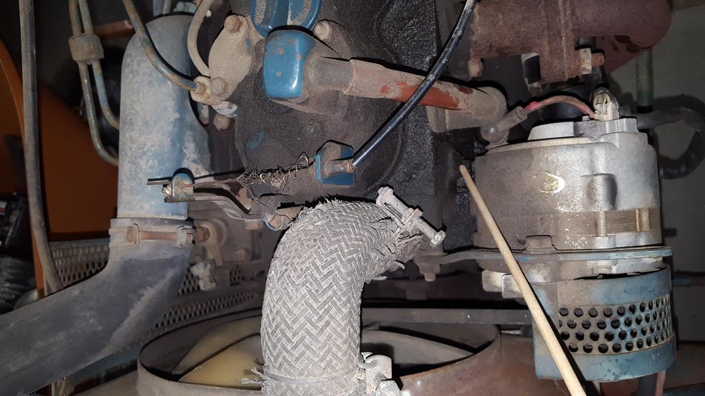

I've had it a short while and as you might expect, a tractor this old has some issues. My very recent problem was oil pouring out of a side port (of some kind) right behind the alternator. There was no anti-freeze in the oil so I'm hoping this is not a head gasket issue. I've included some photos.
Can someone please shed some light on this problem if you've seen it before and what I'm looking at to fix it. All of the gauges on this tractor are not working and I'm certain I would get an oil pressure light, if one existed. This is the first sign of any oil coming out from this location and I'm puzzled to say the least. Thanks for any help you can give ... and thanks again for having me !

Hello youself and welcome to OTT. I know nothing of your experience level or experience with that tractor but I've had a similar issue with my old Mitsubishi. It will magically create oil and fill its crankcase to the point where oil pours out the dipstick hole. On my tractor this is caused by a leaking shaft seal on the hydraulic pump. If I replace the pump or the seal the problem goes away. This may or may not be your situation.

I am not familiar with that tractor but if Diesel, is the "lift pump" diaphragm broken/cracked and allowing your crankcase to be filled with fuel causing the overflow?

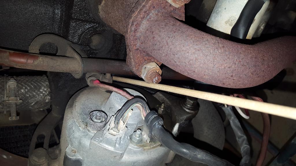

Thanks for the response guys. Yes this little 185 is a diesel. I am unfamiliar with the "lift pump diaphram but will look into it and 40dave I will dig into your thread in the near future, thanks.
I have another picture of the "port" now that I've got the alternator moved out of the way. Don't know why my pictures keep turning sideways but hope you guys can get oriented to see what I'm talking about.
Thanks again I will start doing my homework based on your responses.

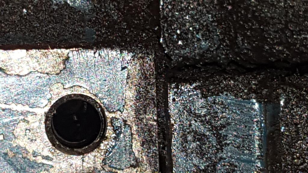

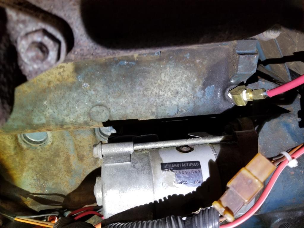

I just took some pic's of the L245 motor in my shop.....I think your oil leeking port/hole may be where the oil pressure gauge used to live????
See if you have an oil pressure sending device screwed in to the block anywhere else.
The pictures I've included are where the oil pressure port is on the 245 (where I added a gauge)
A picture of the bolt as best I could from back by the starter, and then one a little further away.
You'll see the bolt head in the block, approximately where your hole is.
Is yours threaded (stripped threads?) [try taking a picture as close as you can, then zoom in on the picture once it's on your phone....my "scientific method microscope"]

On that motor it's supposed to have a plug in that hole. ;)
P/N 32210-27580

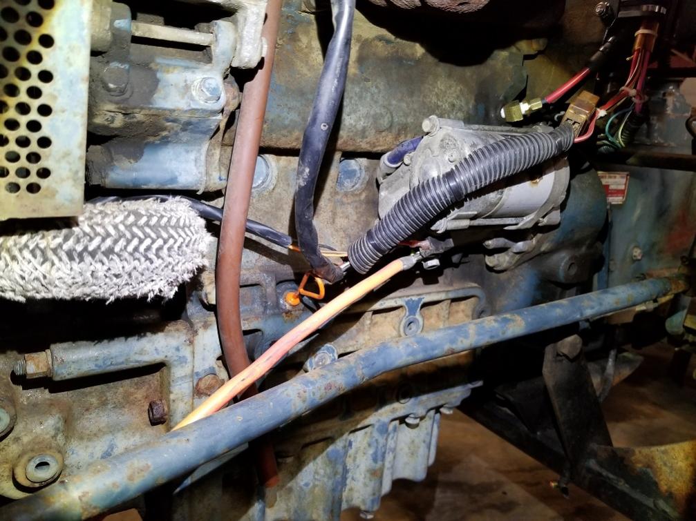

Sometimes you can just trip over a solution ... or in my case kick it across the shop floor. It was just a fluke that I noticed a small little something scurry away from my boot. It looked like a .22 shell but half as long and solid aluminum. I checked the fit and it HAD to come from that hole, 'cause it fit perfectly. I cleaned the plug and hole of oil, added some loctite and tapped it back in for a snug fit.
I did this early in the morning before leaving out of town and didn't have time to put the alternator back in place and fire it up. I'm gone for another day and the suspense is killing me.
So the question remains ... what is it, and why did it come out. Freeze plug ? Leaking hydraulic pump seal filling the crank case with hydraulic fluid? ( as earlier suggested)
I worked the tractor pretty hard the day before this plug came out ... so I have to wonder if I did some internal damage? Time will tell and I will post my findings. I've included more photos. Thanks guys.
