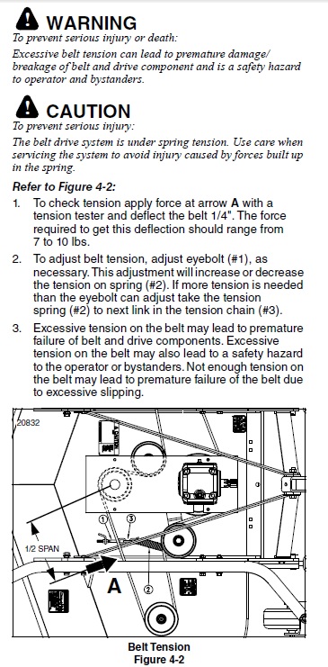

If I understand what you have done, you have decided to re-engineer a design from a reputable manufacturer.
Your mower may not have been set up correctly when you bought it..... s..t happens. However, did you adjust the belt tension according to page 27 of the Operator's manual before making the spring change?. see below:

Yes, I checked the tension per the method in the manual and it was WAY too tight.
The spring that came with was tensioned such that it was extended about 1/16" at most.
The new spring is extended about 1/2" and the tension is just under 10Lbs for roughly 1/4" deflection.
Belts need only be tight enough to prevent slippage. More than that and they put undue stress on spindle bearings.
