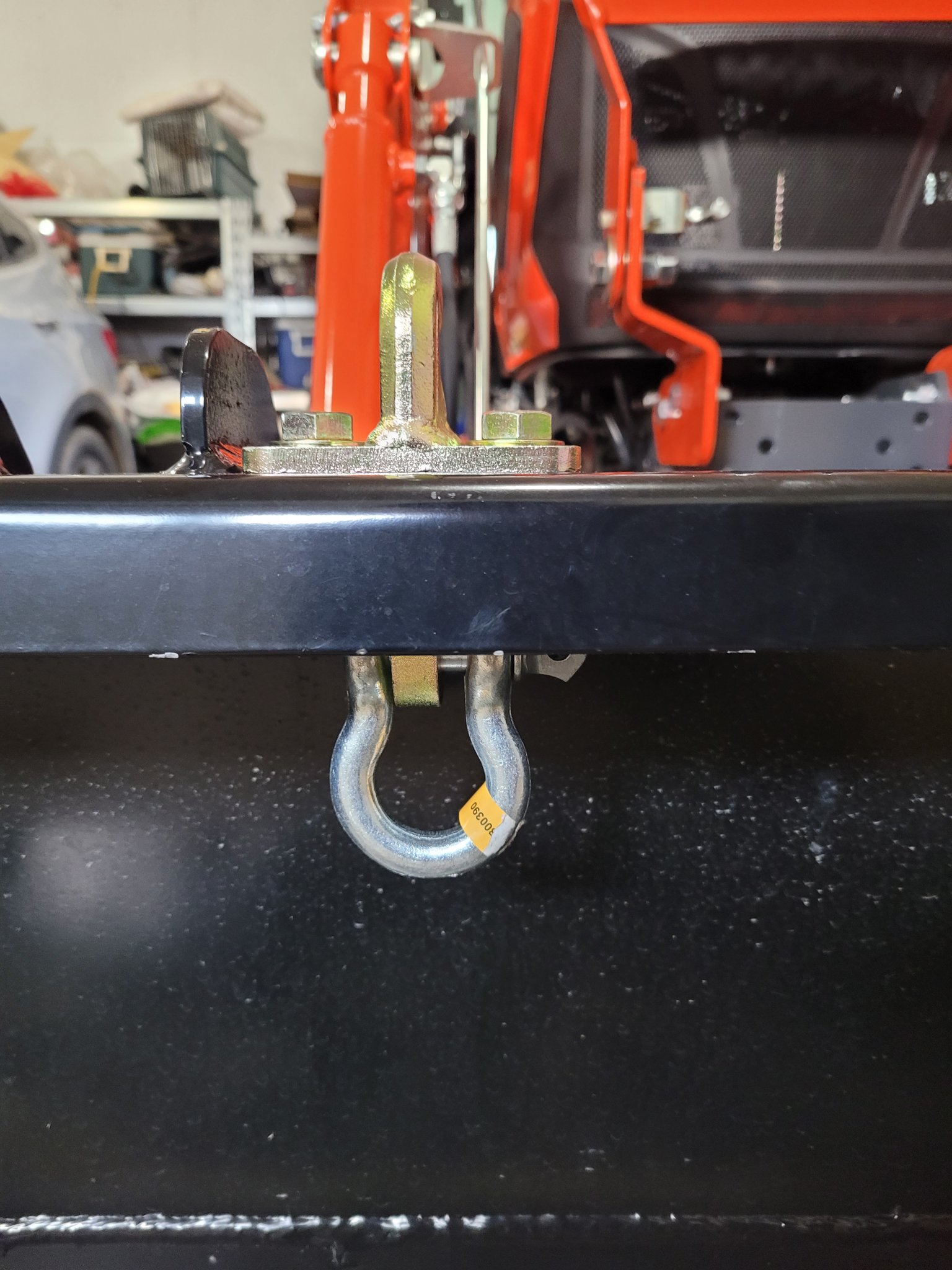

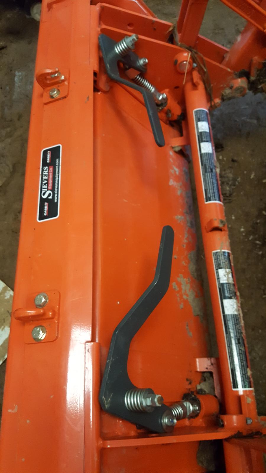

I hsve a HLA 60" bucket and am going to add Hooks and clevis mounts. There are two supports in line with the cylinders so the Hooks need to go to the outside edge of the SSQA bracket or to the inside.
I'm leaning towards the inside but would like to hear what you guys/gals think.

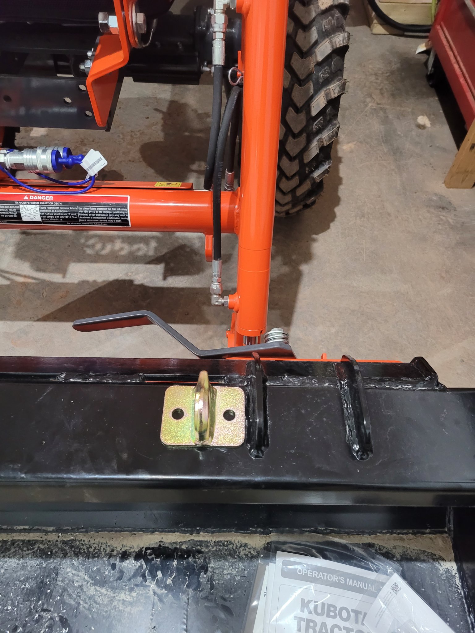

I’d suggest to Leave yourself enough room to get your chain on / off the hooks (and if using shackles enough room to put pin in / out)….beyond that your guess as good as mine…personally I think I’d try to get them in line with the loader arms.

Another reason why I'm leaning towards the inside. The outside edge is on the outside of the arms. The inside isn't dead on either but catches a piece of them.

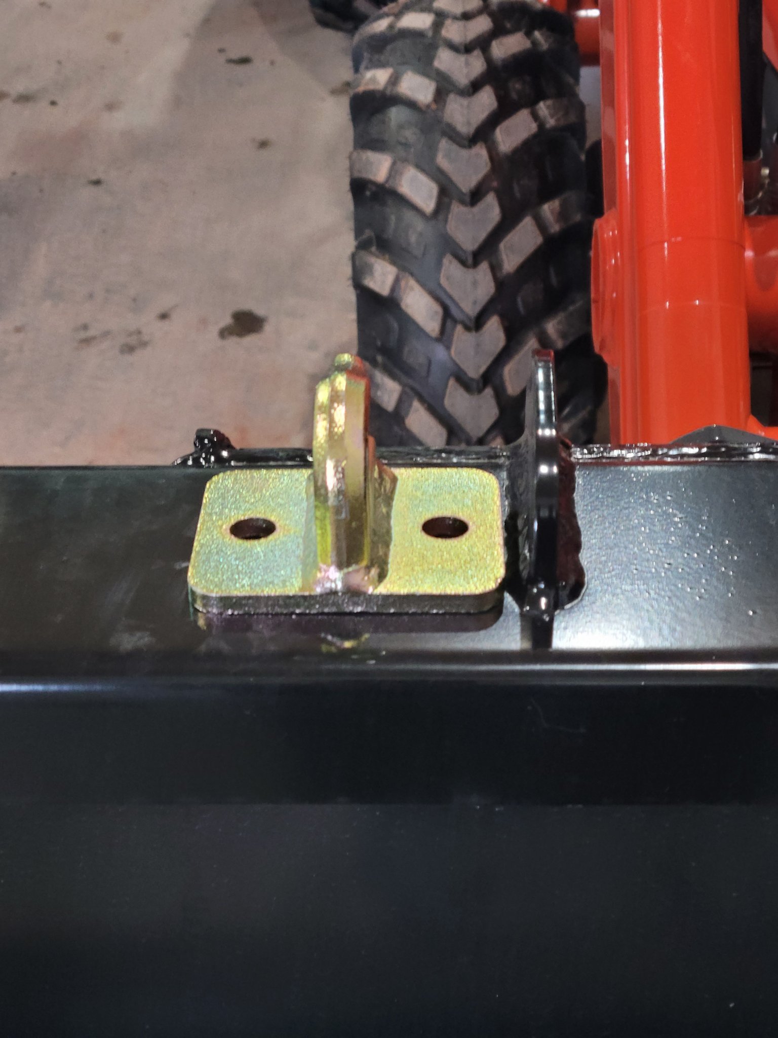

Mine are mounted towards the inside and work great

Inside is always my choice, lowers the tipping / twisting potential.

I went on the inside

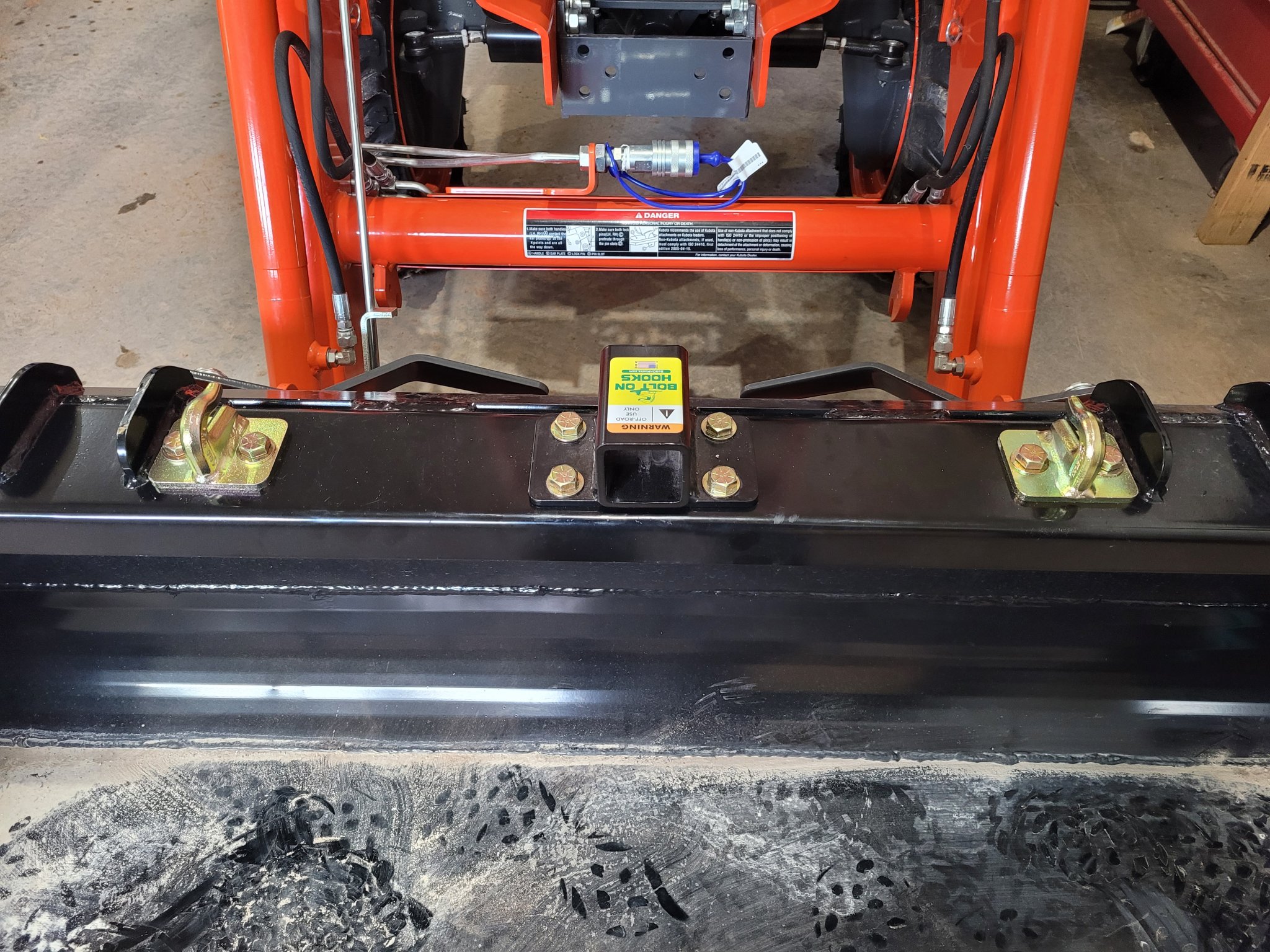

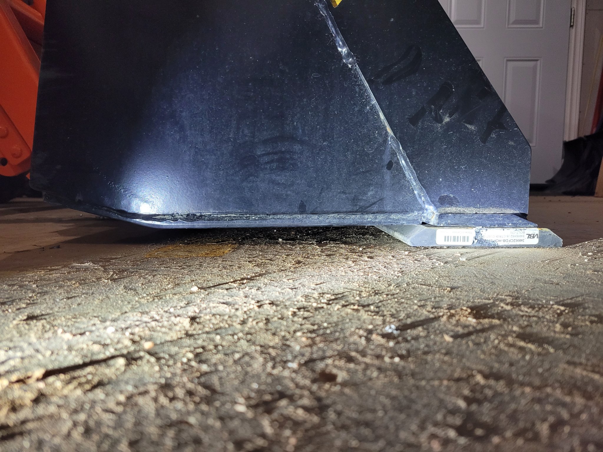

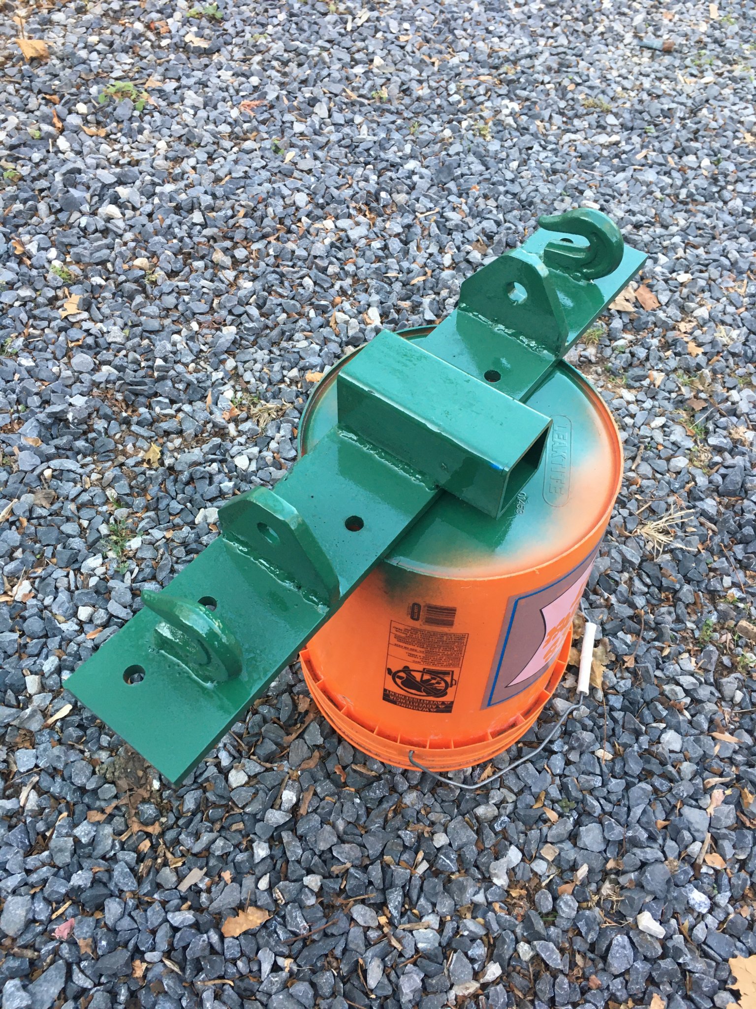

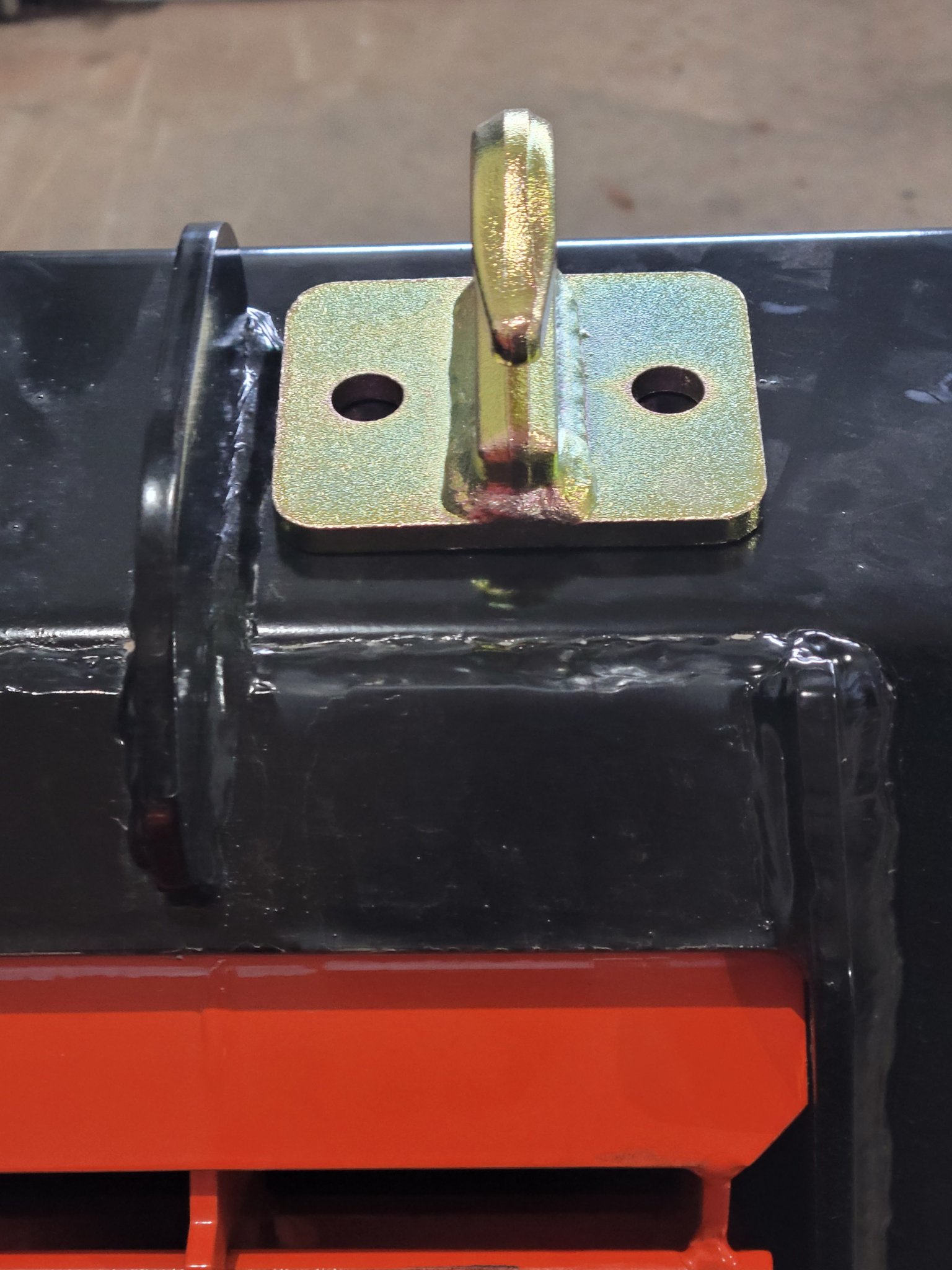

Hooks/clevis brackets and receiver tube are done.
Got a good 3/4" cutting edge on the bucket that keeps the bottom of it off the ground.

Bought clevis end hooks from harber fright & cut off the clevis ends / welded to 1/4" X 4" flat stock / the reese hitch got from tractor supply its just a tube with a hole in it / pad eyes are 1/2" with 3/4" holes for 3/4" shackles
