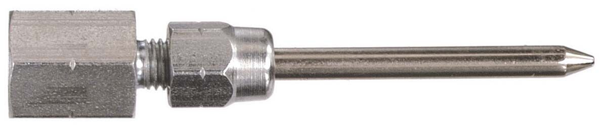

I simply drilled a small hole and use a needle type grease gun tip.
I put a hose clamp over the hole to keep the dirt out and slide it aside for greasing.

I drilled a small hole in the center of the tube that the pedal shaft goes thru so I can grease it with a needle point on the grease gun. I added a hose clamp to cover the drilled hole to keep dirt out. The hose clamp is moved aside to add grease.
