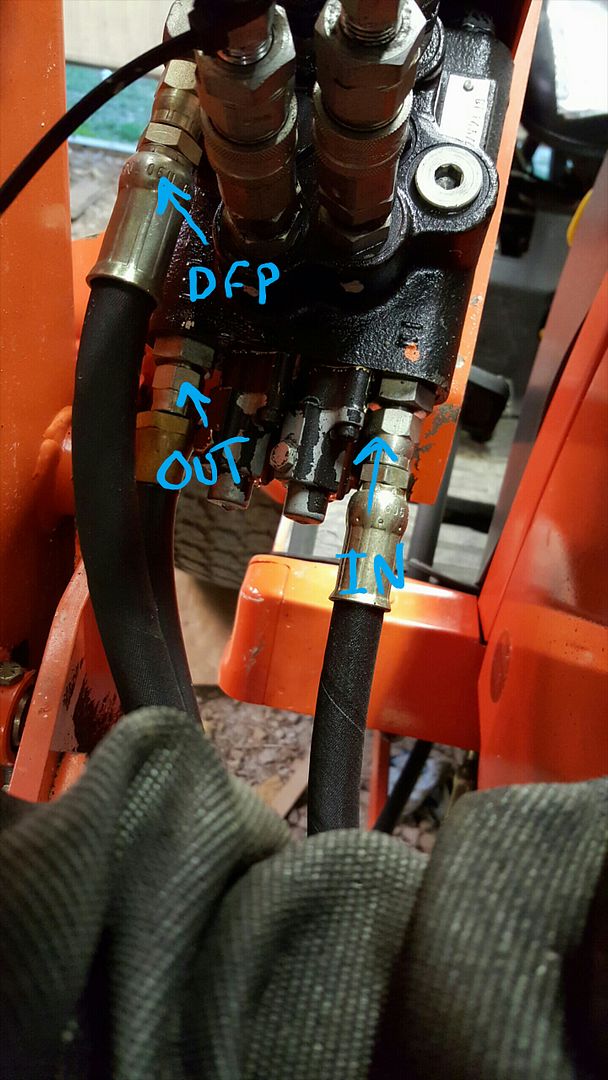

1. The tractor has a Kubota loader installed. Seems to work well, but shouldn't I be able to lift the front wheels off the ground with the loader? It does have some down pressure, but doesn't have enough to lift the front.
2. Possibly related to 1?....the 3 pt arms will lower with the lever, but when you raise the lever back up, the lift arms won't raise until you run the hydraulics on the loader. Is this normal? I've read that maybe it could need the 3 pt speed knob adjusted below the seat. I tried that but that knob won't budge at all. Is there a trick to it?....should I just be able to spin that knob or do I need to somehow unlock it from its current position?

1 and 2 are probably related, someone has the loader piped wrong!
Most likely they have Power beyond and return/tank reversed.

Piped wrong.....as in maybe I just need to swap 2 of the hyd quick connect couplers around where they connect to the loader hyd valve?

Piped wrong as in they have the power outputs back to the tractor from the loader valve mixed up, not the loader valve outputs to the loader rams.

Ok.....here is what I have. The first photo is of the hydraulic valve for the loader. There is an IN port, and OUT port and one that appears to be labeled DFP (?). As you can see from the 2nd photo, the IN hose from the valve is hooked to the front port on this block near the rear of the engine. The DFP hose from the valve is hooked to the rear port of this same block. The third photo shows the OUT hose from the valve goes to the hydraulic pump/transmission (?) Just in front of the rear axle housing. Can anyone confirm if this is correct or if it is wrong? Any help would be greatly appreciated!
